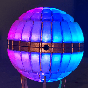

Introduction: LED Sphere (Desktop-Sized)
I have seen a few LED sphere's across the internet, but most of them are either pretty big, or require some complex (and expensive) arrangement of flexible PCBs. I thought I'd have a go at making a sphere using commonly available WS2812B (aka "Neopixel") addressable LED rings, thinking that the rings would make the design easier to reproduce, and also fairly compact. I am pretty happy with the end result, with the sphere being small enough to fit comfortably on a shelf or desk (while still packing enough LEDs for some fun effects), and being fairly straight forward to assemble (but still a little trickier than I'd like). In this instructable, I'll show you how to built your own.
I designed the sphere using Autodesk's Fusion 360 CAD software. The sphere is about 98mm (3.6") in diameter (about the size of a large onion), and contains 120 LEDs. It is powered by an internal LiPo battery, but can also be run externally via a 5V USB connection. An ESP8266 Wemos D1 Mini serves as the brains of the sphere. The sphere also includes an IR receiver, allowing for remote control.
The body of the sphere is entirely 3D printed, using transparent filament for the light emitting portions. I've also included a stand and hanging hook for display.

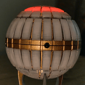

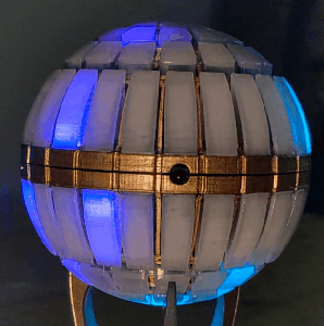

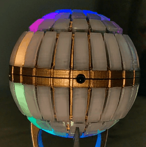

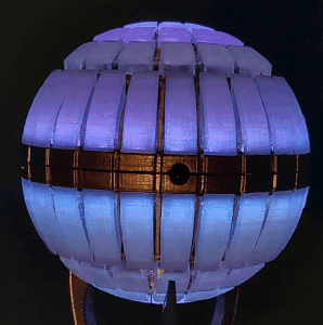

All the sphere's lighting effects were created using my Pixel Spork Arduino Library. Checkout the video above to see the sphere in action!
For reference, you can find all the project's files, code, etc at its Github Repo.
Please note that while most of the build is straight forward, it does require some tricky soldering and gluing in tight spaces. Before starting the project, you should read through the whole Instructable so you can plan your approach.
If you've not worked with WS2812 LEDs before you may want to familiarize yourself using the Adafruit Neopixel Uber Guide, just to get an overview of how they work.
Finally, please know that while the sphere is tough enough to withstand normal wear and tear, it is not intended to be thrown, dropped, submerged, etc. It is for display only!
As a final word before diving in, if you have any questions at any point, please leave a comment and I'll be happy to help!

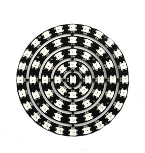

- Two sets of 61 LED WS2812B rings: link. You'll usually find these as a set of 93, with one of each of 32, 24, 16, 12, 8, and 1 pixel rings, we only need the 24, 16, 12, and 8 rings. Also note that there are multiple variants of these rings floating around, all with slightly different diameters, you want the set where the 24 pixel ring has ~92mm diameter, others won't fit the sphere. Another sign of the correct rings is that they have the LED capacitors on the inner edge of the rings.

You should also gather the electronic components, and separate the LED rings using wire clippers, sanding their edges smooth at the same time.
