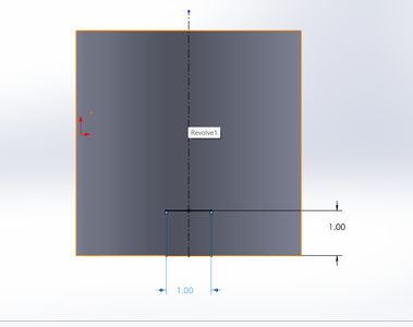

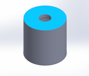

Step 4: Creating the Projector Base
Open a new part file in Solidworks. Start by creating a new sketch on the front plane to create a profile that will be revolved along an axis (the centerline) to give us the final shape. the profile looks somewhat like an upside-down L. create the shape and dimension it like the image above.
NOTE: the 5cm measurement from step 2 will be our overall width/radius. Once the profile is dimensioned, revolve along the centerline to create a cylindrical shape

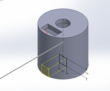

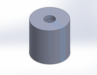

Step 5: Adding Ports to the Projector Base
The first hole that we will add to the base will be a square hole that will allow us to pass the power cable through. Create a new drawing on the top surface of the base and add a center line that bisects the circular face. Create a central square that is 1 cm wide by 2 cm long to allow the thickest part of the cable to pass through. Make sure that the entirety of the square is within the bounds of the base. Create an extruded cut through all of the base to finish the top hole.
Now create the backport that allows the cable to exit the base and allow for the projector to sit flush against a flat surface. Start back creating a new sketch on the front plane. Create a 1 cm by 1cm square and cut "through all" in the same direction as the top hole. Save as an STL file and 3D print it (color does not matter but a lighter color will allow for the base to light up.

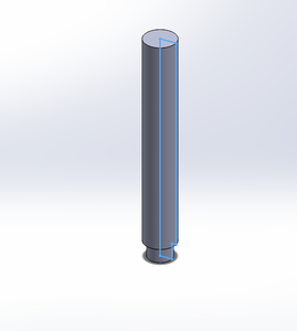

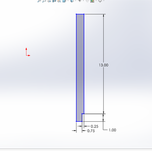

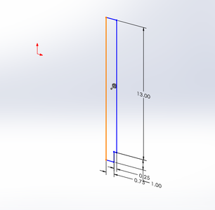

Step 6: Creating the LED Light Rod
Create a new SOLIDWORKS part. Start by creating a new sketch on the front plane and create a shape like the one above and dimension it in a similar fashion. The 13 cm length comes from the can being 16 cm long, by reducing this length we allow the can to partially slide onto the base for a cleaner look. Revolve along the longest line (orange line in the second image above) to create the final rod shape. Save as an STL file and 3D print.
