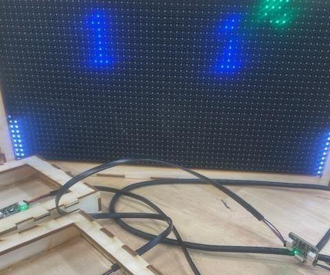

I decided to build a stock ticker due to my strong interest in the stock market and a will to have cooler desk trinkets than my friends. I learned how to code alongside my early interest in the equities markets as I started making simple predictive algorithms in my first years of coding. Lately, I've been branching out into other forms of coding like machine learning for image recognition, and circuitpython through school. Therefore, this project was a way for me to get back to my roots a little bit and combine my new skills with my old ones. However, I will warn all who attempt this build that the MatrixPortal M4 is a deceptively tricky board to work with. It claims to have wifi capabilities, but there is very little documentation on how to use it. Many imported libraries simply don't work on it, and I had to buy three of them over the course of two weeks because the code.py files kept getting corrupted. I am, strangely, glad that I overcame these challenges because I learned a TON in the process of working around its faults.
You'll notice that there is a Raspberry Pi Pico W in this build. Through my tribulations, I figured out that instead of using the MatrixPortal for wifi and connecting to Adafruit IO, I could use the Pico, which has far more documentation and I have experience with it in class. To connect them, I used the UART protocol so that the MatrixPortal could interact with the Pico and display the tickers on the screen.

Step 1: Set Up Boards
Both the MatrixPortal and the Pico will be run on CircuitPython accessed through the .uf2 file on the CircuitPython website, ensuring to use the 9.x.x file. I also used Circup to install libraries earlier, but in either case, make sure that you have the Adafruit-Circuitpython-Bundle downloaded. Next, to make things easier, I used jumper wires for the wiring:
  1. Pico RX -> M4 TX
  2. Pico TX -> M4 RX
  3. Pico GND -> M4 GND
You can solder the connections if you'd like but because I am reusing the M4 for a different project, I just curled the jumper wires around the connection points on the M4.
Next, you want to connect the M4 to the LED matrix, which plugs in to the VCC GND connections on the back, and the M4 gets pushed into the HUB75-D port. Next connect the VCC wire to the 5V on the M4 and GND goes to GND; they need to be screwed on with the screws that came with the M4.

Step 4: Cut and Final Assembly
My box cutout is attached. I made it on MakerCase and threw it into Adobe Illustrator to at the hole at the side. The hole is there because the MatrixPortal sticks out of the side a bit. I made the hole pretty large to make it easier to unplug. I used hot glue to seal it, and I used some tape to make sure the LED screen was secure.
