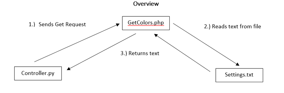

Next we will write a script in python to check the contents of text file on the Pi. This script we will call controller.py. The text file will be called settings.txt. The controller.py script will run a loop to constantly check the contents of the settings.txt file. Based on the contents of the settings.txt file the controller.py script will change the Raspberry Pi’s GPIO pins(17, 24, 27) to either be on or off from our pigpio library installed on the Pi. And by doing this the LED will change as you saw as you did before from the pigs p command.
The settings.txt file will have 5 numbers, the first 3 will determine the brightness of the lights, anything from 0 to 255. The forth number will be 0 or 1 to indicate whether or not the fade effect will be active, in order to fade between different colors (0 for off, 1 for on). The last number will indicate the color 0-9, and the controller.py script will change the GPIO pins to show a certain color from the LED strip based off the number you assign it.
The controller.py script is running a loop to constantly check the values of the settings.txt file. It gets the 5 numbers from the file and parses them to read the information correctly. It then uses the pigpio library to run the pigs p command based on the numbers from the file in order to change the LED colors.
One last thing in order for the controller.py script to get the contents of the settings.txt file it must send a request to a php file. We will call this getColors.php and this file will simply grab the contents of settings.txt for us.

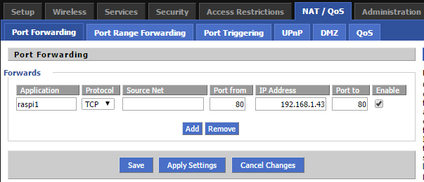

Step 10: Configuring Your Pi So That the Echo Can Communicate With It
Alright so all seems fine but we need to do one last thing. Since your Amazon Echo’s code is hosted in the cloud it won’t be able to access index.php on your web server if you haven’t set up port forwarding. We do this in you router however for every router it’s different and hopefully you don’t have to go through multiple routers because that may complicate things. Anyways go to your main routers home page from your browser, most likely 192.168.1.1 or 192.168.200. And in their search for a port forwarding tab and configure it like so.
Make sure to change the IP address to the static IP you gave your Pi. Also hopefully your ISP doesn’t block port 80 but if it does not big deal. You will just have to change the port nginx is hosting on and change the port corresponding above. Google should help you find that out.
Alright so now you can test your skill from the Amazon Developer Service under the test tab. If it all works out, you should be able to run any of the sample utterances I provided above by invoking the skill! In the skill information tab in the amazon developer service I named the invocation name “lights”. So all I have to say is “Alexa, ask lights to turn on.” Or “Alexa, ask lights to change to cyan”. Pretty cool right!?
