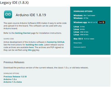

Step 1: Install and Configure Arduino IDE *Optional
In the case you've never used Arduino IDE you will need to download and install it.
Download here - https://www.arduino.cc/en/software

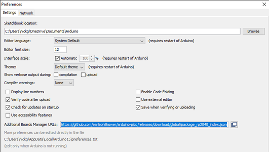

  • After Installing, navigate to File > Preferences

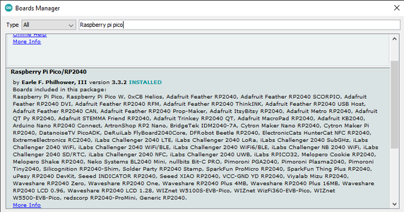

  • Find Additional Boards Manager URLs, and paste this link into a text field - https://github.com/earlephilhower/arduino-pico/releases/download/global/package_rp2040_index.json
  • Then, navigate to Tools > Board: > Boards Manager
  • Type the "Raspberry Pi Pico" in a search field, find and Install.

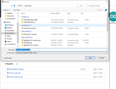

Step 2: Install Arduino-Pico-Littlefs-Plugin
The primary purpose of the arduino-pico-littlefs-plugin is to let you upload the files into the RPI's flash memory. In this tutorial, the purpose of this tool is to format the RPI's flash.
Download the file called PicoLittleFS-0.2.0.zip from https://github.com/earlephilhower/arduino-pico-littlefs-plugin/releases/tag/0.2.0
And then extract the content of the archive into the "...\Arduino\Tools\" folder.
After that, restart the Arduino IDE.

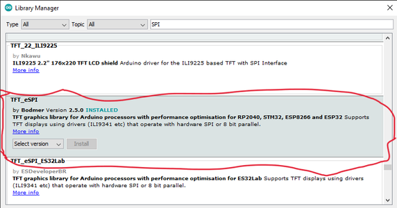

Step 3: Install Libraries
You'll need to install libraries to be able to interact with sensors, displays, etc
  • Navigate to Sketch > Include library > Manage Libraries
  • Type every single library one by one and download:

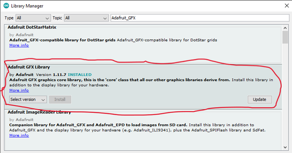

  1. Adafruit_ST7735
  2. Adafruit_GFX

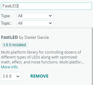

  3. FastLED
  4. SPI

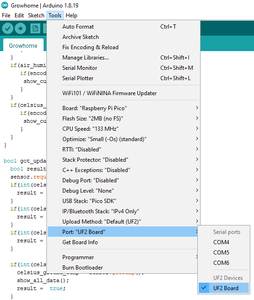

  • Navigate to Tools > Board: > Raspberry Pi RP2040 Boards > Raspberry Pi Pico;
  • Hold BOOT button on Raspberry Pi Pico board and plug it to the computer;
(After that, you'll be able to upload the firmware)
  • Navigate to Tools > Port > UF2 Board;

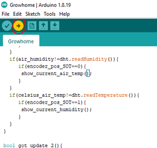

  • Click upload button in the left top corner;
