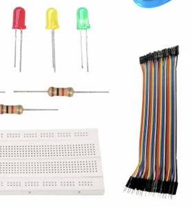

Step 4: LED Lights
For the LED lights I soldered a switch to a wire, the switch to a different wire, the wire to the LED light, and another wire to the LED light (three wires, one switch, one LED light). I then taped the two free hanging wires to a battery with electrical tape to make sure the positive side of the battery is connected to the longer prong of the LED light and the negative side of the battery is connected to the shorter prong of the light. Lastly, I wrapped the battery and wiring in black electrical tape to make it more compact and cleaner.
