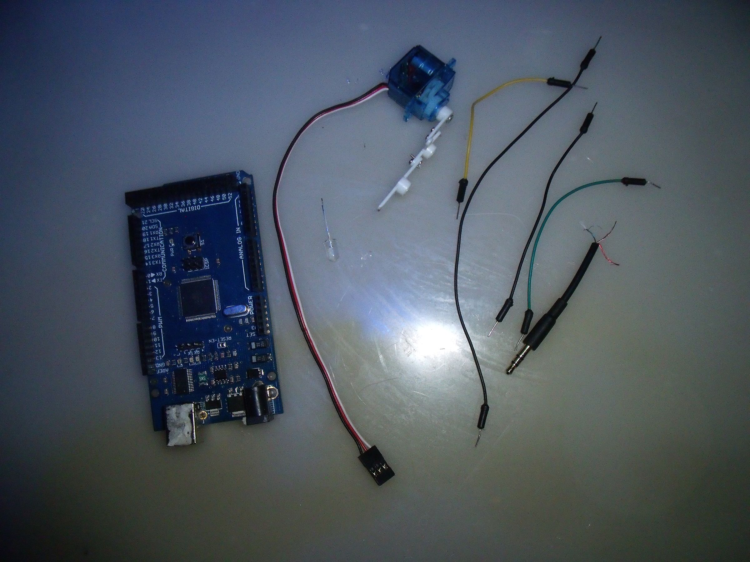

Hi, Everybody.
What makes this project that cool is the fact, that its sensing music, unlike traditional
VU-Meter`s or Equalizer wich indicates the Level of Incoming Sound by Switching LED`s On,
My LED Tower, looks like it knows when the break or drop or what ever in the song is comnming.
The Bigger Lights i build in, only gets on when the music getting more intensiv.
with Serial Monitor i Managed to Write a Windows App, that Controls Ardurino, Needet to use the
hole Tower as Main Light for my Living room.

How it Works ?
If u ever made music yourself you, know about the lengths of standart music pattern, and
thats the key to this, by counting up variables and compering them.(like 16,32,64,128,256,512 etc...)
Step 1 :
- Drill Holes in your Styropor or plexiglass body.
- Place your LEDS Like You Want.
Step 2 :
- Wire your LEDs with resistors and connect them to any free pin on your ardurino!.
- connect a couple of LEDS with pwm pins
- Test your LEDs with the Basic "Blink-Sketch"
Step 3 :
- connect a analog pin with the audio jack and your Audio source
- Test IT with the Basic "AnalogRead-Sketch"
Step 4 :
open ardurino software to programm it.
upload this code and edit the Arrays with your pins, and the count of pins to the var.
