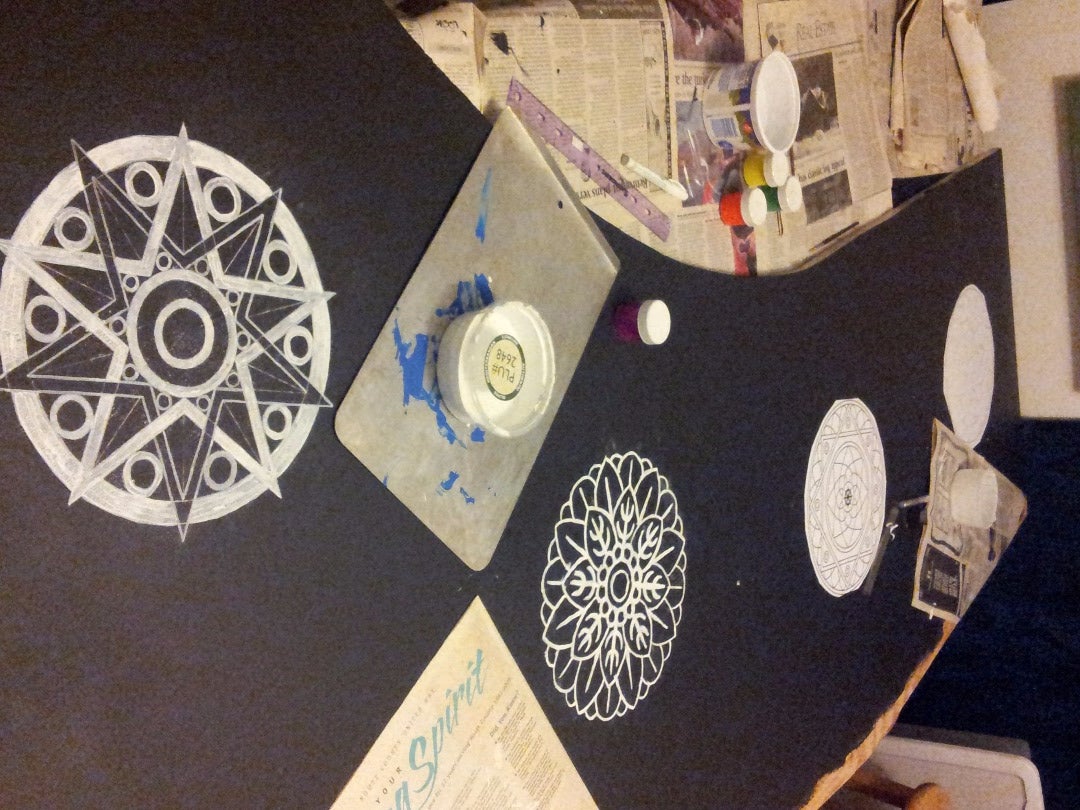

First paint the surface black.I purchased 11 x 17 sticker paper to print off my patterns. Sticking them equal distance from the armrest and edge is preferred. . Each one is cut with a razor blade or xacto knife. Primer, then 7 coats of UV paint. Touch up may be required after pulling up the sticker paper. When peeling the paper, be careful not to stab the surface to reduce touch up.

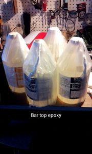

Make sure the surfaces are level and in a dust free room. Don't plan on walking through the room for the next 12 hours so you don't kick up dust. Also bugs can be an issue. Hindsight I wish I could have set them in a protective enclosure.
Follow the directions on your bar top epoxy. Be very careful not to add any air bubbles to the mixture. I used a drill gun and mixing attachment. Mix and pour, a heat gun is very important to remove any air bubbles in as you pour and even the surface.
You will want at least 2 coats of epoxy. Each time it is very important not to mix in air to the mixture!
