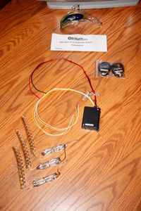

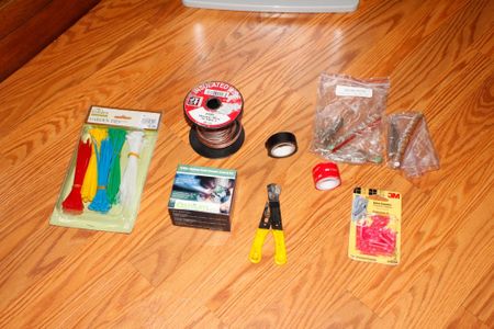

Step 1: Gather Your Supplies Needed
Gather the supplies needed.
Base Supplies Needed:
- Electrical Tape
- Wire Strippers / Cutters
- 12V Remote LED Dimmer & Strobe Unit from Oznium
- Flexible LED Strips from Oznium.com

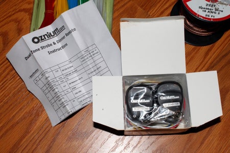

Step 2: Important - Check for Genuine Oznium 12V Wireless LED Remote
Before we continue, for the safety and longevity of your project, please check the 12V Wireless LED Dimmer Remote Unit you've purchased is a true, geniune Oznium LED Wireless Strobe and Dimmer Remote using the steps below.
(Hover over the images to check for genuine clues that we've had to include with our shipments to properlydifferentiate ourselves from the cheap, shoddy knock-offs of our innovative remote that competitors sell... often at higher prices, oddly enough!)

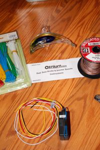

Step 3: Unpackage Your 12V LED Dimmer & Strobe Remote
After verifying you have a genuine Oznium Wireless Remote & Strobe Remote - Unpackage it, being careful not to dislodge / remove the stickers from the wire bundle in the process.
To make the install process easier, fold the antenna wire (blue) into itself and attach it to the side of the unit, so it does not get in the way of your main wiring bundle.

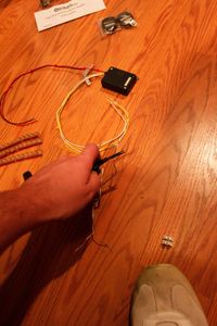

Step 5: Strip All the Wires Properly
Prepare all of the wires using your preferred method of stripping wires.
Cut around 1/4-1/2 of an inch off the end to expose the wires on all sets. (Red and Black Set, only White and Yellow Set needed for this tutorial, as well as the ends of all LED strips - 3 total in this tutorial.)

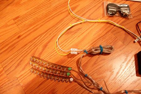

Step 6: Project Ready - Wire It Up!
The entire setup is now ready to wire.
The 2nd set of unused output wires are taped off, the 1st set is stripped and ready to attach to the ends of the bundled LED strips.
We'll be attaching the LED strip bundled wires to the 1st set of output wires (yellow and white) with euro-style terminals.
Make sure to first attach the Red and Black wires to a proper 12V power source (make sure to connect the ground and power wires to the proper terminals.
Past that, twist and attach the wire bundle ends from the LED strips to the Yellow and White bundles. Hit number 1 to make sure that you've setup the wires properly (the LED strips have polarity protection) , then either solder them to be permanently setup, use euro-style terminals to secure them, or use the brand new Oznium LED Quick Wire Connectors if you don't want to use a soldering gun, the quick wire connectors are a great way to save time for a secure connection.

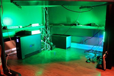

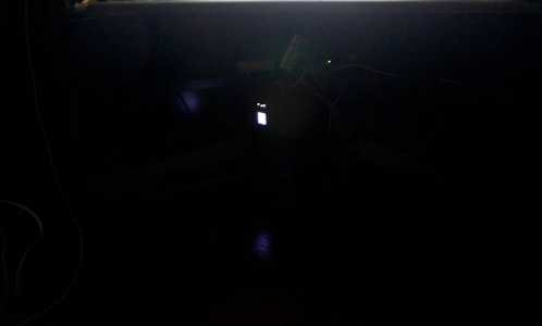

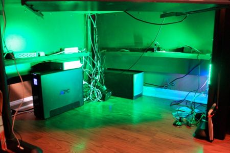

Step 7: Finished! Before and After - Day and Night...
Now that the 12V LEDs are wired up , and your remote unit is working, mount it to your under-cabinet, under-desk or any other area you desire to have truly Wireless 12V LED DC Lighting!
