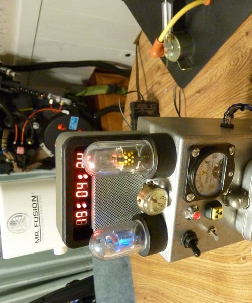

Introduction: LED "Vacuum" Tubes
Vacuum tubes are cool to look at and hot to touch. A nice addition to a steampunk or lighting project, but require a lot of power and break easily.
This project provides a close facsimile that is low voltage, no heat, and more durable. Plus they look cool.

Ok, so I’ve gotten a couple of comments about destroying old vacuum tubes and that they may not be easily obtainable. When I was a kid you could pick up a whole box full for a couple of bucks, but now I realize that they may be needed for antique radio enthusiasts. So, I came up with a fast and easy way to make some tube innards. I would search the internet for pictures and get creative to add on to my design. This is a fast easy basis to build on.
Let’s get started:
Parts Used:
First I looked around for parts that look like what’s in a vacuum tube. I came up with some buss wire (a paper clip would work), some window screening (a finer mesh might look better), 3/8” internal lock washers, and some ½” plexiglass tubing (eBay).
Step 10:
Step 11:
Center the lock washer on one end of the tubing then, using a soldering iron, melt the washer into the end of the tube.
Cut the screen into a ½” wide strip and, using a soldering iron, melt one end into the tube.
Pull the screen around the tube twice, bent the wires down and melted that end in, as well.
Step 12:
Melt some wire into the end and trim, making 3 or 4 wires to keep up off the base.
Cut the tube at the screen line and melt another washer into the other end.
With pliers, bend a piece of wire, as shown, and melt it into the top.
Step 13:
BOOM, there you are. Not perfect, but with some pieces of shiny metal or other small parts glued on you can make this look very real.
