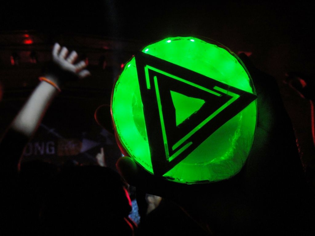

      Woofers:
      The woofers are basically to display the beats in music. The have 4 levels of LED strips stuck in concentric circles, with wooden planks for support, a plywood base and Plastic casing, later covered by a black chart paper and butter paper for diffusion.
      To make the structure:
      1. The inside most layer is a themocol cylinder with Red LED strips stuck to the bottom in the shape of a circle. Another layer is stuck on top of the cylinder.
      2. The intermediate layer of blue LED is stuck on wooden columns mounting a plastic circle made using the electrical casing.
      3. The outer layer is a bigger version of the intermediate layer, but with green LEDs.
      4. The leads are taken out of the holes drilled plywood base. All positives are again shorted and negatives are connected to four pin connectors.
      5. The sides are covered by chart paper and the top face is covered with butter paper.
