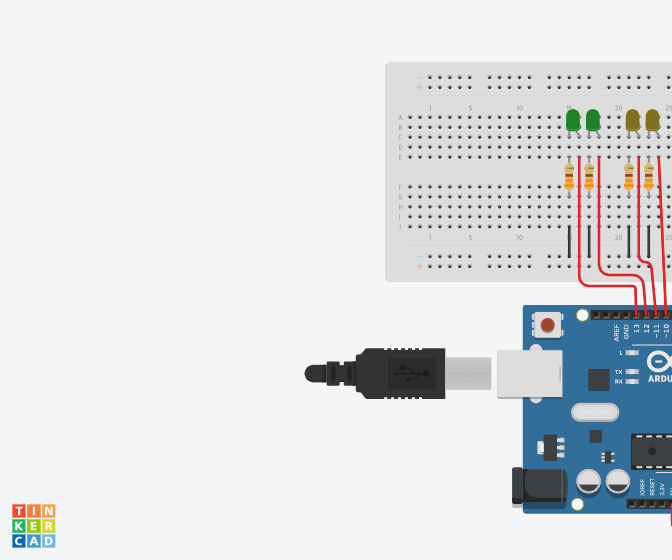

Step 2: Follow the Schematic
Everything should match the real picture of the project except for the joystick. My joystick has 5 pins, 4 of which I have used: named from top to bottom "Y", "X", "Bt", and "VCC", and "GND" is connected to GND and 5V on the Arduino, "X" and "Y" are connected to A0 and A1. You can also use the 5th pin of the joystick but you will have to add one more LED (one more mole) and also add the code for that.
