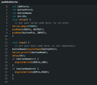

Step 4: Write the Program
You must have Arduino IDE installed: https://www.arduino.cc/en/software
Here is the code: https://github.com/tejbho/ArduinoProjects/blob/main/pushbutton/pushbutton.ino
You should modify the code so the LED pin is 8 and the button pin is 12.
