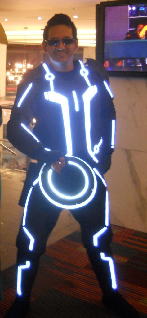

Introduction: LED-lit Tron V2.0 Suit
Costumes rule. Glowing costumes rule even more. To make the king of glowy costumes - you gotta look just one place...inside your computer :). By following this instructable, you'll have the knowledge and ability to make an LED lit garment that looks just like the ones in the new Tron flick.
My goals in making this costume were to make a robust, easily washable, waterproof, Tron style suit which was energy efficient to minimize battery weight and hardware bulk. To do that, I had to dodge the commonly used EL wire implementations and switch to LEDs.
Even if you aren't interested in making a Tron suit, I would highly recommend reading the section on lighting implementation - I did not individually stitch each LED with conductive thread...instead I used a combination of silicone coated LED strips and faux leather to produce a beautiful, diffuse light without seeing those pesky LED points.

Step 8: Picking Some LEDs for the Lighting!
Now that you've got a shirt that looks like a beautiful leather clad Tron dude, you're going to need to light it with LEDs.
Rather than conductivley stitch individual LEDs to the shirt, I decided to use flexible, waterproof LED strips to make my shirt. This takes away a lot of the stitching hassle, and also makes the shirt very easily repairable and upgradeable. If for whatever reason a section of LEDs fails, it can be removed and replaced with a low cost and time investment.
Now, when using LEDs, and trying to diffuse them enough so you can't see individual light points, the only thing you need to worry about is *space*! Anything you can do to increase the space between the LEDs and the cloth of the shirt, the better the diffusion you'll have, and the more you can light by using fewer LEDs (more power and heat efficient).
Therefore, diffusion becomes the next big reason to use flexible LED strips instead of individual LEDs since they will stand off from your body a bit. If you couple this with a super tight shirt, you'll create a "tent" where the LED light can shine (see pictures below). LED strips are thick enough to create a reasonably sized tent to look awesome. However, if you use too loose of a shirt, you won't get this tent effect, and your shirt won't glow!
So, what did I use in the end? I used White Silicone Encapsulated LED Strips from Oznium. I picked these for two reasons. First, they were much more flexible than any other LED strip I could find. Second, since silicone is clear, you can get a lot of side diffusion out of these LEDs (a picture of the strips are below).
I needed a total of 11 of them for my outfit.

Step 12: Add a Battery Connector, and a Sweet Battery
To size your battery, you need to know how many volts and amps your particular LED strips are using. If you are using mine, they are 12V strips that use 130mA per foot. I'm using ~11 feet of LEDs, which means that my whole setup uses 1430mA @ 12V.
Batteries capacities are usually listed in Ah (amp-hours) for a given voltage. Ah are just amperage requirements multiplied by time. In other words, to keep a 1.43A system lit for 1 hour, we'd need a battery capacity of 1.43Ah @ 12V.
For this setup, I'm using a LiPo battery which has a 6.2Ah life @ 12V. Its waterproof, shockproof, and fits snugly inside of a hip pocket. Using this battery, I can run my setup for about 4.5 hours continuously or so. If you want yours to run longer or are OK with a shorter life, scale your battery appropriately!
My battery uses a trail tech connector to discharge. You want to solder the red wire to the "+" side of your first LED strip, and the black wire to the "-" side of the LED strip.
Step 13: Power It Up!
If you've done everything properly, you should now have an amazing looking suit! Use your tron suit to do something epic, like fend off your living room from evil forces headed up by the Hawaiian breeze fan and folding chair behind you!!
Thanks for taking the time to read, if you loved it! Feedback and questions are welcome, ask away!
