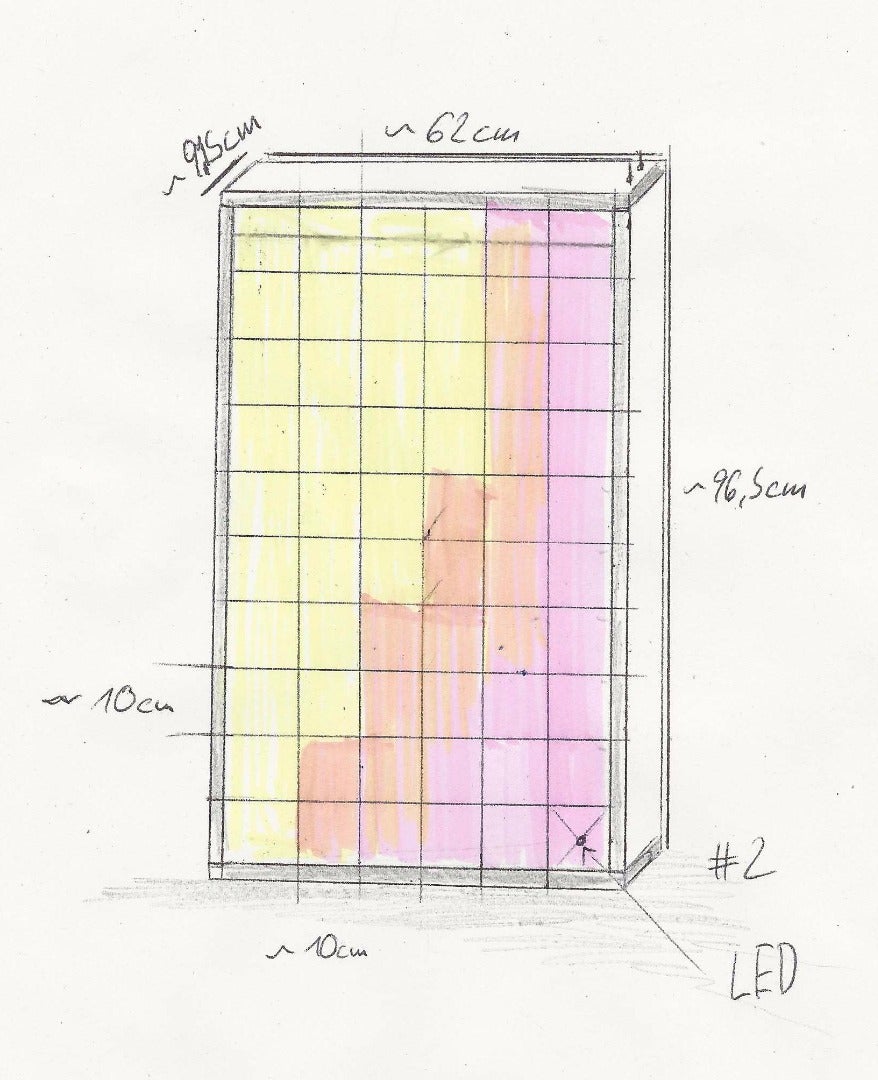

A unique piece of furniture without spending a whole lot of money?! That is what i wanted to achive in this project. Also i am not completely unfamiliar with programming and electronics and ,like most of us do, i think that LEDs are just awesome, which is why i started this project. So without further ado, lets get started, shall we?

  • 4x wooden planks
    1. 2x(~9,15cm x ~2,3cm x ~62cm)
    2. 2x(~9,15cm x ~2,3cm x ~96,5cm)
  • 1x wooden backplate(~59,5cm x~98,5cm x ~2mm)
  • 1x acrylic glass(~98,5cm x ~60cm x ~2mm 79% opaque)

The process of building the frame is pretty straight-forward, which is why i am just going to sum up the basic steps. Start of by cutting your wooden planks to the right size. Look at the pictures above for the measurements i used or come up with your own (which would probably be a good idea, given the fact that i built the project without a specific plan). Also cut slots into your 4 wooden planks using a bench-saw. Proceed by drilling holes into the 2 shorter pieces of wood. If your back-plate and your acrylic front-plate are not cut into the right size, you obviously also have to do that. My design (dimensions) is based on the back-plate, which i found in my dad's basement, which is why i could skip that part. Also my acrylic glass pane was delivered pre-cut, which came in handy. Try to slide the back-plate and your acrylic glass into the slots you previously cut into wooden planks that make up your frame BEFORE gluing all the frame related parts together just to make sure everything fits nice and snugly. Now, after removing the acrylic pane and the wooden back-plate, glue the bottom plank to the sides.(Leave out the top, you will want to glue it on later, after assembling and inserting the grid, which creates the actual "pixels"). Clamp all the pieces together while the glue is drying to achieve a solid structure. Also use screws just to make sure nothing falls apart later on.
The interior
I used cardboard to build a grid that fits right in between the back-plate and the front. the process of building the grid is rather easy, however time-consuming as well. i made several stripes of cardboard, which then snap-fitted nicely into each other.Look at this pictures to get a rough idea of what i did. Next, drill evenly distributed holes into the back-plate that hold your LED's tightly. I used a drill-bit with a diameter of 8mm to achieve a good fit. Now you can slide the back-plate and the acrylic glass into the U-shaped frame, slide in your cardboard-matrix and mount the top plank. Use glue and screws to create a solid construction.
