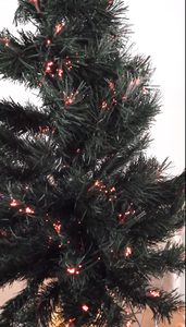

Step 5: Comparing the Width at the Base of the Tree to the Bulb Face
You can see here that the LED bulb-s reflector will align well with the base of the optic fibre bundle.
You can also see that some of the optic fibres will be roughly pointing towards the sensor input on the bulb face - so this means we will be able to remote control the tree by pointing the infrared remote unit at some of the tree's lower branches! How convenient :-)
The final step now is to re-assemble the tree base, put the tree together and plug it in!
For a video of what it looks like: see the youtube video...
