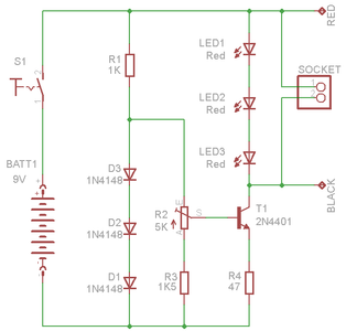

Parts required:
47 ohm resistor
100 ohm resistor
1 K ohm resistor
1.5 K ohm resistor
2N4401 or similar (2N3904, 2N2222) NPN transistor
Three 1N4148 diodes

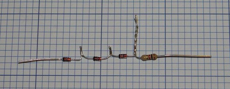

Solder three 1N4148 diodes an a 1K resistor together as shown.
Do not trim the leads at the junction of the 1K resistor.

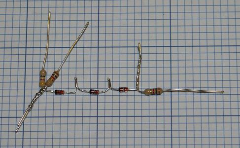

Solder a 47 ohm and 1.5 K ohm resistor to the diode as shown. Do not trim any of the leads.
Solder the 1.5 K ohm resistor to the left terminal of the 5 K pot.
Solder the junction of the 1 K ohm resistor and diode to the right terminal of the 5 K pot.

Solder the base lead of the transistor to the center terminal of the 5 K pot.
Solder the emitter lead of the transistor to the 47 ohm resistor.

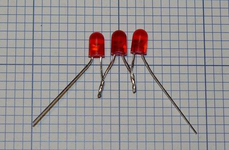

Solder together 3 red LEDs as shown. The anode of one connects to the cathode of the other.
Solder the negative (black) wire of the battery clip to the junction of the 47 ohm resistor, 1 K ohm resistor, and diode.
Make a temporary solder connection from the collector of the transistor to the cathode of the LEDs.
Make a temporary solder connection from the 1 K ohm resistor to the anode of the LEDs and the positive (red) battery clip wire.
Connect a 9 volt battery and rotate the 5 K pot from CCW to CW. The LEDs should go from off to maximum brightness.
Measure the voltage a the left and right terminals of the 5 K pot. Reading should be approximately 450 mV left, and 2.1 V right.
