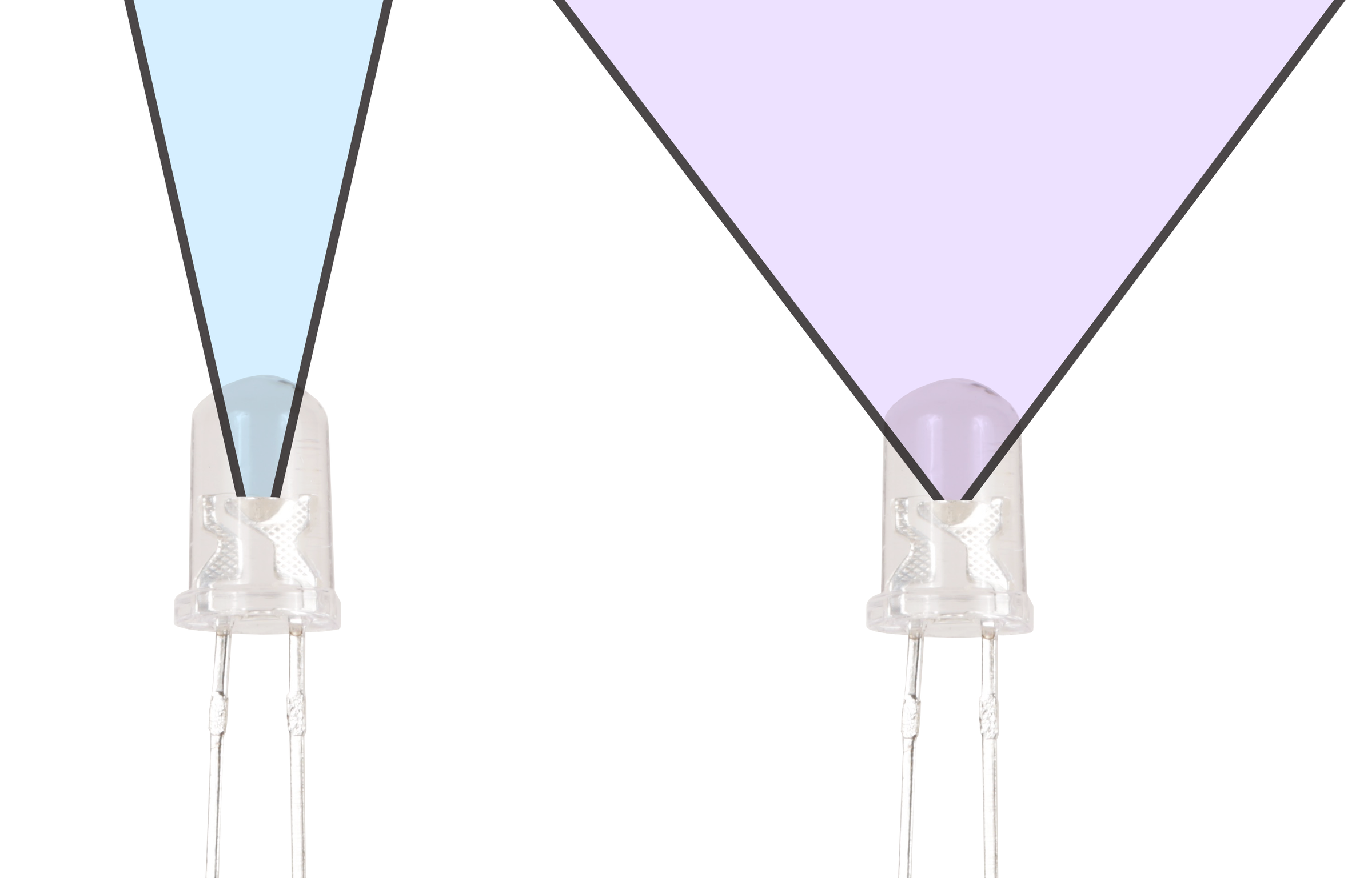

Also, light bulbs are omnidirectional in light production, whereas LEDs are designed to emit light in a beam at a certain angle

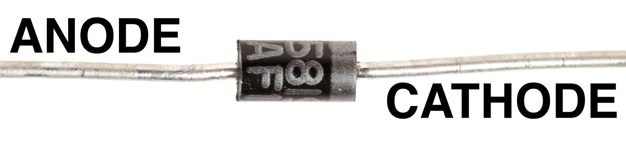

All diodes are polarized. This means they have an anode (positive side) and cathode (negative side). You can tell the difference because the cathode has a little line painted around it.
What this means is that electricity can only flow through in one direction. A positive voltage should be connected to the anode and the cathode should be connected to ground.

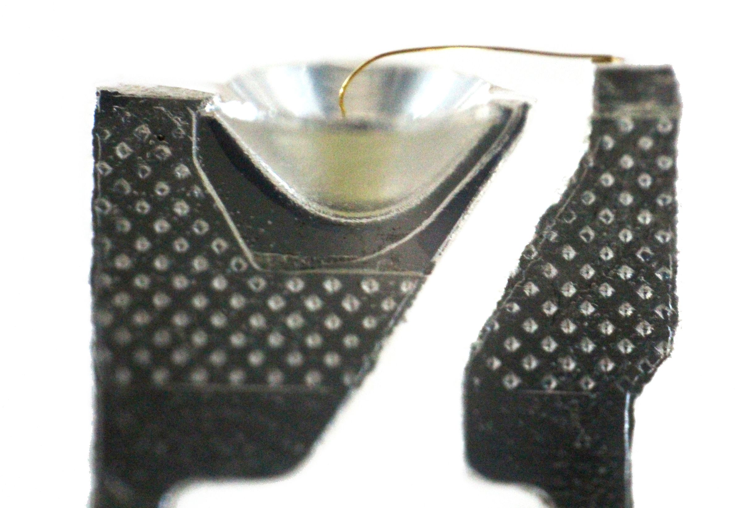

If you look very carefully inside of an LED, you will be able to see its anode and cathode. The thin wire bond attached to the anode bridges across to the center of a small reflective bowl attached to the cathode. In the center of the reflective bowl sits the semiconductor die. When current flows from the anode to the cathode, the semiconductor material emits photons, reflects off the bowl, and is further amplified by the resin material of the LED.

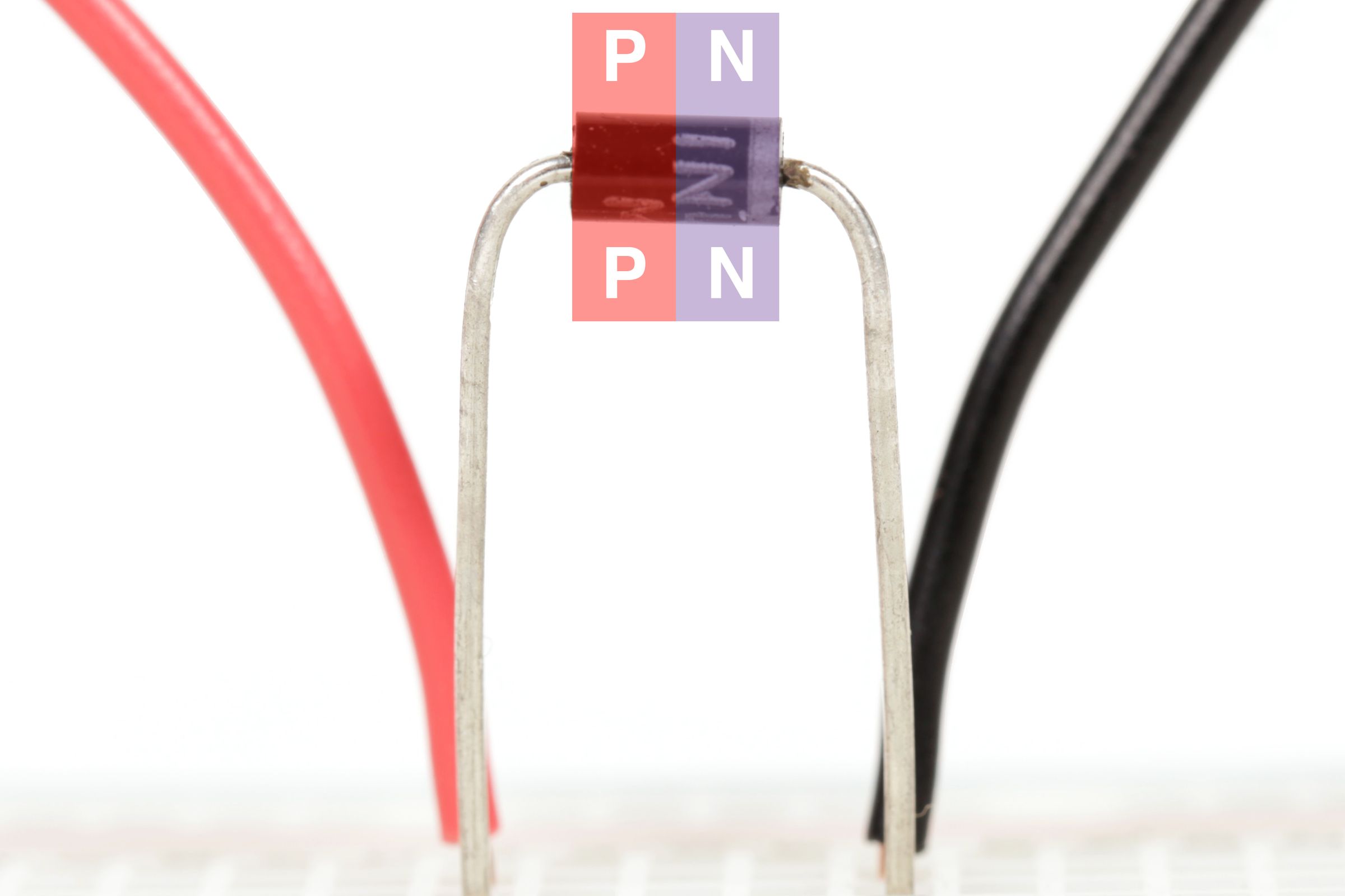

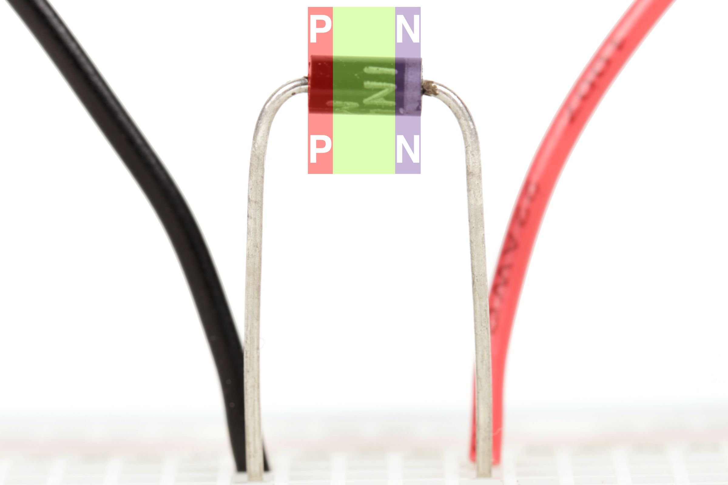

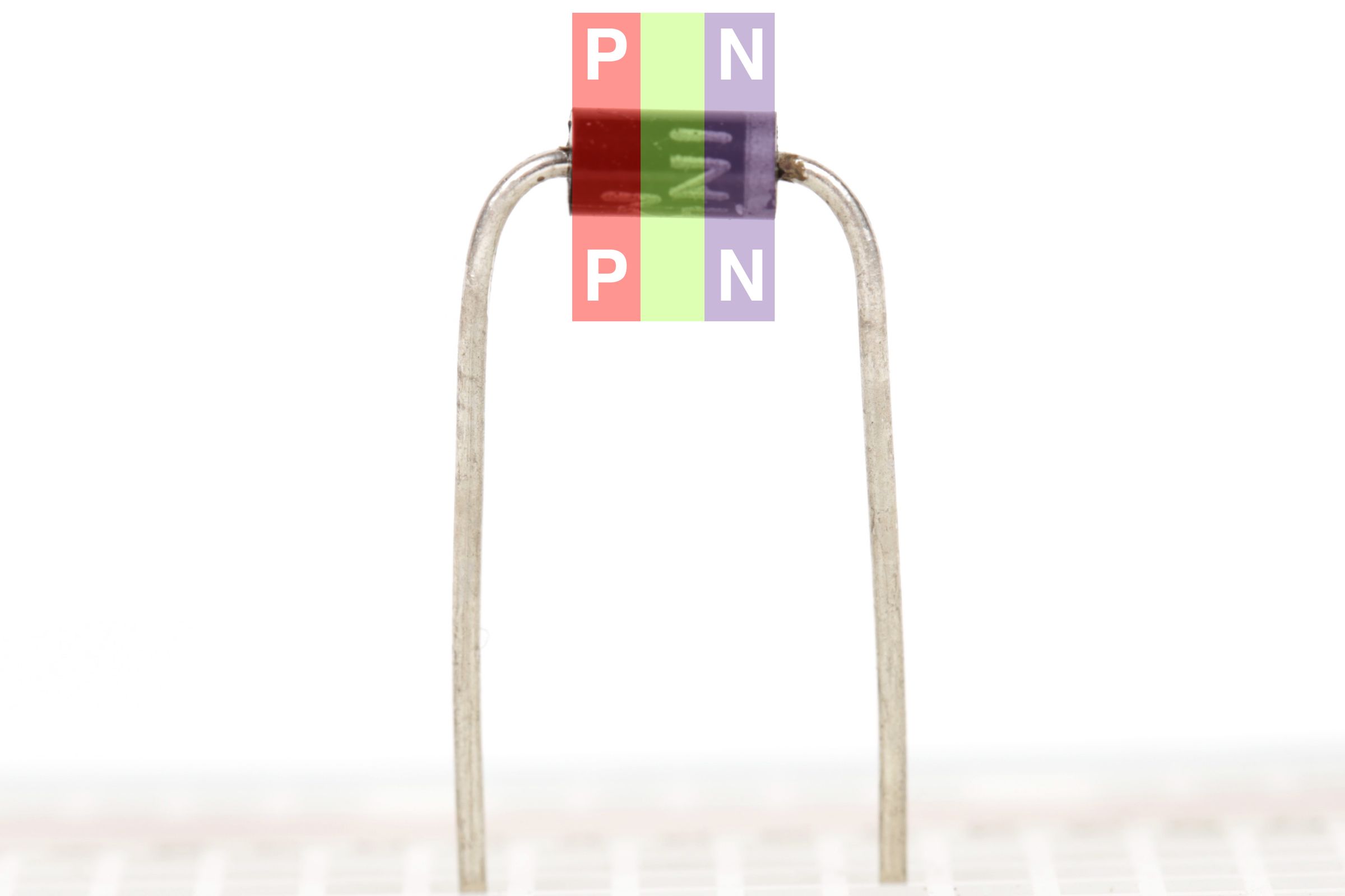

A diode consists of a PN junction made of P-type silicon and N-type silicon separated by a depletion region. The depletion region acts like an insulator. Put simply, the P-region is connected to the anode, and the N-region is connected to the cathode. The depletion region sits between the two.
When the P-region is connected to ground and the N-region is connected to a positive voltage, the depletion region actually grows in size. This ensures little to no electricity is able to flow through the diode between power and ground. In this configuration the diode is considered reverse biased.
When a positive voltage is applied to the P-region and the N-region is connected to ground, the depletion region all but disappears and allows electricity to flow. In this state the diode is considered forward biased.

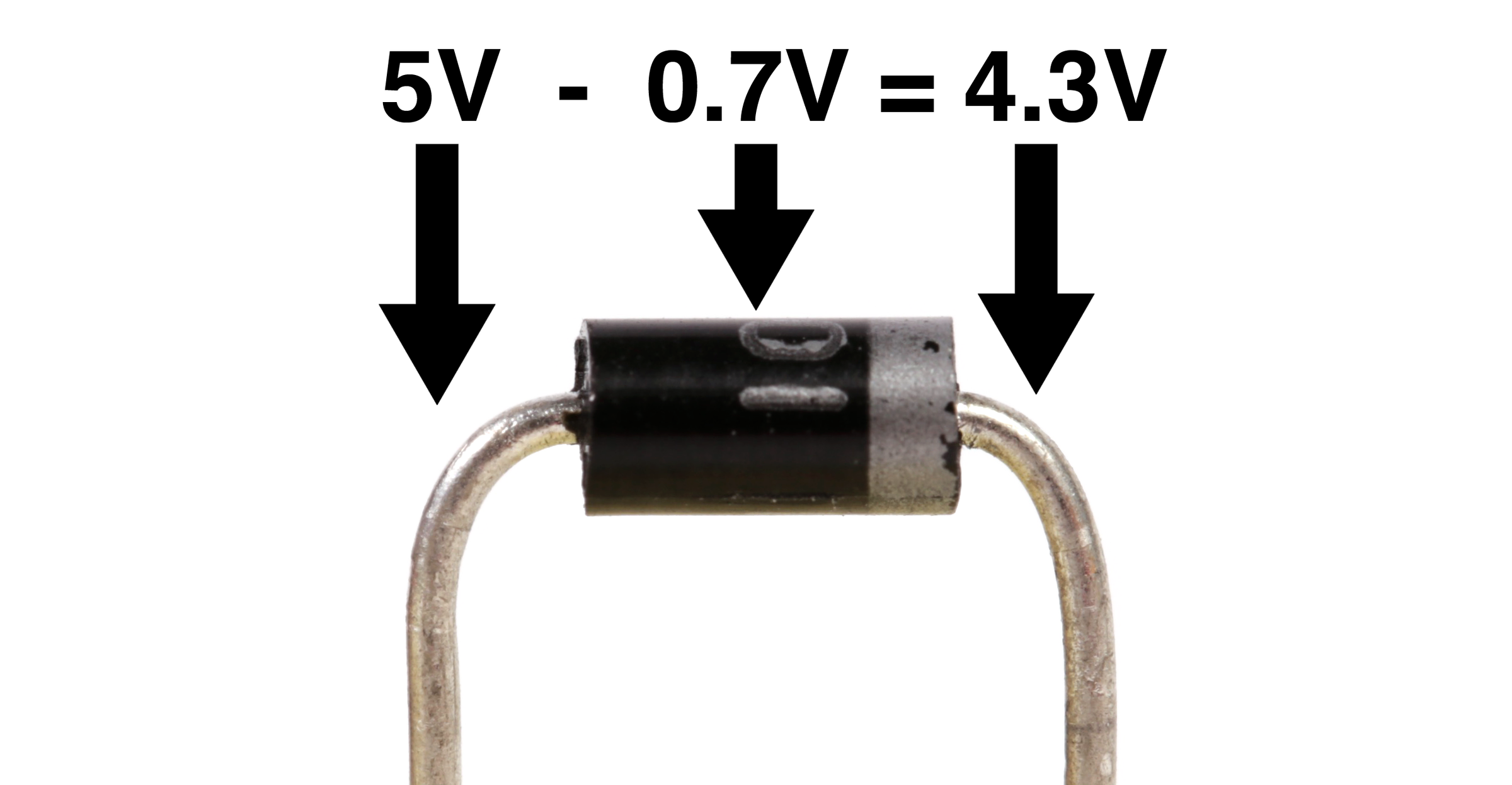

In order to overcome the depletion region, a little bit of voltage must be sacrificed. This is called the voltage drop. In a standard silicon diode like the one pictured this is typically 0.7V. However, and LED can have a much higher voltage drop. A typical voltage drop in an LED is 1.8 to 3.3 volts, and this varies by color.
In other words, if you have a 5V signal and it passes through an LED with a 1.8V drop, the voltage that comes out the other end will be 3.2V. It can fluctuate above or below this value depending on the type of LED.

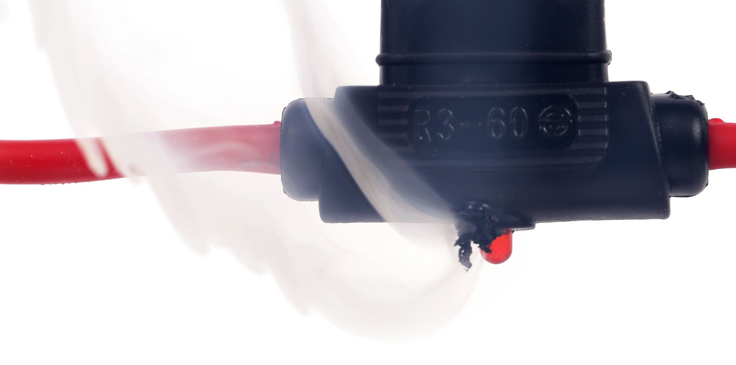

Step 4: Current Limiting Resistors
Since an LED is basically a diode and offers no resistance in a circuit, it typically requires a component called a resistor (that offers a fixed amount of resistance) in series with it.
This prevents the LED from being shorted and - given enough current - literally exploding.
As a general rule of thumb, a 470 ohm resistor should be more than enough to protect just about any low-power LED.

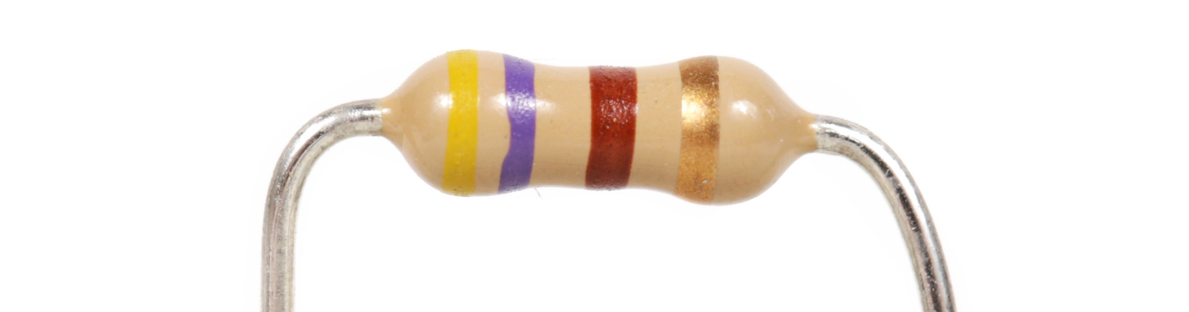

Determining how much resistance a resistor offers is a little trickier and can be established by deciphering the colored stripes from left to right towards the tolerance marking. You will typically see four stripes, but you may also encounter resistors with five.
Resistors with four stripes are the most common. These will likely be the type you are working with most.
When reading a resistor with four stripes, the first two stripes are combined together to form a number between 1 and 99. The third marking is the multiplier. The last marking determines the tolerance, which is basically the accuracy of the resistor and not typically important to know about when working with LEDs. If you would like to learn more, check out the Resistors lesson in the Electronics Class.
For instance, in the following example, the first two lines represent 1 and 0, which is combined together as the number 10. This is then multiplied by 10,000 (which is the multiplier). The result is 100,000Ω.
However, when a resistor is 1,000 or more ohms, we measure it in kilo-ohms. A kilo-ohm is basically equal to 1,000 ohms. So, 100,000Ω is shortened to 100kΩ. Basically, it is 1,000 ohms times 100. All we are essentially doing is removing three zeros from the number, and replacing them with with k.
If that was confusing, let us look at another example. This resistor has the same initial number of 10, but a multiplier of 1,000. When multiplied together, these numbers yield a resistance of 10,000Ω or 10KΩ.
Now, let's say the first two numbers were to change, and the multiplier were to decrease. In this example, the first two colors when combined create the number 68. When multiplied by 10, we get the number 680. Since 680Ω is less than 1,000, we just call this resistor 680Ω.
One last thing, if there is a million or more ohms, we then measure in mega-ohms. For example, this resistor is worth 1,000,000Ω. This is shortened to 1MΩ.

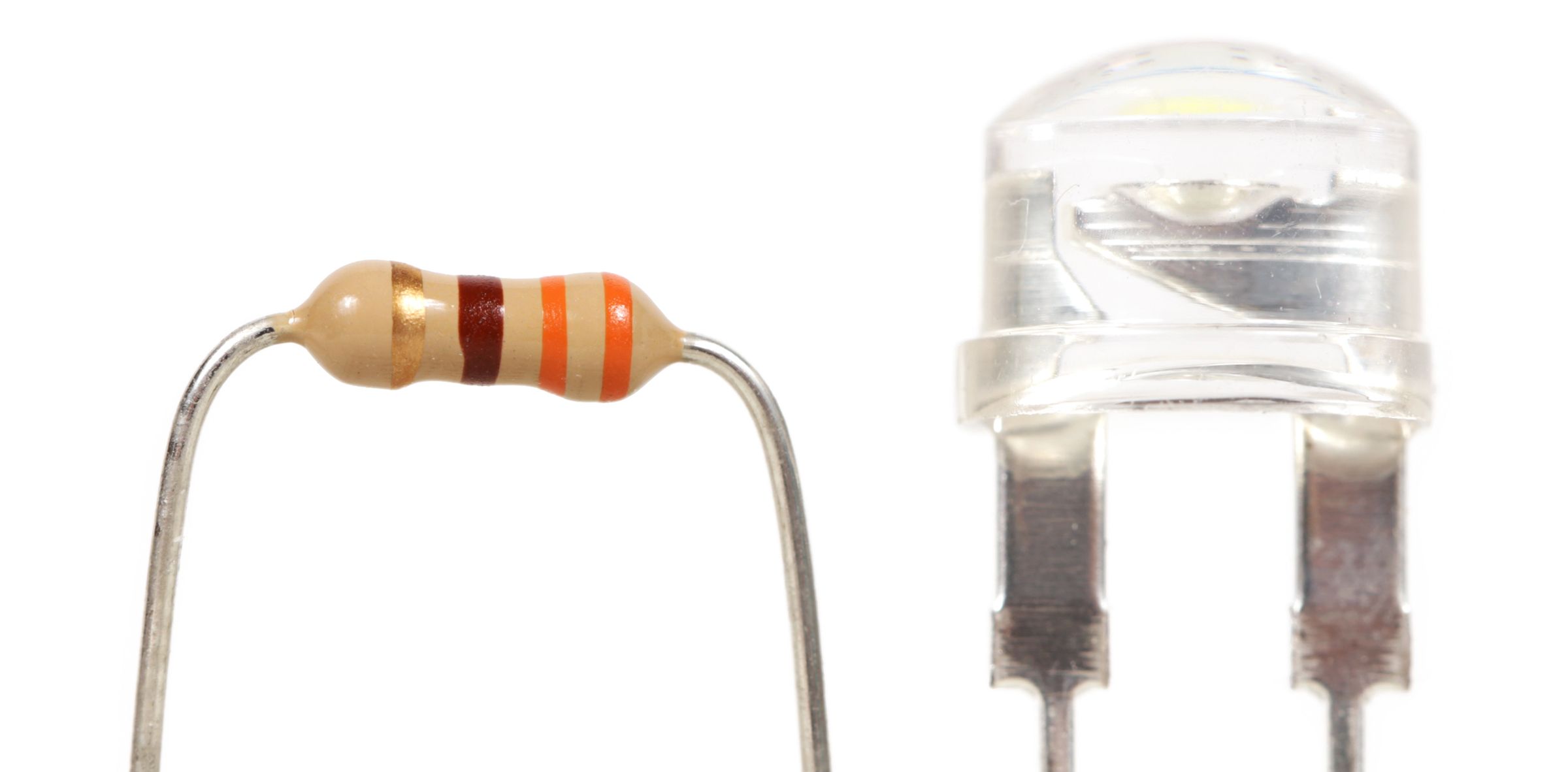

Resistors with 5 stripes are a little less common, but just as easy to read. Let us briefly consider how to read them. Like the 4 band resistor, you first find the tolerance marking on the far edge, and then read left to right towards the marking.
However, where they differ is in that the first three stripes get read as a single number, and the fourth stripe is the multiplier. So, in this case, we can determine the first number is 100 and it gets multiplied by 1,000, giving us a resistance of 100K.
The fifth stripe is the tolerance marking.

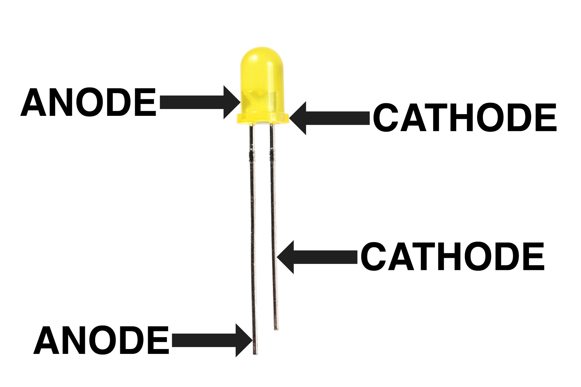

Step 6: Deciphering LEDs
Like resistors, diodes also need to be interpreted based on their packaging.
There are typically three ways to tell a standard 5mm LED's anode from its cathode.
1) The leg connected to the anode is typically longer than the one connected to the cathode.
2) The body of the LED typically has a flat spot on the cathode side.
3) If you look inside the LED, the little metal bit connected to the anode lead is much smaller than the cathode.

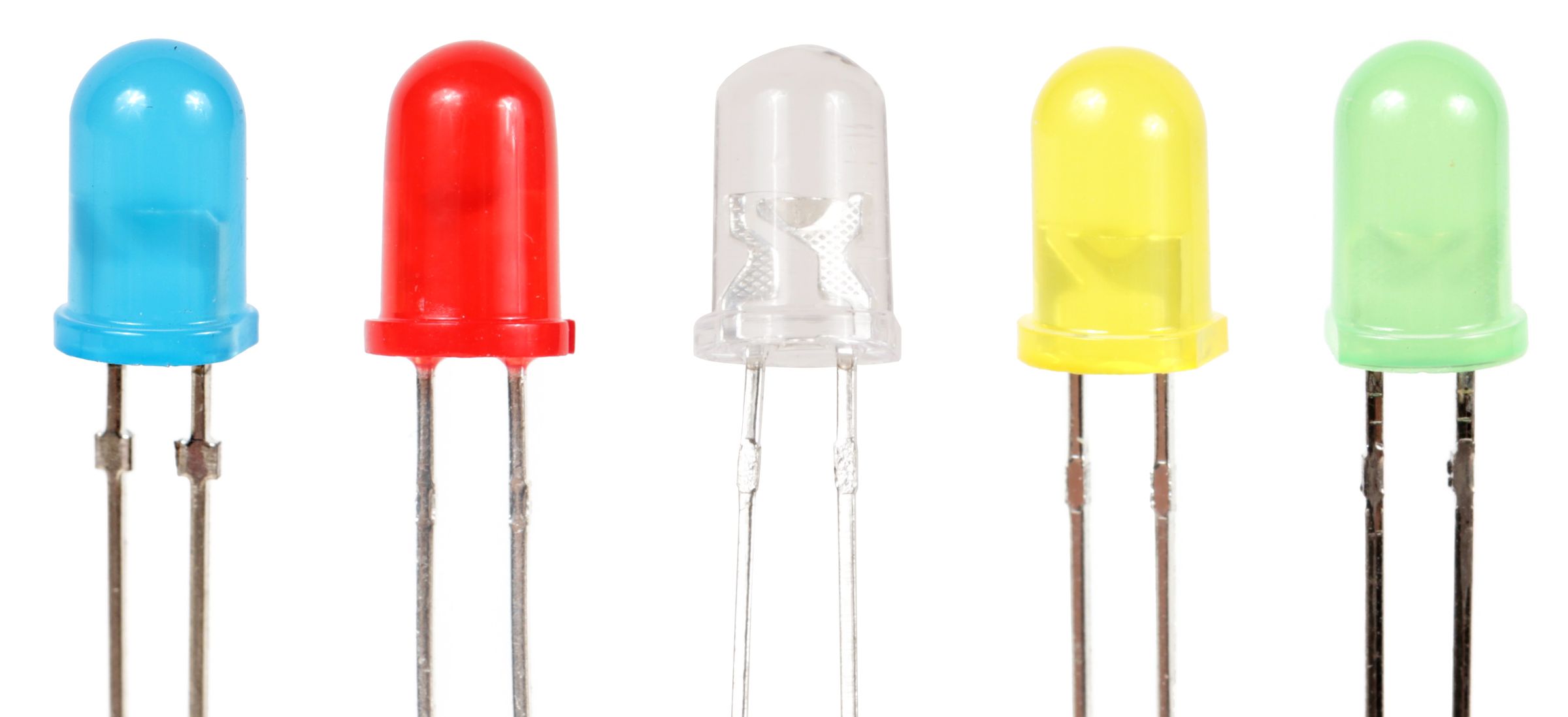

LEDs come in different shapes and sizes. The 5mm domed is the most common, but you are liable to also find them in 3mm domed, 10mm domed, rectangle, oval, and square (to name a few).
LEDs also come in many different colors. Often the plastic is tinted to indicate what color they are. However, clear LEDs are deceptive in that you might assume they glow white, but can actually glow a host of different colors.

LEDs have different viewing angles, or beam widths. What this means is that the visible brightness of the LED seems to decrease when you are looking at the LED from and a spot outside of its ideal viewing angle. This angle also determines the size of the spotlight created by the LED. The viewing angle on an LED can vary widely.

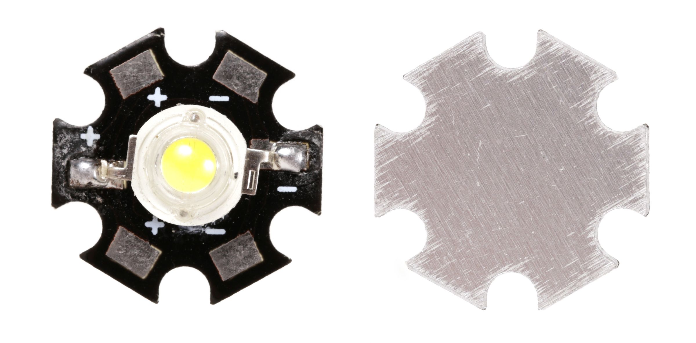

LEDs also draw different amounts of power. In fact, some high power LEDs draw so much power that they are mounted on metal heatsinks to dissipate heat. While LEDs such as these tend to be very bright, they sometimes require special constant current circuitry to drive them.

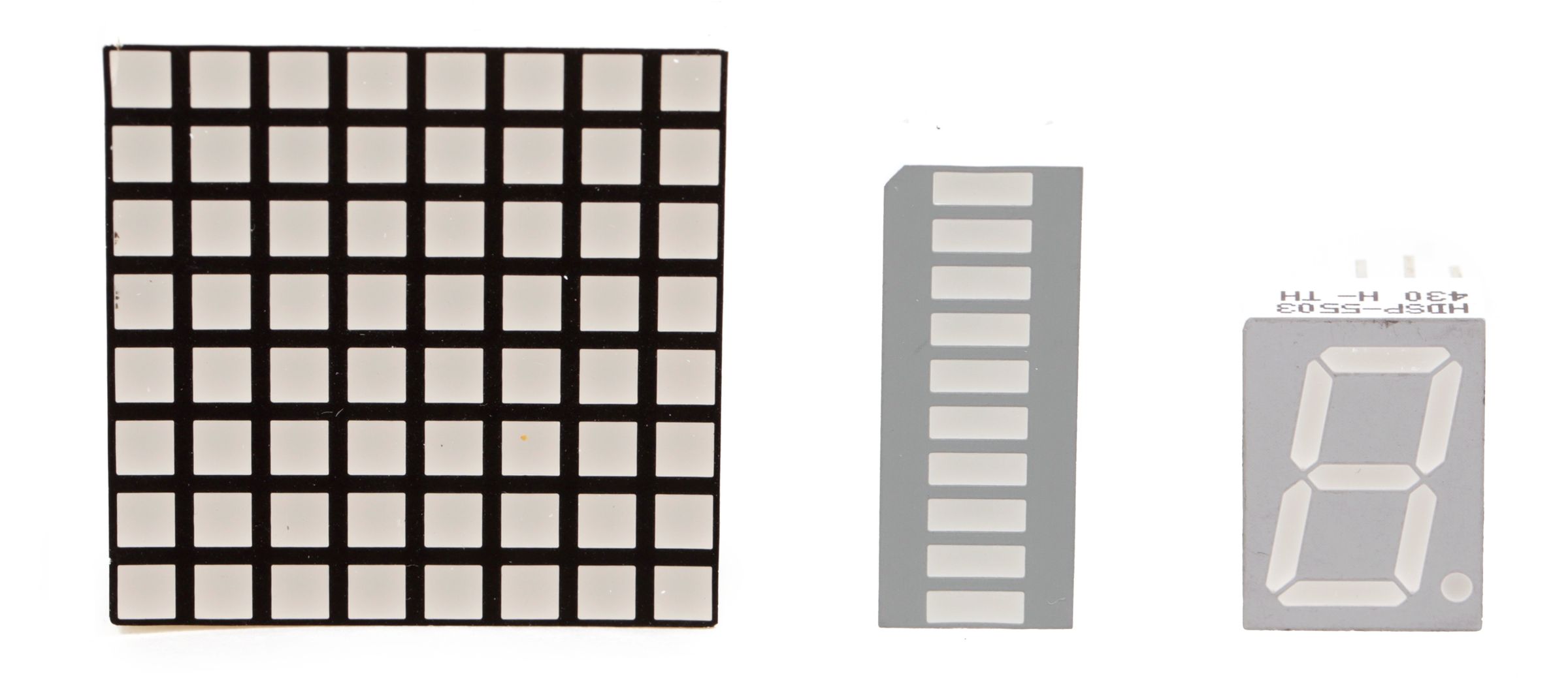

LEDs can come grouped together into display modules. With these LED dot, bar, and 7-segment numerical displays, each individual light-up segment is a discrete LED. For instance, the 8X8 matrix on the left actually has 64 separate LEDs inside of it.

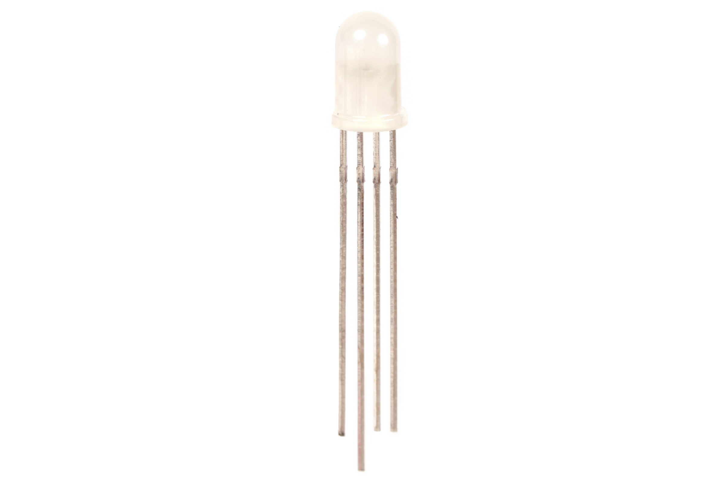

Multicolor or "RGB" LEDs are individual red, green, and blue LEDs built into a single LED package. Typically, each color has its own anode, and they all share a common cathode. By varying the voltage on each anode, the amount of red, green and blue light being emitted can be varied. By mixing these lights together, you can create nearly any color in the visible light spectrum. These LEDs are miniaturized and attached to the multicolor LED strips we will encounter in the next lesson.

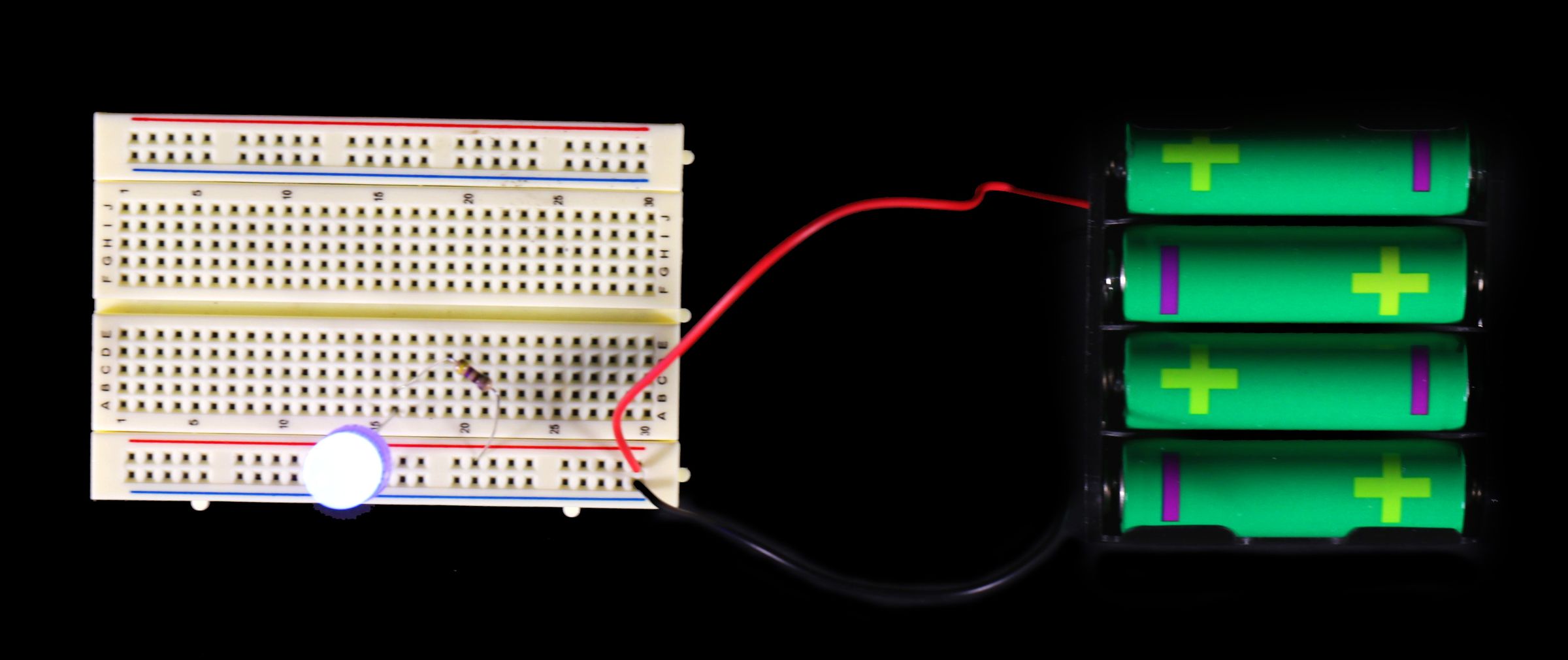

Step 8: Applying Power to an LED
To power an LED, you simply connect it to a battery pack in series with an appropriate current limiting resistor. As a general rule of thumb, a 470 ohm resistor is typically more than enough resistance for any 5mm LED that is being powered with 9V or less.

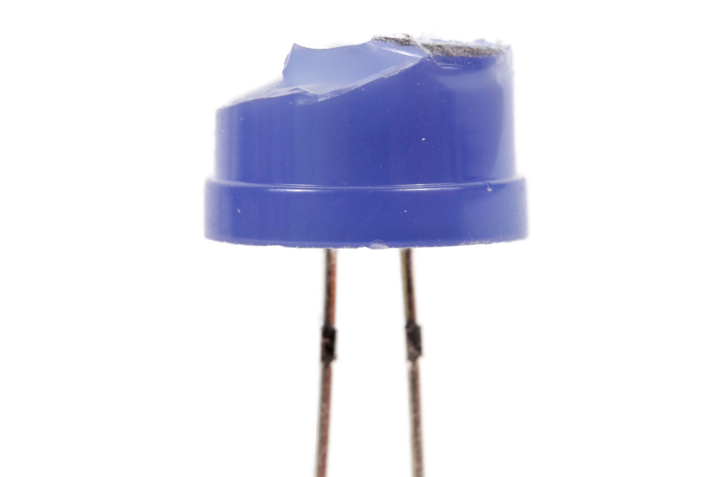

We can also replace the potentiometer with any variable resistor, such as a photocell to make it light controlled.
