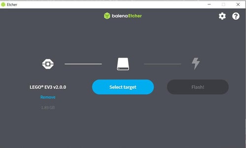

Step 2: Setting Up the Software and Mindstorms
First you need to download all the programs for the Mindstorms 3D printer:
  1. Visual Studio Code
  2. balena Etcher
  3. The EV3 MicroPython micro SD card image
  4. Code + Files
  5. Slicer (I recommend Ultimaker Cura)
You first need to flash the SD card with the EV3 MicroPython micro SD card image. You can find instructions on how to do this in the Getting started guide from Mindstorms Education EV3 MicroPython.
After this, you can download Visual Studio Code, and download the required extensions.
