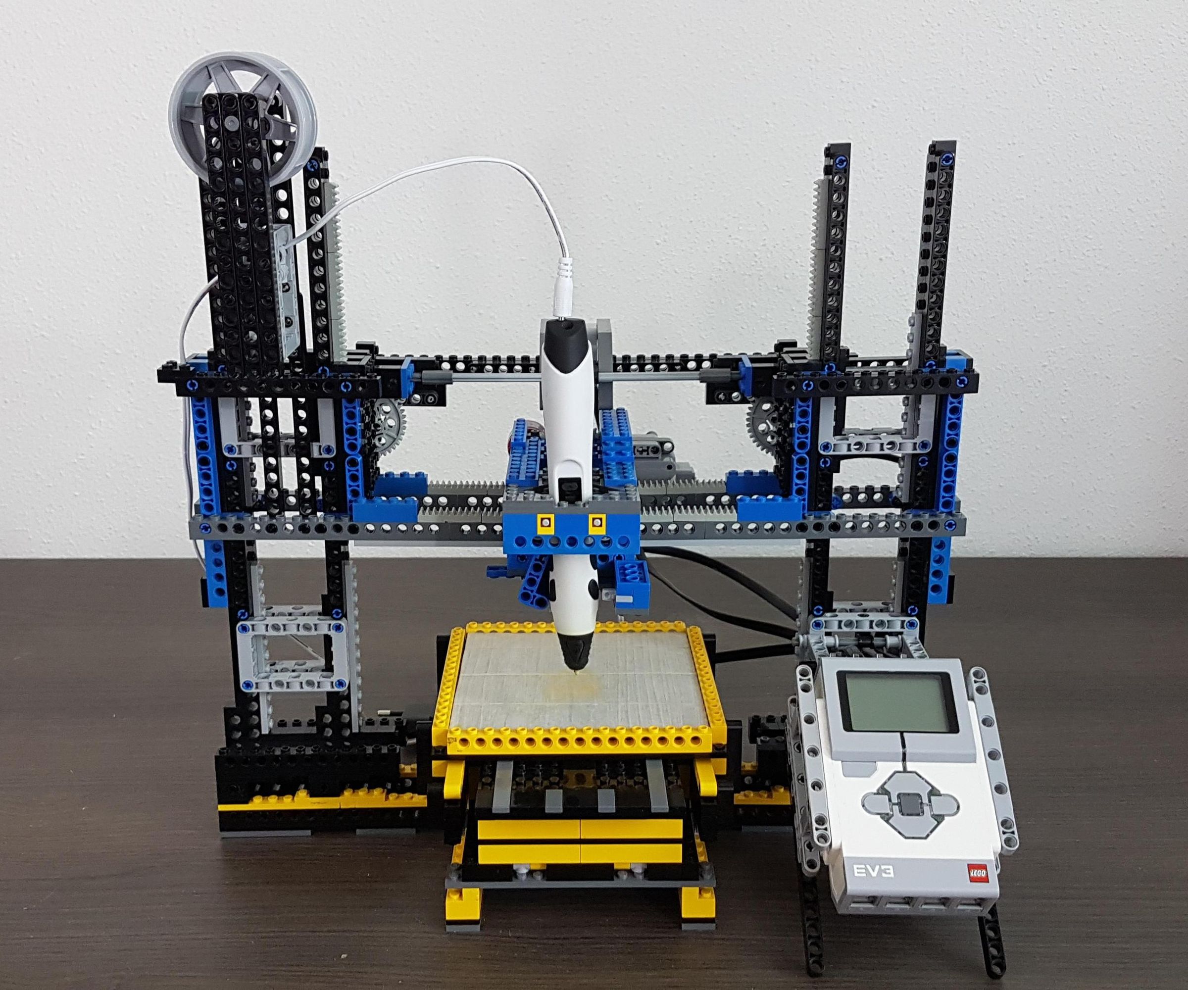

I was 12 years old when I made my first LEGO 3D printer. It was programmed using the Mindstorms EV3 Home Edition software. If I wanted to print a cube, I simply had to program the steps, and it got printed out!
Now, i'm 14 years old and made an improved version! It is programmed in Visual Studio Code using MicroPython and a SD card with the MicroPython Image.
So this are the instructions for one of the few LEGO 3D printers that can actually print 3d drawings, without having to program every model step by step!
If you would like to make this 3D printer, visit my Site for the more detailed instructions!
P.S. I would like it if you would let me know if you are going to make this project and if you got questions!
Step 2: Building
I'm not going to link building instructions, as my 3D printer isn't the best design possible.There are a lot of improvements to be done! If you haven't build your LEGO Mindstorms 3D printer yet, here are some tips:
1. Make sure you build a solid structure, because the smallest amount of movement, will make a big difference in the end result.
2. Move your platform from two opposite sides per axis. Don't try moving it with just one gear on one side, because the platfom won't move in a straight line, and may get stuck. You can simply make an axle going underneath the platform and connect it to the platform with some gears. Another option is to move the platform with linear actuators attached to the middle of a side.
3. If you work with gears, make a gear transmission, that reduces the amount the platform moves, in all three directions. (I haven't done this, but i should have) I recommend only one transmission per axis, as the platform would go to slow if you made more transmissions.
4. Make sure you use two the same motors with the same transmissions to move your platform. The code is programmed to work with two the same motors, because the medium and large motor move at a different speed. When you use two different motors, the code won't work propperly and your prints will fail.
5. Build a mechanism that can push the extruderbutton on the 3d pen. It will prevent getting loose threads.

Step 6: Printing!
Hit Run and Watch your 3d model being printed!
