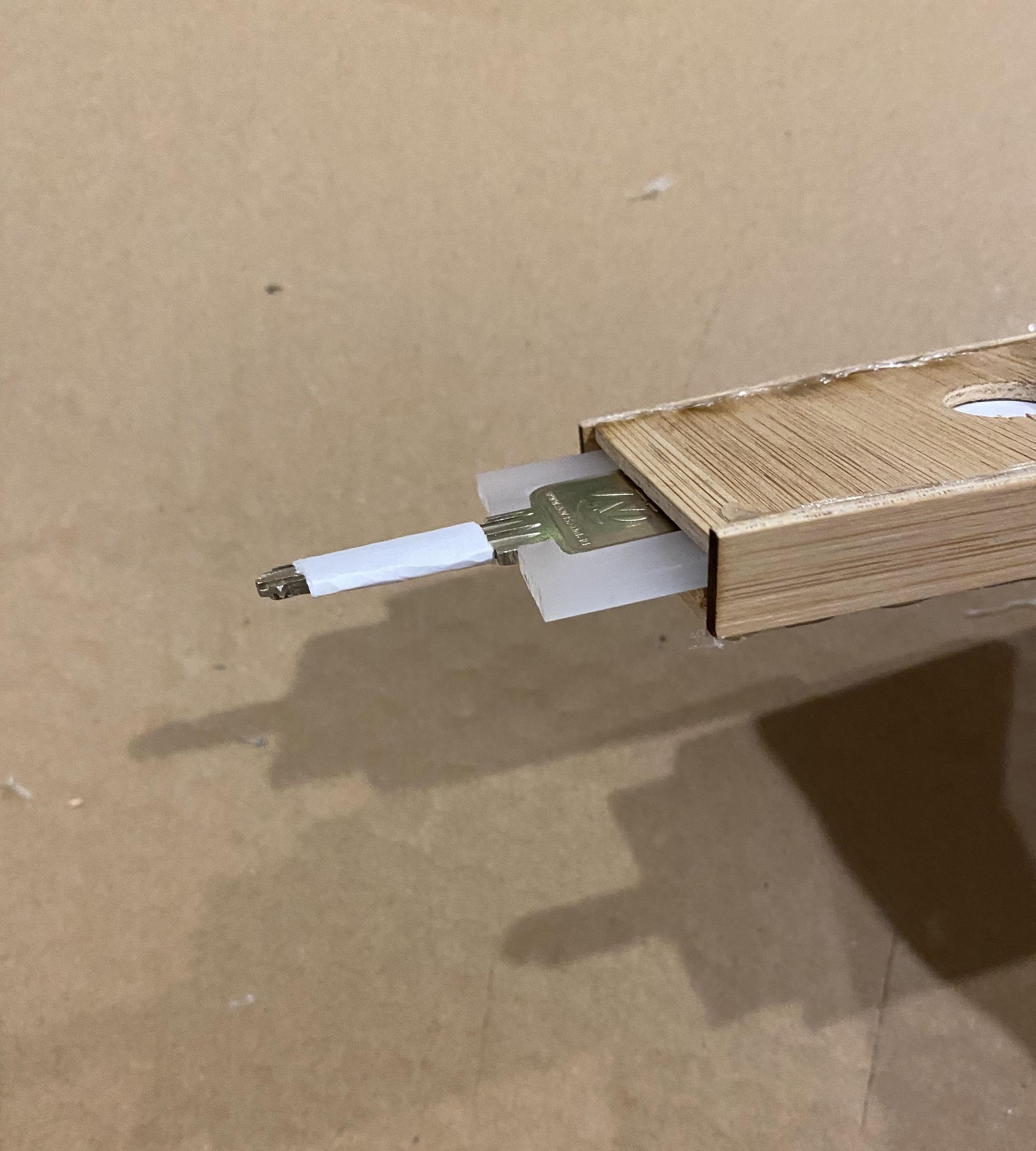

Step 4: Mounting
The next step is mounting everything onto the case. In my case, I faced a bit of issues as I did not have access to custom parts, so I had to keep modifying the case to fit everything that I wanted on. While mounting everything, you have to visualise where the plane will be. Keep in mind that you will also have to leave a gap in the front to guide the paper airplane when it is being shot, as shown in the picture above. Also, try to keep heavy items on the front and the back and mount the electronics in the centre. This is to ensure that the weight of the parts are evenly spread out. Another thing to look out for is that you need to make everything secure and pay more attention to parts that can be moved.
