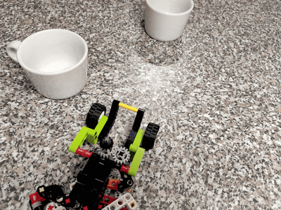

Introduction: LEGO Car With Realistic Steering
What I mean by realistic steering:
- Wide turning angle
- The inner wheel turns more than the outer
- Each wheel is turning around its vertical center
I've taken these parts from 2 LEGO sets (about 10$ each): 42101 Buggy and 42102 Mini CLAAS XERION. Instructions are made with LDraw (LDCad & LPub3D).

Step 1: Body Core and Rear Wheels
Following the instructions on the image, assemble the central body part, it will hold together front and rear wheels. Then assemble rear wheels and attach them to the central body.
