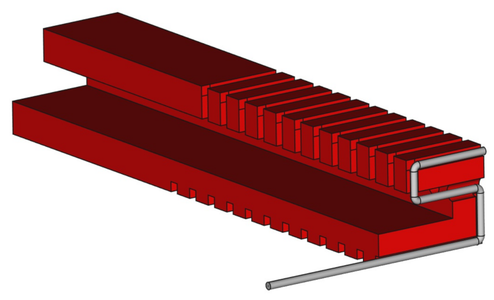

Step 2: 3D Print Clip
We start by printing the enclosed part in the Supplies section. Although it is easier to print horizontally (like it is the one in the above picture), it is best to print the piece vertically in order to give the plastic injected by the printer more structural strength to function as a clamp when inserted in the LCD screen.

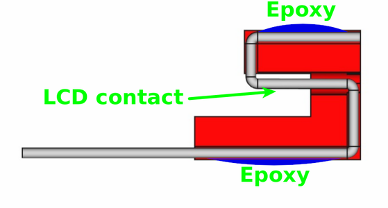

Step 3: Wrap Wires
The 12 copper wires must pass over the printed part following the path indicated in the section shown in the schematic image above.
To facilitate the fastening and to prevent the threads from moving when we place the clamp on the screen, we will apply epoxy resin on the upper and lower part of the piece. The piece of cable that remains inside the clamp will be the one that is clamped by the piece against the pads of the LCD display.
