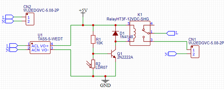

Step 1: SCHEMATIC DIAGRAM
Here we will see the operation by means of a voltage divider between the resistor R1 and the LDR through these two resistors we will detect a positive current and a negative current.
When there is darkness, a positive current will reach the base of the transistor, activating the RELAY and the 220VAC bulb.
When there is light, a negative current will reach the base of the transistor, deactivating the RELAY and therefore the relay and the 220VAC bulb do not work.

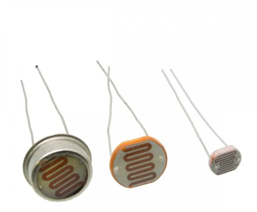

Step 2: LDR
Photoresistors or LDR (from the English Light Depending Resistor) are a type of resistor whose value depends on the light they are receiving. It is very small when it receives a very intense light (a few Ωs), and increases in value as the light it receives decreases.
They are typically used in two ways, for an automatic lighting system that turns on when there is little ambient light, or to detect nearby motion if something comes between the light bulb and the photoresistor.
Photoresistors have only two legs, just like normal resistors, so to measure a voltage variation (as we have done with potentiometers) we will have to use a little trick that will serve us for many other things.

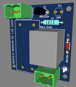

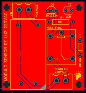

Step 5: EASYEDA
This project was made in the Easyeda software as we can see the tracks and the 3D image of the project working perfectly are no difficulty
