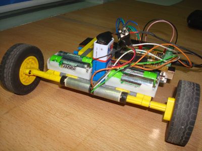

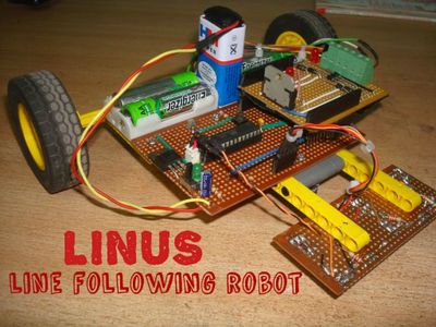

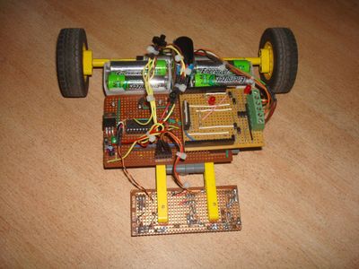

This is my attempt at a line following robot. I basically upgraded it as i went so i am just going to give and overview of the build and allow you to use your thinking. I used Lego as the base and then made my own sensor array. The first sensor array had 8 sensors but i realized that only 4 were being used so i made another with only four sensors. At first used the Arduino Uno and then upgraded to standalone Arduino.

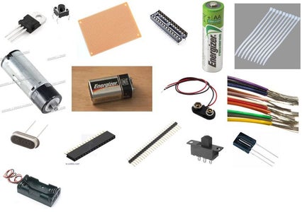

These are the parts i used
2 x 6 V 310 RPM Geared Motors
1 x Lego Base

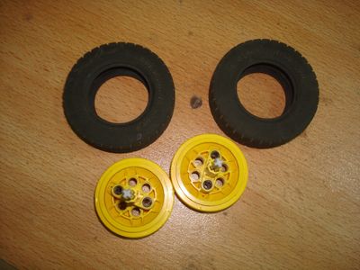

2 x Lego Tyres
1 x Atmega 328
1 x Vero Board

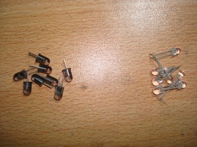

4 x IR Led
4 x Phototransistors
1 x 28 Pin IC Base
1 x 9 V Battery
1 x 9 V Battery Clip

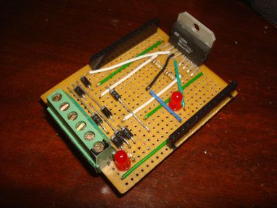

1 x Arduino Motor Shield
(I used the one i made myself)
https://www.instructables.com/id/Arduino-L298-Motor-Shield/
2 x Slide Switch
1 x IR Receiver
1 x Crystal Oscilator 16 Mhz
1 x Tactile Switch
2 x 2 AA Battery Holder
Indicator Leds

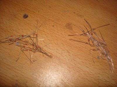

Resistors (10 k and 220 Ohm)
Jumper Wire
Male Header Strip
Heat Shrink Tube
Zip Ties
Double Side Tape
Female header Strip
Some instrument to program you micro controller. I used USPasp
Basic tools and some skills are also required

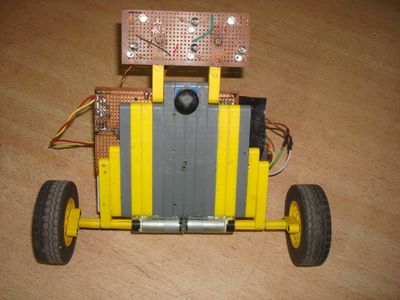

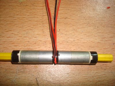

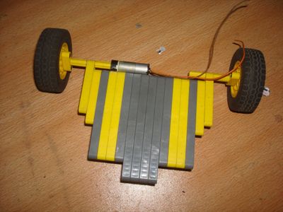

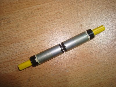

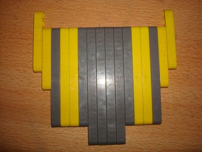

The first thing to do is to get your motor assembly done. For that i glued the two motors together and then to the Lego chassis. To my convenience they were compatible making my job much easier.  BTW. In the last picture i removed one of the motors as it got damaged and i had to wait for the replacement to arrive.
Step 3: Sensor Array

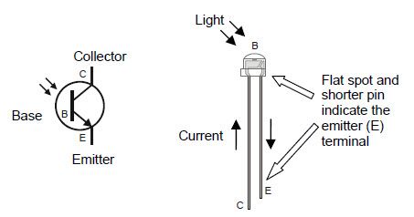

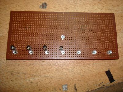

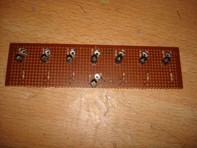

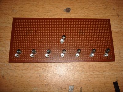

For the sensor array i used a vero and made my circuit on it. The pictures are of my first attempt but the final version is built the same way, just smaller. The schematic is repeated for every pair of sensor.

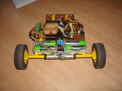

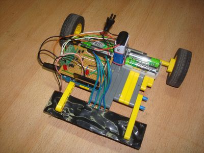

Next is to attach the two battery holder and the 9 V battery. I first used an arduino to test it out but you could go directly to the circuit.
Step 5: Make the Circuit

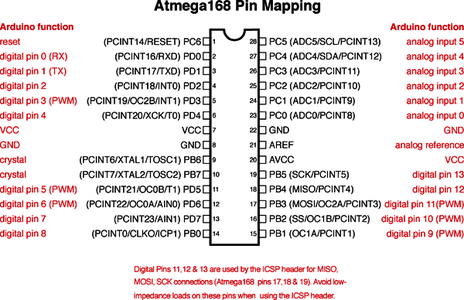

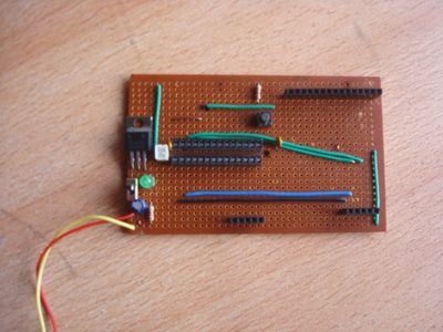

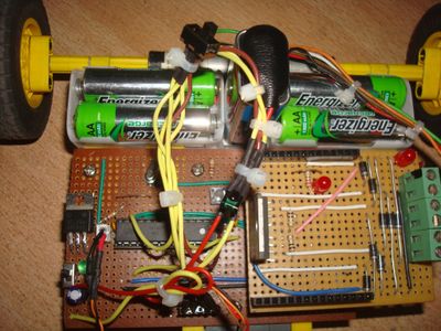

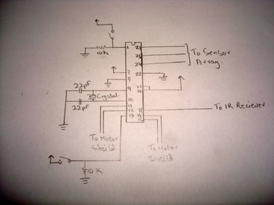

For the main circuit i used the Atmega 328 with arduino boatloader. I made it so that the same motor shield was used and with headers i made it removable. Other connections such as connection to sensor array etc were alse with headers to make it removable. The circuit is straight forward. Just the standalone arduino with 4 connections to the motor shield.
Step 6: Finalizing the Hardware
Next i assembled every thing. The circuit board was was screwed to the chassis and so was the sensor array. After testing i added the IR receiver and the mode switch.

The robot turned out pretty good.
