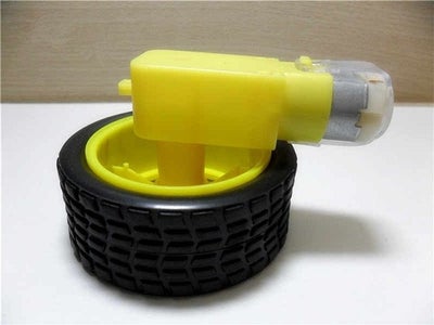

2 x Gear Box with 30:1 of ratio transmission and associated DC motor
2 x wheels 3"

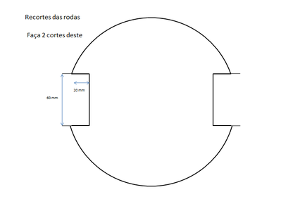

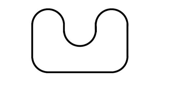

The chassis was constructed with a 3 mm piece of acrylic in a rounded format with slots for the wheels.
See the screenshots below (sorry but is in Portuguese) but can have a general idea.

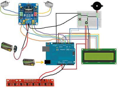

Lets go to the pinouts:
1 - The motors are connected to the output pins of the H-Bridge (care about to the polarity);
2 - The 9V battery is connected to VCC (+) and GND (-) of the H-Bridge;
3 - Pins in1, in2, in3 and in4 of H-bridge are connected to the arduino pins: 10, 11, 5 and 6 respectively;
4 - Pins 1, 2, 3, 4 and 5 of the QTR sensor, are connect to the pins A0, A1, A2, A3 and A4 (notice that the sensor 1 should be the most left);
5 - The LCD is connect as showed in the diagram: pins R / W - 13, Enable - 12, data - 9, 8, 7 and 4 (it dependent of the type of yours display);
6 - The button is connected to pin 2 of the Arduino;
7 - The Buzzer is connected to the Arduino pin 3;
8 - The Battery sensor is connected to pin A5
10K/5K consists of two resistors connected to GND / VCC and the center tap is connected to the arduino. as below
