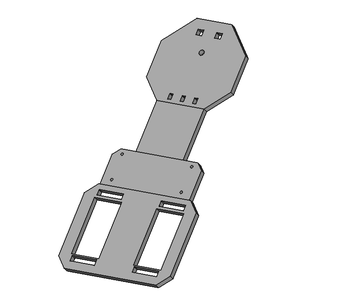

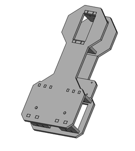

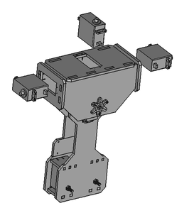

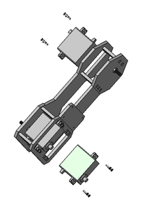

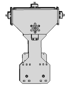

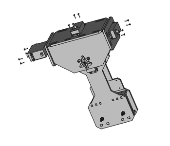

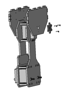

Step 2: Torso
Assembling the torso is pretty straight forward.
Use pliers to gently crack the wooden boards apart. The pieces are held in place by tiny bridges that can be broken by bending the wood. Be patient!
When the parts are free, use a Stanley knife and some sandpaper to remove any off-standing fibers.
Use a hammer or rubber mallet to punch the parts together as shown on the images. Most parts are made in a way that makes it impossible to use them in a wrong way, but no system is fool proof. So be sure that you read the whole thing and understand it before you start.

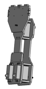

Step 4: Arm
Make one first, and use it as a template to make sure that you have a mirrored pair!

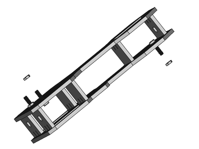

Step 5: Hips
The Hips are slightly more complicated. They have a lot of small parts that can easily get damaged. Be sure to understand the construction before you begin and be sure to build two mirrored hips.

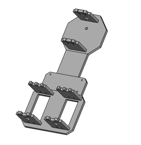

Step 6: Leg
There is not much to say about the construction of the legs except to make sure that you have a mirrored pair!

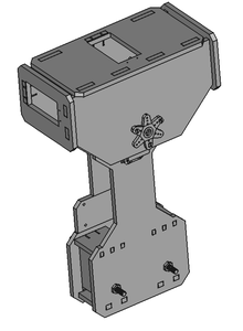

Step 8: Head
The head is where most of your computer electronics go. It is also the part where you get to decide how it should work. You should therefore plan carefully what you intend to do. Maybe you need to drill some holes. Maybe do some sawing, laser cutting or measuring. Do most of that before you assemble the head, a it will be harder afterwards.
