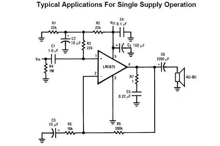

Step 1: Circuit Assesment
The data sheet gives example circuits but for some reason offers different values for the single supply version and the Zobel network is quite brutal.

To configure a single supply version then biasing resistors are needed to set mid-supply and so an output de-coupling capacitor is needed to stop the voltage offset getting to the loud speaker. The values given on the data sheet are good but the feedback resistors have caused some confusion (somebody in the Drawing Office might have lost a decimal place) so use the same values as the dual supply version i.e 1k ohm and 20K ohm (I used 22K ohm as it is the same as the bias resistors).
Please note that the minimum gain may be set to 10; the given values are for 20.
Required Gain is the output voltage divided by the input source voltage.
Note that the minimum supply voltage is 20 volts or +/- 10 volts and 50 volts or +/- 25 volts is needed for maximum power output.
Step 3: Zobel Network
The resistor and capacitor across the output to the loud speaker is known as a Zobel network but is in fact derived from a Boucherot cell (probably because Zobel is easier to remember!).
https://en.wikipedia.org/wiki/Boucherot_cell
The network is added to counter-act the inductance of loud speaker and associated cable which will have an increasing value with frequency.
All you need to know is that the "Zobel network" limits the maximum impedance by being the highest value on the line i.e the RZ value.
I use the following formula to give suitable values:
RZ = Re × 1.25
CZ = Le / RZ²
For a nominal 4 ohm loud speaker, I used 5 ohms (3 x 15R ohms = helps with power dissipation) and 10uF.
Please note, by implication, that RZ will have to dissipate the power not going to the loud speaker!
