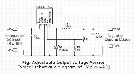

Step 1: SCHEMATIC DIAGRAM
Like all my projects, I share the schematic diagram so that you can do it yourself. The schematic diagram was designed in EASYEDA, a very professional and free electronic circuit design software, we can observe the electronic components that we use for this project and their respective values.

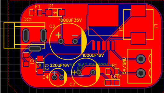

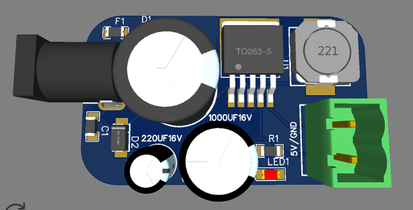

Step 4: EASYEDA
This project was made in the Easyeda software as we can see the tracks and the 3D image of the project working perfectly are no difficulty
