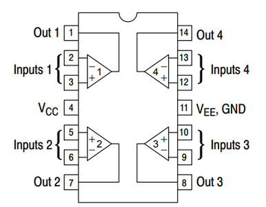

These devices consist of four independent, high-gain, frequency-compensated, operational amplifiers that are designed specifically to operate from a single supply or split supply over a wide range of voltages. Because of these 4 built in OP-amps, we can get 4 channel output of the supplied signal with adjustable gain.

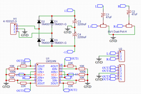

LM324 has 4 channel Operational amplifier, we need to repeat the configuration of resistors with each so that it can give 4 channel output. I choose 3.2gain for this buffer circuit and a 100k potentiometer for master volume control. 10k, 22k resistors are Rin and Rf respectively, 100k resistor is to give proper biasing to the operational amplifier.
Two small value electrolytic capacitors are used in the circuit as coupling capacitors(Blocks Dc to flow). Because my circuit works on dual voltage, I made an onboard power rectifier section with filter. All the connections are given through male pin headers.

Supply this board with a center tapped transformer with 12-0-12volts @500mA. Input is supplied with Right left audio channels directly from AUX or through bluetooth. Output section has 5 pins, One pin is common ground and other four are amplifier outputs.
Because board has onboard power rectifier and filter. That's why I made a test without power section first. I made a rectified filtered power supply in past. You can see this from here.
