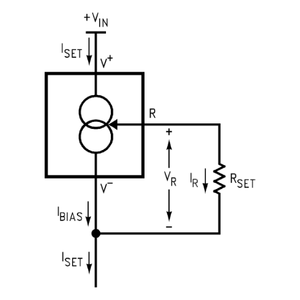

If we want to test functionality of LM334Z current source we need to firstly create an test circuit as shown in the figures. After we created this circuit we will try to understand how LM334Z and this circuit works

Using these information, we will perform the test utilizing the Basic 2-Terminal Source circuit provided in the datasheet.
If we use Basic 2-Terminal Source circuit (as shown in fig.) Iset (i.e constant current output) determined by 67.7 mV/RSET (@ 25°C) formula. This formula has been used as the basis for the circuit we built in this project.

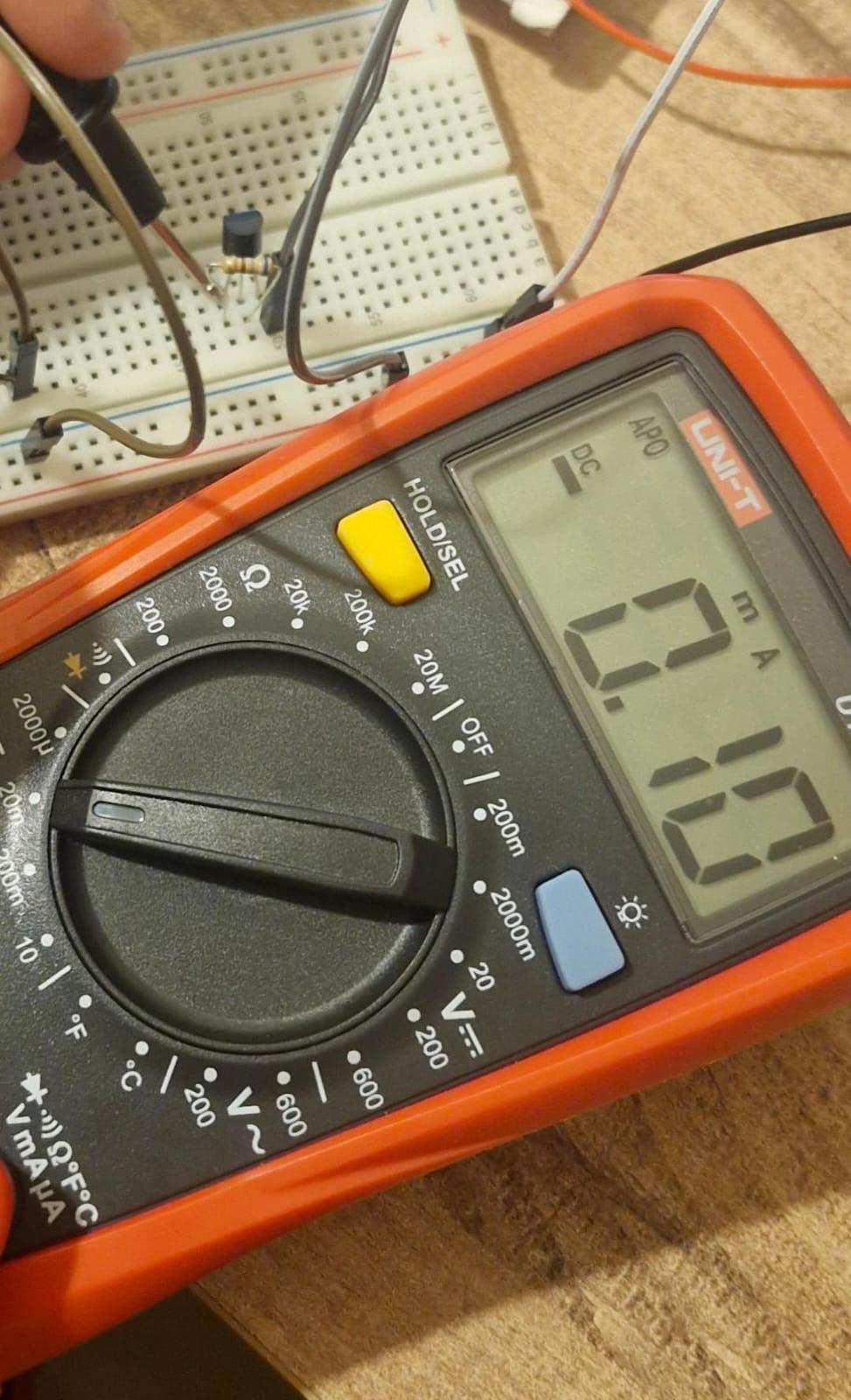

In summary Iset (i.e constant current output ) approximately dividing 68 to Rset resistor value. Based on this, when we use 680 Ohm resistor (Rset) we will see as shown in figure 0.1mA (i.e 100uA) are seeing the result. Bam ! Constant current is ready !
The most important result of this test is the stability and steadiness of the current. The output current changes only when the Rset adjustment resistor is changed. Connecting a load or changing the source voltage must not affect the result. This creates a constant current that we can use in our projects.
