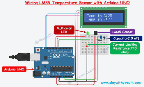

Let’s begin by connecting the LM35 temperature sensor to an Arduino UNO and display the temperature readings in both Celsius and Fahrenheit on an I2C 16×2 LCD display. Additionally, we’ll use a common cathode RGB LED to visually indicate the temperature range:
  1. Red for high temperature
  2. Green for normal temperature
  3. Blue for low temperature
Sensor and RGB LED Connections
In the wiring setup:
  1. The Analog output pin of the LM35 is connected to analog pin A0 of the Arduino.
  2. The VCC pin of the sensor is connected to 5V, and the GND pin is connected to GND of the Arduino.
  3. A 10 nF capacitor is placed between the output and GND pins of the LM35 to help stabilize the sensor's analog signal and minimize noise.
The common cathode RGB LED is wired as follows:
  1. Red anode → Arduino pin 10
  2. Green anode → Arduino pin 8
  3. Blue anode → Arduino pin 9
  4. CathodeGND via a current-limiting resistor
This configuration allows the LED to change colors based on the current temperature.
I2C LCD Connections
We’re using a PCF8574-based I2C module attached to a 16×2 LCD to display the temperature readings.
  1. The SDA (data) pin of the LCD is connected to Arduino A4
  2. The SCL (clock) pin is connected to Arduino A5
  3. The VCC and GND pins of the LCD module are connected to the 5V and GND pins of the Arduino, respectively
Note: Since the I2C communication uses A4 (SDA) and A5 (SCL) pins, these should not be used as regular analog inputs when the I2C LCD is connected.
I2C Address Configuration
Make sure that the A0, A1, and A2 address jumpers on the I2C module are not shorted. This configuration sets the I2C address of the LCD to 0x27, which matches the address used in the Arduino code.
If all three address jumpers (A0, A1, A2) are shorted, the I2C address changes to 0x20, and the code would need to be updated accordingly.
