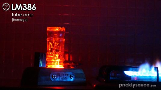

For this project I wanted to capture some of that beauty within and what better than the vacuum tube as an embodiment of seeing the 'working' inside...
...the glorification of the humble into an aesthetic beauty.
This humble little amp build takes the aesthetic qualities of the vacuum amp to make an intriguing little object that is...
...great to look at, glowing red when switched on like a vacuum tube...
...the power source on show and easy to get to...
...and the on / volume knob made with a found object, an old bike derailleur jockey wheel to materially tie the amp to the Bike Tyre Speaker.
The two projects are made for each other!

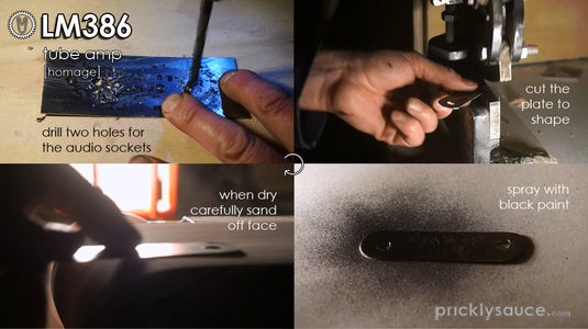

Step 4: Metal Etching
As the audio sockets were now located on the front, I decided to add a little metal plate with an etched graphic. The audio sockets would look as if they were the fixings for the plate.
Cut a stencil from some sticky backed vinyl sheet.
I am fortunate to have a Silhouette Cameo cutting machine that I can down load Illustrator files to, makes for super easy and accurate stencils. A careful hand and a sharp knife will do the job as well, though may take a little longer.
I also cut out the outside shape and the location of the audio jacks for ease of drilling in awhile.
I decided to use the graphics from the intro to the video that I made for the build PLAY IT LOUD which seems appropriate for an amp!
Stick the stencil to the 1mm thick steel sheet.
Now to make an etching machine -
Find an old working wall plug transformer, something around 12 volt 1amp is good. Mine was 13.5volt and 1.5amp and worked well.
Cut the transformer wire and connect crocodile clips to both the positive and negative ends. Mark the clips polarity.
Make the lengths of the wires different so less chance of the the clips touching and shorting if turned on and lying on the bench.
Get a long wire nail, i used a long 125mm long one.
Cut a piece of heat shrink tubing and slip over the nail leaving about 20mm clear at the head end and heat shrink.
Alternatively use some electrical tape.
Take a cotton wool pad and wrap over the nail head, attaching with some thin wire.
Now to etch
Make up some salt water solution, add a good amount of salt to a container and add water, I used hot water to help the salt to dissolve quicker, mix to a salty solution.
Attach the negative clip of the transformerto the nail...
...positive clip to the work piece.
Plug in the transformer.
Dip the cotton wall into the salt solution and apply to the stencil and hold down against the metal for a few seconds.
The metal will start to sizzle, it is etching.
Please do this in a well ventilated space as I am sure the fumes wont do you any good.
Etch all around the stencil and also etch the outer edge of the stencil to mark the shape to be cut out.
I went all over about three times to get a good deep etch.
The etched area will be black by the end.
Switch off the transformer.
Peel off the stencil and wipe the black off with a cloth...
...and admire your metal etching!
Mark the two holes with the end of a nail and drill for the audio connectors to poke through.
Cut the metal to the outer line shape that you have etched and file to a nice finish.
I wanted to enhance the etch so I sprayed black paint over the front and left to dry...
...then sand the front leaving the black within the etched graphics.
Cool!

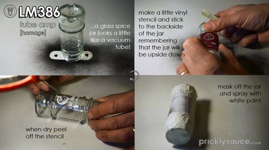

Step 6: Make a Vacuum Tube!
To make our 'vacuum tube' look as authentic as possible it needs some graphics on the back.
Real vacuum tubes will often have a logo, serial number and often place of manufacture stamped onto the glass...
...and ours needs one as well!
Make another vinyl stencil of your own design...
...check which is the back face and stick on the stencil.
Mask the rest of the glass jar with some masking tape and spray white.
Remove the stencil and you have a cool little finishing touch.

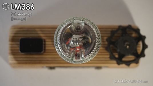

Step 7: Volume Dial
The volume dial of this amp was always going to be the jockey wheel from an old mountain bike derailleur as it would link the amp directly with the Bike Tyre Speaker that is its companion.
And it looks cool!
I needed to fill in the centre hole and I found a 20mm diameter black plastic rod in my workshop.
Drill a hole to match the potentiometer stem in the centre of the rod to the required depth.
Open up the jockey wheel centre hole with a coping saw and final finish with a file or a abrasive drum on a Dremel multi tool.
Glue the two together.
When cured sand off the rod flush with the jockey wheel on the top face.
Drill a small hole in the top centre for a small black coloured fixing screw that will screw into the top of the potentiometer stem.

...Carefully slide the glass spice jar over the electronics and screw onto the base...
...fit the jockey wheel volume control...
...fix the metal etched plate to the audio connectors with a little Araldite glue to hold firmly in place...
...push in the battery...
...plug in your MP3...
...and connect up your speaker...
...and PLAY IT LOUD!
