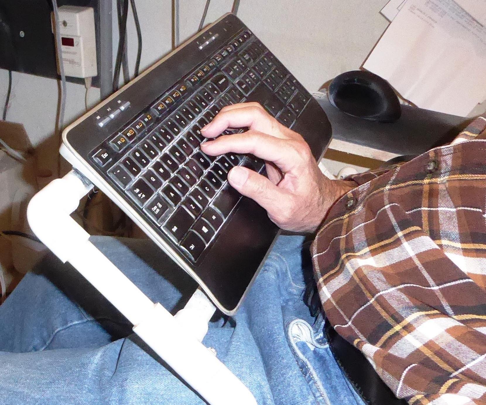

Readers may have noticed my PVC keyboard stand which was copied from my:
https://www.instructables.com/id/Easy-Laptop-Stand/
