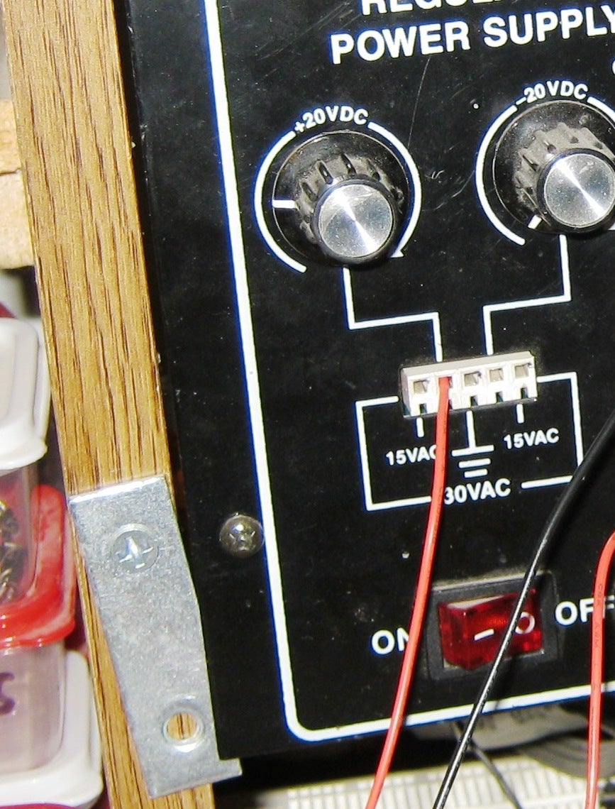

Step 2: Elenco Trainer
So you might be asking what is this Elenco Trainer? Well, that’s an excellent question.
It is a mini electrical workbench for experimenting with electronics.
Technospeak: It has fixed and adjustable power supplies, a couple of potentiometers, a waveform generator and some simple digital circuits, plus a breadboard.
So these were designed to go in a case. They’re about 11” x 10” x 3” deep.
Problems: It could be used flat on my work space but it takes up a lot of room. I did use it standing on end but when not used it got in the way. Plus it’s a 110Vac device and the back is open, so it’s a little dangerous.
Solution: So I attached it vertically to my workbench. (see picture)
Actually, first, I wanted to remove the breadboard as it’s hard to work on a breadboard vertically (at least this Lazy Old Geek thinks so). Unfortunately, this requires removing the main PCB, which requires removing the knobs and also some regulators attached to the metal frame. Well I did get the breadboard out and got it back together.
Problem: The connector on the adjustable power supply are larger than standard breadboard size.
Solution: Since I was already in there, I ran wires out and put in some banana jacks, so it would be easier to use them.
To make it more geeky, I decided I wanted it to swing out of the way when not in use. Well, I spent a lot of OLD brain hours trying to figure out how to do this. I decided on some hinges to allow it to swing out of the way.(see picture)
Please believe me, this was a ‘bear’ to install the hinges and trainer back inside that crowded space. So the upper lip on the Elenco overlaps the board on the workbench so the Elenco would hang vertical. But the left side just clears the workbench so that it could swing back.
Problem: How do I keep it vertical. Well, this required another OLD brainstorm. I was first thinking of something under the Elenco or behind it.
Solution: Well, the Eureka moment hit. I put a little metal plate on the workbench and hooked it under the Elenco. (see picture)
Problem: How do I latch it horizontally. Well, this required another OLD brainstorm.
Solution: Well another Eureka moment. The Elenco horizontally extended beyond the workbench shelf. I used a piece of an aluminum sign (For Sale?). I cut a notch in it and drilled a hole in it. Then I screwed it loosely into the back of the workbench shelf. When the Elenco is swung up, the back latch will catch on the lip and hold the Elenco up. (see picture)
This works pretty well. The trainer is above the workbench so there is a little bit of room below it. The back is open but it’s hard to get into the space so it’s pretty safe from shock. And it moves out of the way when not needed.
