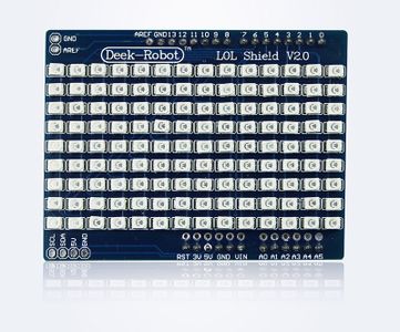

Hello world! A friend of mine gave me this little NEW version of the LOL shield which has SMD leds. So i tested it and it doesn't work any different then normal LOLshields. LOL shield stands for LOTS OF LEDS!, as you can see. They are pretty cool and can be used for many things! I will use it to display my house number :)

First we include the library.
There are 9 rows and 14 columns.
#include "Charliplexing.h"
Then we add the row counter
byte line = 0; //Row counter
char buffer[10]; int value;
at void setup() we initialize the screen.
void setup()
{ LedSign::Init(); //Initializes the screen }
at void loop() we display the number 16 in this case. You can play with the bytes to see what happens.
void loop()
delay(100); DisplayBitMap(0); DisplayBitMap(1936); DisplayBitMap(152); DisplayBitMap(144); DisplayBitMap(1936); DisplayBitMap(1168); DisplayBitMap(1168); DisplayBitMap(1976); DisplayBitMap(0);
at void DisplayBitMap(int lineint)
The LOLShield has 9 rows and 14 colums.
{ //int data[9] = {95, 247, 123, 511, 255, 1, 5, 31, 15}; //for(line = 0; line < 9; line++) { for (byte led=0; led<14; ++led) { //increment 0 by one and returns the new value of 0 if (lineint & (1<= 9) line = 0; }
