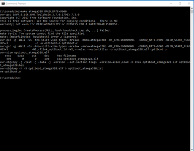

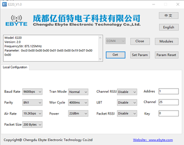

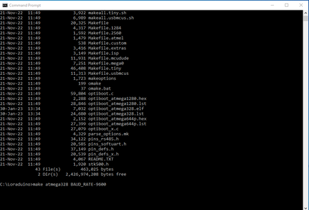

The main trick using LORA modules is that the transmission distance is inversely proportional to the transmission speed. To reach long distances you have to go to low transmission speeds. Because as mentioned before the LORA modules have only 400 bytes buffer and when it is full and the incoming data continues they stuck and the only way to wake them is to switch off the power supply and to power it up. For that reason I set the aerial data transmission higher than the UART speed. The modules can be configured by software tool, which can be downloaded from the Ebyte site under this link. The modules documentation can be found here. On the picture above can be seen the settings I gave. It is important that both modules are set identical. As you can see I set UART speed 9600 bps. To be able Atmega to communicate with the module its bootloader must be set to communicate with this speed. New bootloader must be burned in. I used the optiboot bootloader for that purpose. Under the link you can find all needed information how to compile it and how to upload it in the ATMEGA chip. I compiled it with the command : "make atmega328 BAUD_RATE=9600". How to burn it in ATMEGA328 chip you can find a lot of information - even in this site.

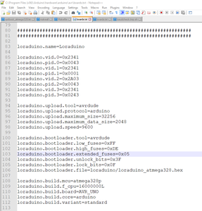

After burning the bootloader, you have to define a new board in the Arduino IDE. I called it Loraduino. You can also at first set the Arduino environment and after that using it to burn the bootloader inside the Atmega328 chip with the help of SPI programmer.
In the file : C:\Program Files (x86)\Arduino\hardware\arduino\avr\boards.txt you have to add new section:
loraduino.name=Loraduino
loraduino.vid.0=0x2341
loraduino.pid.0=0x0043
loraduino.vid.1=0x2341
loraduino.pid.1=0x0001
loraduino.vid.2=0x2A03
loraduino.pid.2=0x0043
loraduino.vid.3=0x2341
loraduino.pid.3=0x0243
loraduino.upload.tool=avrdude
loraduino.upload.protocol=arduino
loraduino.upload.maximum_size=32256
loraduino.upload.maximum_data_size=2048
loraduino.upload.speed=9600
loraduino.bootloader.tool=avrdude
loraduino.bootloader.low_fuses=0xFF
loraduino.bootloader.high_fuses=0xDE
loraduino.bootloader.extended_fuses=0x05
loraduino.bootloader.unlock_bits=0x3F
loraduino.bootloader.lock_bits=0x0F
loraduino.bootloader.file=loraduino/loraduino_atmega328.hex
loraduino.build.mcu=atmega328p
loraduino.build.f_cpu=16000000L
loraduino.build.board=AVR_UNO
loraduino.build.core=arduino
loraduino.build.variant=standard
this must be added also to the same file located in : C:\Users\YOUR user\AppData\Local\Arduino15\packages\arduino\hardware\avr\1.8.6

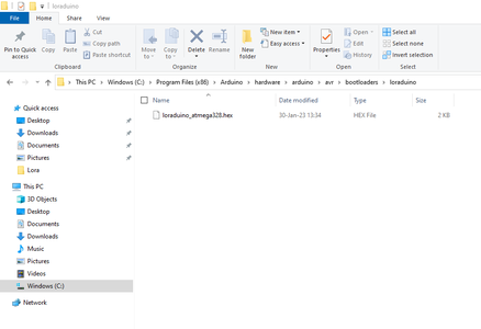

The new compiled bootloader with the name listed above "loraduino.bootloader.file=loraduino/loraduino_atmega328.hex"
must be placed in C:\Users\YOUR user\AppData\Local\Arduino15\packages\arduino\hardware\avr\1.8.6\bootloaders\loraduino
and here:
C:\Program Files (x86)\Arduino\hardware\arduino\avr\bootloaders\loraduino
If everything is set correct your board shall be accessible by Arduino IDE and you can burn the bootloader using it.
