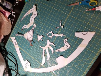

Step 3: Cut Out Basic Details
Thankfully the design is a mirrored image so you only really need to cut up one side of the pattern.
Make sure you take the time to do this step carefully! These are your stencils.
Use the stencils to cut your craft foam. Color doesn't matter, but I always like to use light colors since they are easier to cover in general.
It's easy to cut through multiple layers of craft foam with a good knife. Make sure to use a sharp blade. Keep those cuts clean! Do not rush!
**** Don't throw the paper pieces out if you want to add dimension to the shield. You'll use those to cut the next layer of details like the raised triangles and the bolt type circles around the frame.
**The frame/outline pieces are going to be made from multiple sheets of foam, unless you can get your hands on a large enough sheet/roll of craft foam. Be aware of where the seams are! They need to fit together really well so try to use the factory cut edge as much as possible.

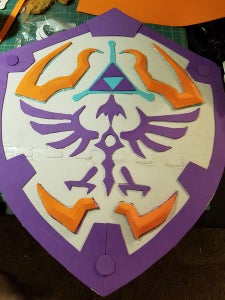

Step 5: Start Putting This Thing Together!
1) Put everything down first before you do anything! Arrange the craft foam accordingly and pin down/tape/whatever temporary method you want to use. You could always graph it out to make everything exact, but I just went with my gut and what I thought looked good.
2) Mark it up! Trace around corners, weird curves, etc. You just spent forever getting it to look the way you want. These guides will help you keep it that way!
3) Brush on that sweet sweet adhesive. Make sure you get the edges or else things can start to curl up on you and we don't want that.
*I always keep as much as I possibly can pinned while gluing this stuff down. I kind of work the pieces in sections to keep it smooth and make sure I cover everything.
Step 6: Optional: Adding More Detail
This is when you can choose whether or not you'd like to add those other detail layers.
Follow the same steps using the paper patterns you have. (Happy you didn't throw them out?)
For the orange detail, I lightly scored the lines on the pattern to allow the foam to get that nice sharp shape and keep it from looking wonky.

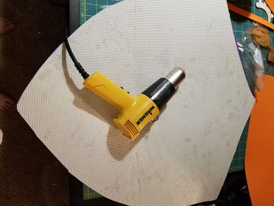

Step 7: Add a Little Heat to Curve the Shield
Add a curve to the shield by slowly using your heat gun on the back. This keeps as much heat away from the detailing and adhesive as possible. You don't want stuff moving around.
The amount of curvature you want is all up to you. If you don't want any, skip it.

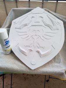

Once you are happy with the look and curve of the shield, grab that Plasti-Dip and and hit the front with few even layers, let dry between each coat. I also did the back twice and the sides as well. This gives it a nice protective shell. If you do get a few lumps and bumps between layers, it can be sanded down once dry.
*Plasti-dip isn't vital, but I highly suggest it
Step 9: Prime and Paint!
After the last layer of Plasti-Dip dried, I covered my shield in 4 coats of primer on the front and on the sides. I know the back isn't going to be seen much, so I just gave it 2 coats.
Paint away and add a coat of clear sealant (I use Kyrlon) to ensure there's no paint crackage!
I like to hand paint my projects with acrylic paint, which can sometimes take forever to get full coverage, but it's usually worth it. Spray Paint is an option, just make sure you tape off really well. If using spray paint, you might want to spray everything before you glue it down, but foam to foam contact is really the best hold for the adhesives. If your paint cracks and peels, things will start to fall apart in your hands pretty quickly (I learned this the hard way).
