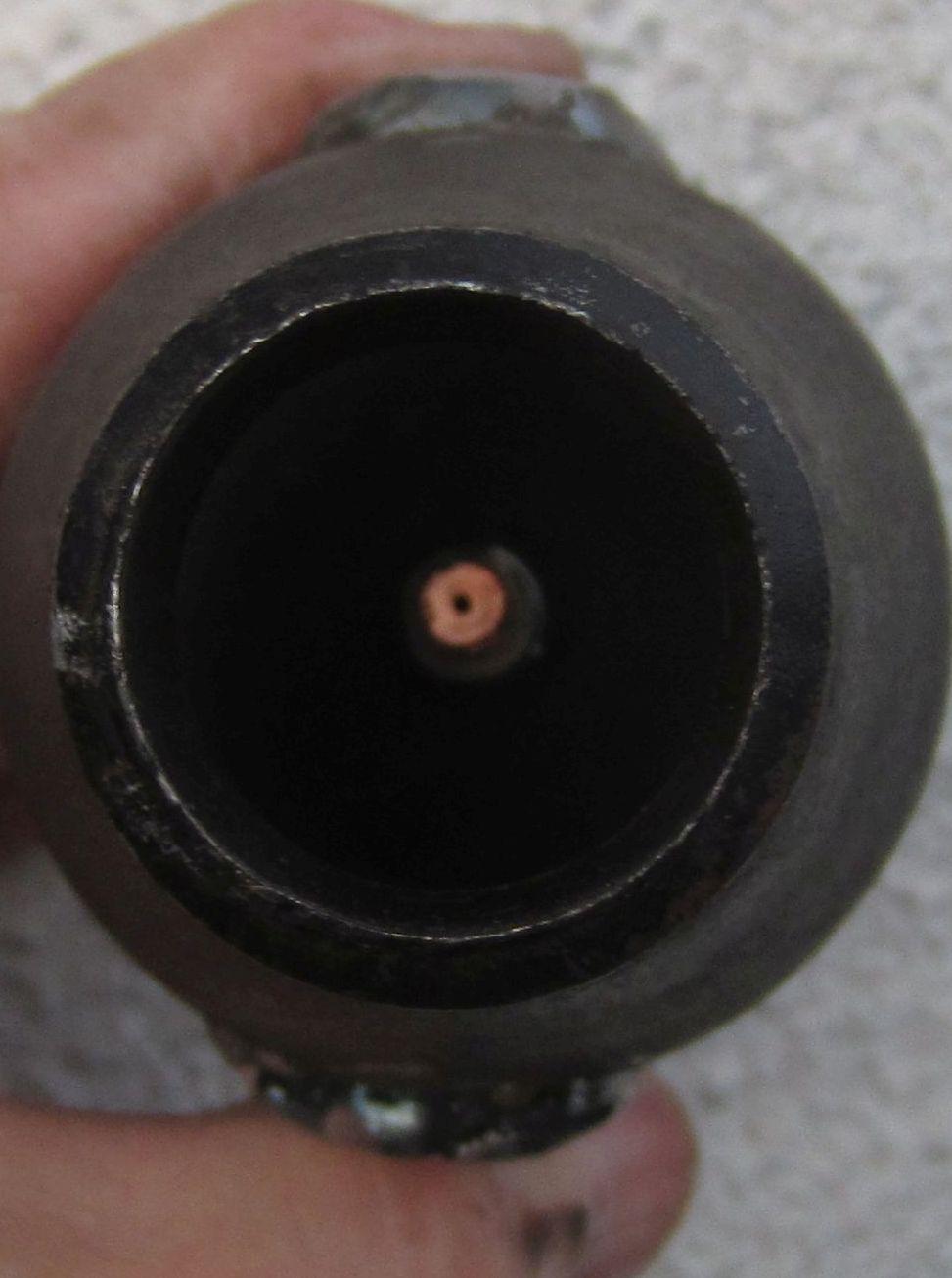

I decided to build my own venturi seeing as none were available locally in South Africa.
I started off with a 1 inch to 2 inch concentric reducer and welded a U bracket on the wider end. This was drilled out to 10mm seeing as I dont know what size and pitch the bicycle axle was. The axle had a 5.5mm bore and so it was tapped M6 on the one end for the MIG jet and drilled out to 8mm for the 90 degree hose barb.
Only the hose barb was brazed. The jet might need to be up sized to a 1.2mm orifice so I left it threaded with teflon tape.
A bicycle axle nut was sliced in half to fasten the bulkhead and make it adjustable if need be.
The air choke disk is 2mm steel plate which I spun on the lathe to get it smoothly concentric. I tapped the center hole with a 1/8 BSP 28 tap and it turns freely on the axle.
