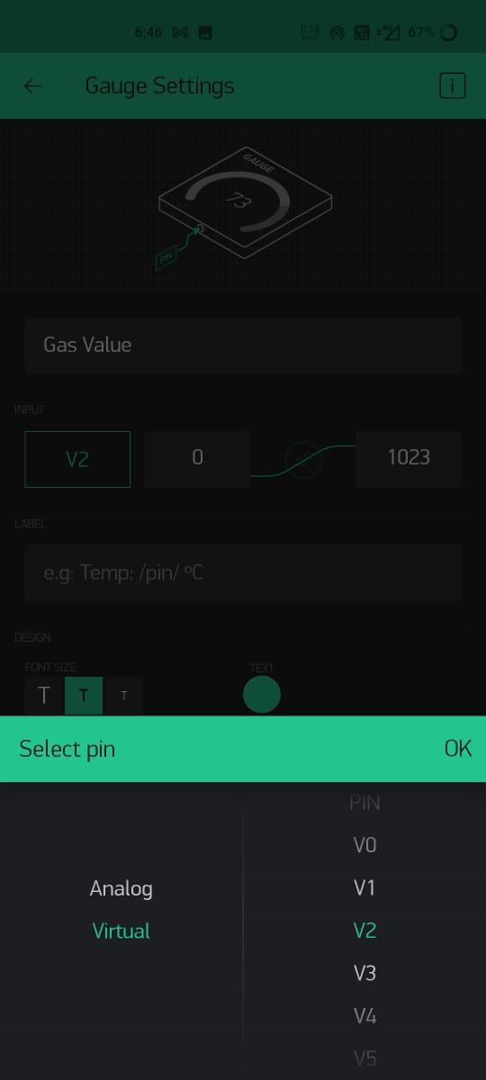

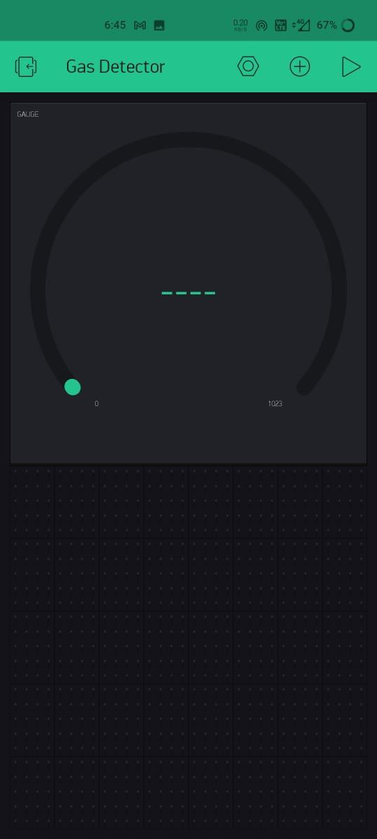

  7. Add gauge using Widget Box.
  8. Gave name to the Gauge as "Gas Value", Select Pin > Virtual > V2, Push > 1Sec.
  9. Add Notification using Widget box.
  10. Now Application Setup is done.
