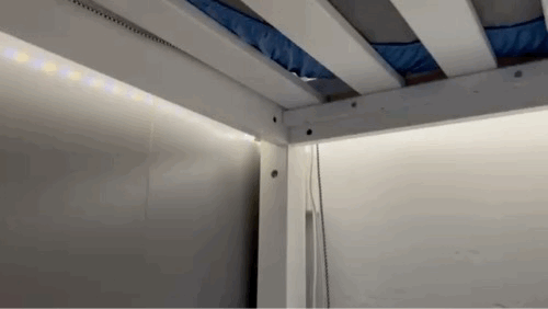

I managed to get this working with an ESP32 D1 Mini with use of MQTT and programmed in the Arduino IDE! It was a fun project and it is still not done.
It can receive home assistant commands via MQTT and is capable of doing effects as well. I still need to program the effects though...

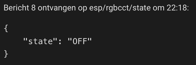

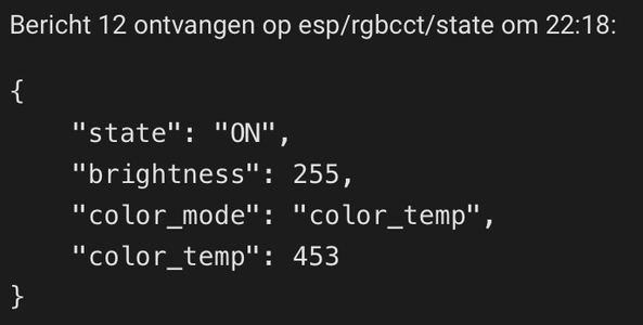

Step 3: Understanding the JSON Format
The JSON format is very important. This needs to be structured exactly like the picture shows. We need to make a nested JSON doc in the Arduino code for the colour setting (I will come back to this later). The messages above are the status data send by the ESP32 MQTT device. You can easily read it via the MQTT integration in home assistant.
The message with the most data in it, is not a status message. This is the discovery payload send by the ESP32 to make it discoverable by home assistant. This has to be done in order for home assistant to add this device as an entity. The code that makes the ESP32 do this, is shown in a picture as well.
