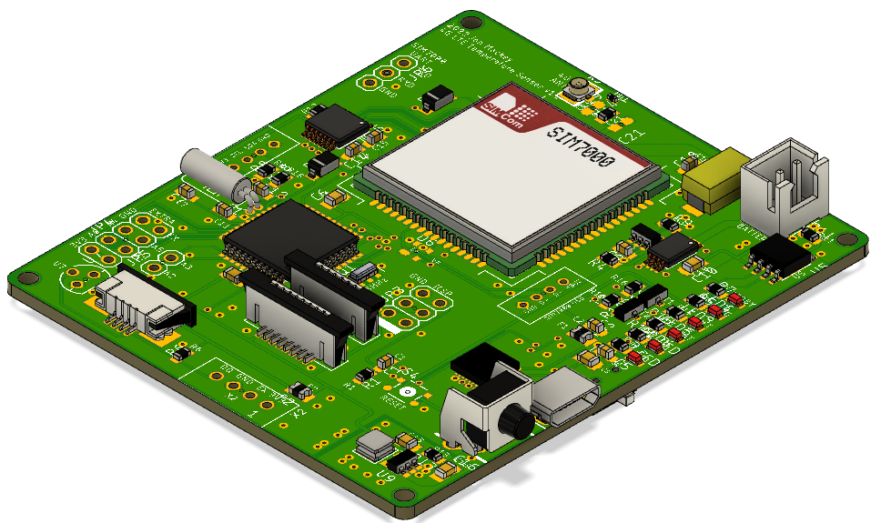

This project is made up of 4 boards.
  • 4G LE Sensor - A 60x70mm board containing the microcontroller, SIM7000, UART, and battery charger.
  • Display - A 35x35mm board containing a 240x240 1.3 inch color TFT ST7789 display.
  • 5 button - A 35x34mm board containing 5 buttons in a cross pattern.
  • 4 port RJ11 - A 20x60mm board used to connect up to 4 DS18B20 temperature sensors using telephony RJ11 4P4C connectors.
The 4G LE sensor board’s connection to the SIM7000 is roughly based on the reference design found in the SIM7000 hardware design document. The mcu is an ATmega644PA. The display and 5 button boards are boards I designed for other projects that meet the minimal requirements of this project. All of the boards connect to the main board using 1mm pitch flat cables.
My original design for the 4G LE Sensor board used four 2.5mm audio jacks to connect the temperature sensors. I decided to move these connections to a separate board that uses RJ11 connectors to make it easier to integrate into the case. An advantage of RJ11 connectors is they eliminate the possibility the signals will be shorted when when connecting the sensor.
As noted, the AVR microcontroller is an ATmega644PA running at 3.3V, 8MHz. This microcontroller has two serial USARTs, one SPI interface, and one I2C interface. The display is connected to the SPI bus. One of the serial USARTs is connected to a USB to TTL serial chip, the other connects to the SIM7000. The I2C interface isn’t used but is exposed if needed. SPI sensors could be added by using the pins on the board’s ICSP connector. All of the unused ATmega644PA pins are exposed via headers. The SIM7000’s USB port is also exposed for future use.

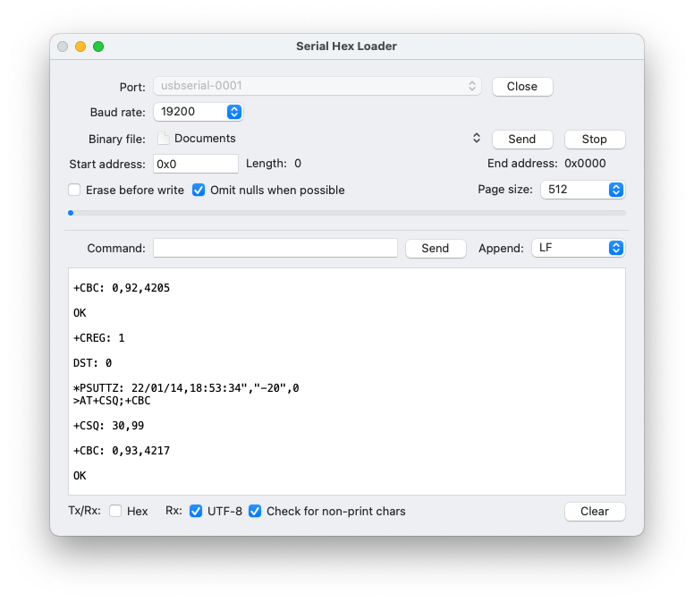

- SerialHexLoader - used to debug and test the SIM7000 serial connection. The app name is a bit misleading. None of the SerialHexLoader loader features are used. I’ve been adding utility code to this app for use by various projects. For the LTE 4G Sensor project primarily the menu containing AT commands and manually typed commands are used. Some of the AT commands in the menu are SIMCom specific.
Serial Hex Loader AT
The command and the response is displayed in the SerialHexLoader log window along with any unsolicited responses from the SIM7000. The screenshot below is of the commands periodically sent to the SIM7000 (anything with a '>' prefix.) The time in the log (*PSUTTZ) and connection status (+CREG) are examples of unsolicited data from the SIM7000. All are used to update variables in the LTESensor instance.
Serial Hex Loader

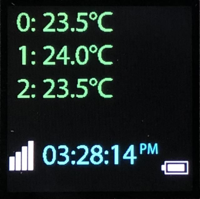

As noted in the boards step, the UI consists of a 1.3 inch 240 x 240 display with 5 buttons in a cross pattern; up, down, left, right, and enter.
There are two main panels, Info and Settings. When the board starts up and after waking from sleep, the Info panel is displayed. The Info panel lists the current temperature of each sensor and whether it’s in range (green text) or out of range (red text.) The info panel also displays the local time, signal strength in bars, and a battery level indicator icon in the shape of a battery.
Info Panel
From the Info panel you get to the Settings panel by pressing the up button. From the Settings panel you can activate or deactivate the alarm, set the time format, and set either Celsius or Fahrenheit as your temperature unit. There are also two sub panels, one to set the PIN and another to display alarm settings.

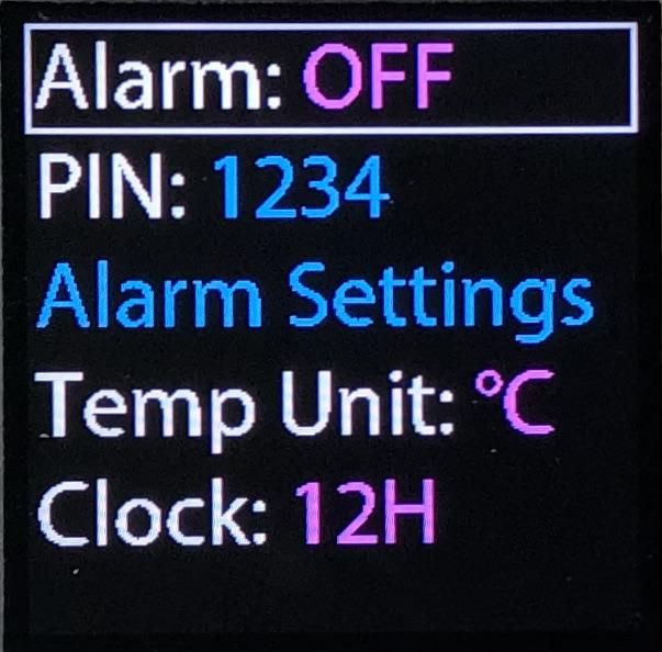

To activate or deactivate the alarm, move the selection frame to Alarm using the Up/Down buttons and then press either the left or right buttons to toggle between on (alarm active) or off (alarm inactive.) All changes are immediately saved.

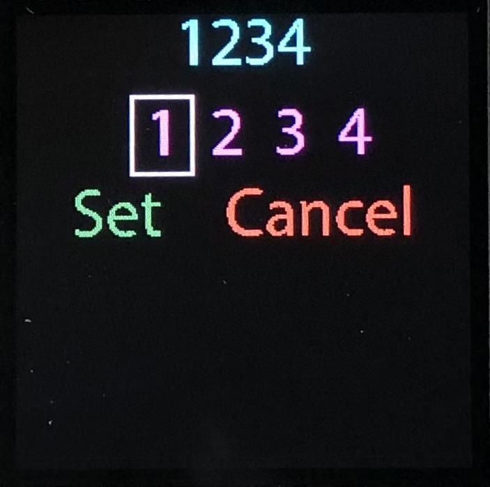

The 4 digit PIN is used to validate a received SMS setup command. To edit the PIN move the selection frame to PIN using the Up/Down buttons, then press the center Enter button. Pressing Enter will display the PIN editor. To change any of the PIN digits, move the selection frame to the digit to be changed using the Left/Right buttons, and then press the Up/Down buttons to increment or decrement the digit. To save the new PIN move the selection frame using the Left/Right buttons to Set, then press Enter. To cancel the PIN edit, move the selection frame to Cancel and press Enter. When you exit the PIN editor you will return to the Settings panel.
PIN Editor Panel

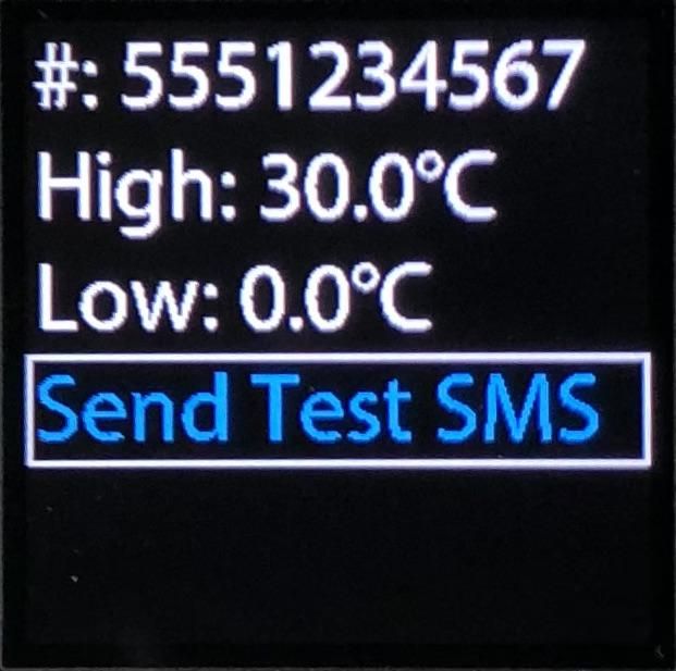

The Alarm Settings displays the current alarm settings, and can optionally send a test SMS to the target phone. To display the Alarm Settings panel, move the selection frame to Alarm Settings and press Enter. The top 3 lines are static, they are for information only. The first line displays the alarm phone number to be sent an SMS text for alarm events. This is also the only number that is allowed to remotely change the alarm state as well as request the current state of the sensors board (alarm state, temperatures, signal strength, and battery level.) The next 2 lines display the alarm high and low temperature settings. The last line, when selected and Enter pressed, will send a test message to the alarm phone number. To return to the main Settings panel, press the Up button until the Settings panel appears.
Alarm Settings Panel
Settings Panel end

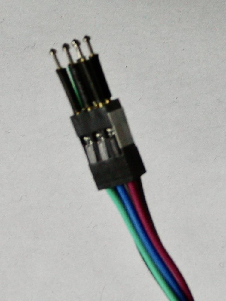

- The LTE 4G Sensor board has several optional headers and connectors. The pictures below show the empty pads of the optional items. I provided pads on both sides for the reset button. For the case I designed, it makes sense for the reset button to be on the underside.
Board FrontBoard Back
For the initial LTE 4G Sensor board voltage test you can power the board using the micro USB connector with no other boards connected. Verify that you get 3.3 volts across the ICSP pads shown below. Unplug the USB connector prior to burning the bootloader in the next step.
ICSP

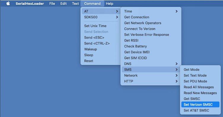

The board requires an activated and provisioned SIM card installed in order to operate. I decided to use Verizon ThingSpace. See my note at the end of this Instructable regarding the possible issues you need to consider when selecting an IoT provider.
Once the SIM card is installed on the board you need to set your IoT provider's SMSC address. For Verizon ThingSpace the SMSC is 9036384682, and would be set by sending AT+CSCA="+19036384682",145 to the SIM7000 via the same USB connection used to load the sketch. The baud rate of the USB serial connection is 19200. You can also perform this step by using my SerialHexLoader utility and choose Set Verizon SMSC from the AT SMS submenu.
Set SMSC

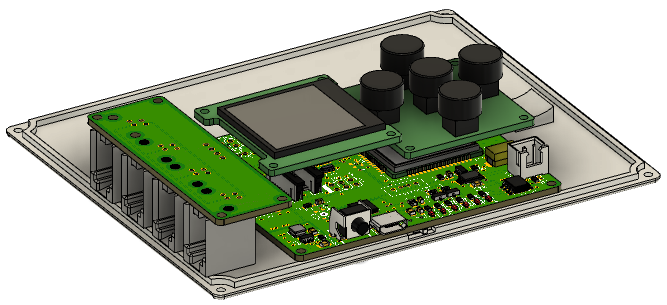

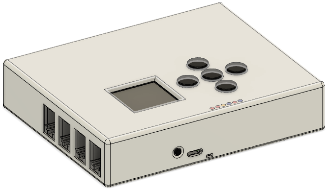

Step 8: The Case and Assembly
The case was designed using Fusion 360 in conjunction with the Eagle feature where you can upload your board(s.) Many of the parts used did not have 3D representations so these were created in Fusion 360 and imported into my library on Eagle. I found it’s very much worth the effort.
Example of some of the 3D parts I created using Fusion 360 using the 2D drawings provided by the parts vendors:
3D Parts
Taking the time to do this allows you to place your boards in the case design without having to create a component representing its geometry and location. If you update the location of a part in Eagle you just sync the changes with Fusion 360.
Boards in Case
Boards in Case

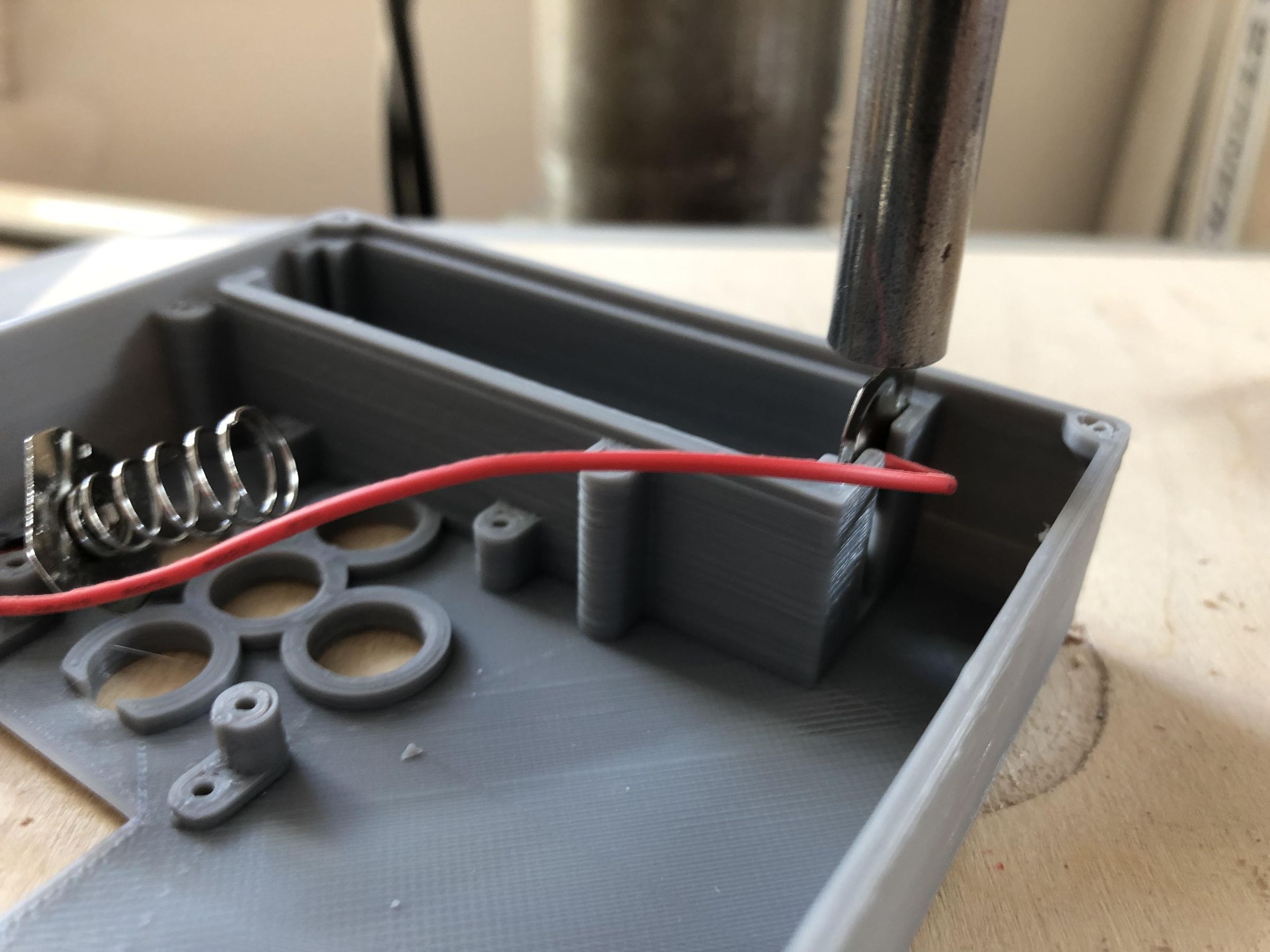

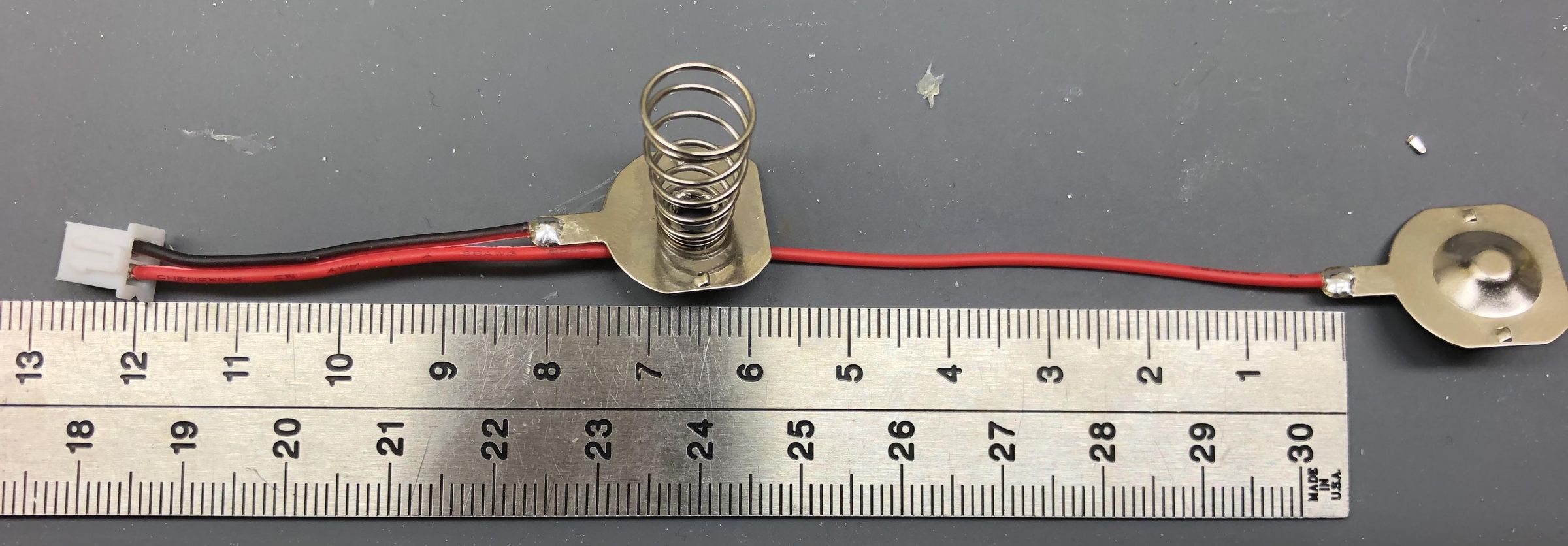

The Power Cable Assembly:
Battery Cable Assy
Attach female XH2.54 crimp pins to one end of 28AWG wire pair, . Insert the pins into the XH2.54-2P socket housing as shown above.
Cut the wires to length as shown above. Solder the red wire to the battery plate without a spring. Solder the black wire to the battery plate with a spring. Fold the solder tabs on both plates back so they’re flush with the plate back.
Battery Cable Assy
Slide the plates into the slots in the case by pushing straight down with even pressure. I chuck a short piece of 10mm shaft in my drill press and use it as an arbor press. The plates bend very easily. Using a drill press ensures the pressure is straight down.

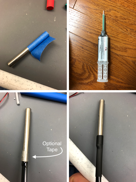

Step 9: Sensor Assembly
I decided to build my own DS18B20 sensor assemblies. You could buy prewired DS18B20 assemblies and splice on an RJ11 4P4C connector. Be aware that nearly all DS18B20 ICs in a TO92 package on AliExpress and Amazon are counterfeit. Without testing the ICs you can generally tell they’re counterfeit by the price. Any small quantity price for a DS18B20 IC less than $5 is most likely counterfeit. I’m using ICs bought on AliExpress for about USD 0.60 each including shipping with tracking, so I know these are counterfeit. Some counterfeits perform better than others. Very good documentation of the DS18B20 counterfeits issue can be found here.
Materials:
  • 6x50mm Stainless Steel Casings source AliExpress
  • DS18B20 sensors in a TO-92 case
  • 4 conductor phone wire. I bought very long RJ11 6P4C cables (ordinary RJ11 telephone to wall cables) and cut them to size replacing the connectors with the smaller RJ11 4P4C connector. See the Maxim 1-wire design guidelines, in some cases Cat5e cable would be a better choice.
  • Epoxy that accepts a mixing nozzle such as the J-B Weld brand.
  • Epoxy Adhesive Mixing Nozzle Tip source Amazon
  • 6mm heat shrink tubing
  • 2mm heat shrink tubing
  • Optional: 3M 3090 10mm wide double stick tape

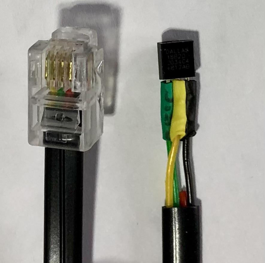

Build the Cables:
Solder the sensors to the phone wire as shown below.
The DS18B20 is shown with the flat side facing the camera, G Y B.
As shown below the color order on the RJ11 in the position shown is Y G R B.
The red wire is not used.
RJ11 Sensor Wiring

- Wake up the LTE 4G Sensor by pressing and holding the power button for 2 seconds.
- If successful, a single dashed line will be displayed and then be replaced with the first temperature reading in about 10 seconds.
- Repeat the above for the remaining sensors.
Note that there is no correlation between the index number displayed in the Info Panel and the RJ11 sockets. The indexes are essentially assigned randomly, possibly based on the unique serial number of each sensor.
Add the Stainless Steel Casings:
Once the sensors are working, encase the sensors in the casings.
- Mask off the open end of each casing with painter's tape
- Replace the cap on the epoxy syringe with a mixing nozzle.
- Extrude a small amount of epoxy till the mix is consistent.
- Fill each of the casings by inserting the mixing nozzle and injecting epoxy in each.
- Insert the sensors into the casing, working out air pockets by gently inserting and retracting until the sensor is fully inserted.
- Top off the area around the top of the casing as needed with additional epoxy.
- Carefully wipe any epoxy on the wire after it exits the casing and set the assembly aside to cure
- Once cured you may need to carefully snip off any epoxy you weren’t able to wipe off in the previous step.
- Remove the painters tape.
- Optional: For a more watertight fit, apply a 10mm strip of double sided tape around the casing rim.
- Cut 6mm heat shrink tubing into lengths approximately 3.5cm and slip them over the casing so that only 10mm is in contact with the casing.
- If you added the optional double sided tape, press the tubing onto a portion of the tape just to keep it in place.
- Using a hot air gun, shrink the tubing.

Before you rush out and build this board or attempt to use many of the SIM7000 modules sold in the US, you should be aware of the issues you may encounter.
In the US they have lots of companies that will sell you SIM cards for IoT projects, but they fail to tell you that most of the big cellular network operators are picky about what equipment they allow on their network. The International Mobile Equipment Identity, or IMEI, is the unique 15 digit number that uniquely identifies your specific modem such as the SIM7000. In the US, your goal is to have your IMEI registered with one of the major cellular network operators, such as Verizon. When I say cellular network operator I'm referring to the company that owns the towers.
When any modem module of any manufacturer tries to connect to a network, it’s the combination of the modem’s IMEI and the SIM card that needs to pass a network’s inspection. Your SIM card isn’t going to help you if the IMEI of the module you bought on Amazon isn’t certified and registered. You can self register an uncertified board, but Verizon and AT&T want you to go through a certification process that requires you to, among other things, send your board to a 3rd party for EMI testing. They also prefer you to be a company and have insurance. Even though I designed my own board, I was able to avoid having to do this, but the route I took probably isn’t repeatable.
Caveat: I was told by Verizon Technical Support that there have been cases where hobbyists were able to register a limited number of their IMEIs for a fixed duration (assuming at some point you would fully certify.) I didn't go this route so I can't verify that it is still possible. At the time, as described, it seemed rather onerous.
The end result of certification on Verizon is getting your IMEI onto Verizon’s DMD. The DMD is a database that Verizon’s network uses to determine if they will allow a device to connect, regardless of the SIM provider. Once on Verizon’s DMD your board will connect nearly everywhere in the US. Before you purchase a SIM7000 module you should ask the seller if the IMEI is registered with the network operator prevalent in your area. Even though the SIM7000A is a Verizon-approved module, the board it’s mounted on may not be certified, and that’s the key distinction.
I initially tried a Hologram SIM but for my needs, only SMS texts, the Verizon ThingSpace SIM is a less expensive option. As of now, including taxes, a ThingSpace SIM basic plan is $1.60 per month which includes 100 SMS texts and 1MB data.
ThingSpace technical support is very helpful as far as resolving provisioning and website access issues. For low level cellular network related technical questions they will listen to you and offer to forward your questions to other groups, and after several weeks you might get an answer, but don’t count on it. Their definition of things may be different than yours as well. For instance “connected” for them means you’re connected to their IP network (which my board doesn’t use.) For me connected is when the SIM7000 passes network registration with the local tower. Network registration doesn’t appear to be something Verizon can easily detect, at least not with the tools Verizon technical support has easy access to. This led Verizon to initially claim the problem I was experiencing was with my board, because from their perspective, I wasn’t connecting. The problem turned out to be a provisioning issue. After a few weeks they fixed their provisioning issue and my board was able to connect.
An issue I encountered after my board was able to connect was not being able to send SMS texts. The published Verizon SMSC address (the server that routes SMS texts), doesn't work with ThingSpace SIMs. This was an example where ThingSpace technical support was not able to provide the information I needed (although they probably can now after I let them know what fixed the issue.) I determined the correct SMSC by decoding an incoming SMS in its PDU format. See step 7 for this SMSC address and how to set it.
