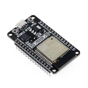

  • 1x ESP32 DEVKIT V1

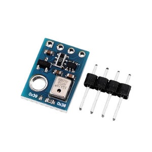

  • 1x AHT10 High Precision Digital Temperature and Humidity Sensor I2C Module

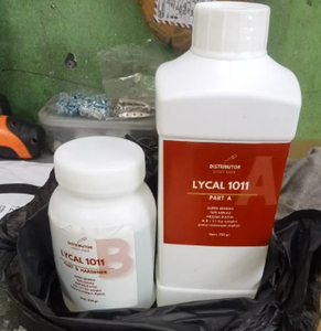

  • Epoxy Resin + Harderener

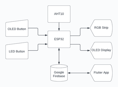

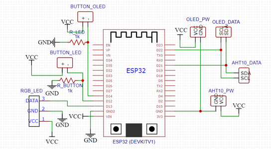

Step 1: Design the Electrical Circuit
We utilize an adapter cable to seamlessly connect to the micro USB port on the ESP32, serving as the primary power source. To establish a clean and effective connection, we use a terminal block that links various components, such as the RGB strip, OLED display, AHT10 sensor, and buttons, to the PCB. For the power distribution, we use Vin (5v) on the ESP32 as the central power source for all components.
The RGB strip data is then directed into IO13, facilitating smooth communication and controlling the RGB color.
For the AHT10 and OLED components, we employ the I2C protocol for efficient data transfer. SDA and SCL are appropriately connected to IO21 and IO22, respectively, ensuring synchronized and reliable communication between these vital elements of our system.
To facilitate user interaction, buttons are integrated into the design. The LED button seamlessly interfaces with IO12, while the OLED button is connected to IO14. This thoughtful input/output pin allocation ensures that the user interface remains intuitive and responsive. We add a pull-down resistor of 1kΩ between the IO and GND. This resistor ensures that the IO pin has a defined voltage level when the button is not pressed.
P.S. For AHT10 and OLED, we use another GND of ESP32 to simplify the PCB circuit.

For the AHT10 temperature and humidity sensor, we use the Adafruit_AHTX0 library, and the programming involves a function called readAHTSensor to capture room temperature and humidity. Both the AHT10 sensor and OLED use I2C, requiring the Wire.h library. The OLED programming involves the Adafruit_SSD1306 library. The OLED displays time, date, temperature, and humidity, and the OLED functions are embedded within other functions, such as readAHTSensor, which includes display.display() to show temperature and humidity on the OLED. The OLED also displays a real-time date and time. We use the NTPClient library to get real-time date and time information, programmed through the void showTime() function. This function displays the date and time in the specified format on the OLED and includes a switch between a sun and moon logo indicated in the if-else statements.

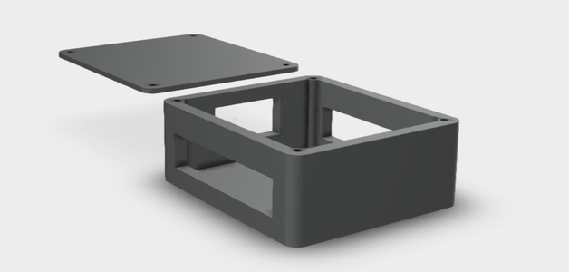

Step 5: Create 3D Printing Case
We use 3D printing with PLA material for the PCB casing. The dimensions are customized to fit the PCB (60 x 65 mm) with a 1 mm gap on each side, and the thickness for this case was around 5 mm. The casing is sealed with bolts; that's why we created the bolt hole in four corners, around 2.8 mm. On the back side, there are holes for a power source cable measuring 30 x 15 mm. The holes on the left and right sides measure 60 x 13 mm for all the components, like AHT10 cables, OLED cables, button cables, and RGB strip cables.
Below is the link to the STL of our PCB case:

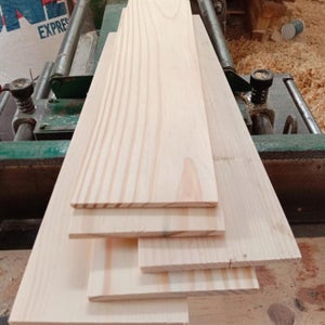

For the overall case, we use wood planks measuring 30 x 9 cm for the top, bottom, front, and back sides. The right and left sides are sized at 9 x 9 cm. On the front side, we create one rectangular hole for the OLED display and two round holes for the buttons. On the back side, we cut around 7.3 x 5 cm (the size is the same as the back of the PCB case) and drilled a tiny hole for the AHT10 sensor. After drilling and sanding the wood, we apply a cream-colored Pylox spray paint. To assemble the pieces of wood, we use wood glue. We put the PCB case in the middle of inside the wood case Lastly, cover it with masking tape to achieve a neater appearance, and you can add a sticker to make the wood case cooler.

In making "CE25" resin, we used 437 mL of epoxy resin mixed with 137 mL of harderener and then poured it into the mold. In the epoxy, before it dries, we put in the knick-knack decorations. Then wait 24 hours to dry completely. After drying, we sanded the resin to make it shiny.

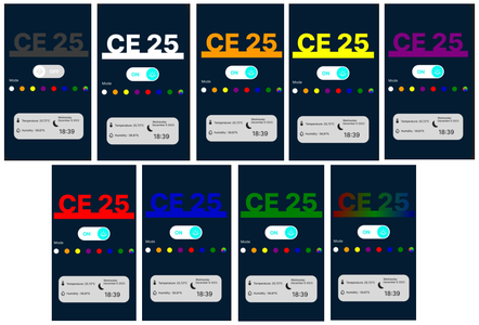

Step 8: Create App
For our Android application, we utilize Flutter for its development. The primary feature of the application is to control the colors of our smart decorative lamp. The app includes eight pre-programmed color presets, and users simply need to tap on one of the color icons to change the lamp's color. Above these color icons, there is a preview section to visualize the selected color for the lamp. In terms of navigation features, our application seamlessly transitions to the next frame based on user actions, such as turning on/off the lamp or changing its color.
On the backend side, we integrate Google Firebase to capture real-time data from the Firebase Realtime Database (RTDB). The data captured from Google Firebase includes changes in each color as well as the on/off status of the lamp. Beyond the configuration features for the decorative lamp, we have added some additional functionalities, such as displaying a real-time clock and temperature/humidity information. For temperature and humidity, we leverage Google Firebase to retrieve data from the AHT10 temperature sensor we use. To showcase real-time clock information, we employ the "intl" Flutter package, which provides advanced date and time formatting capabilities, allowing us to display accurate real-time information in our local region.
