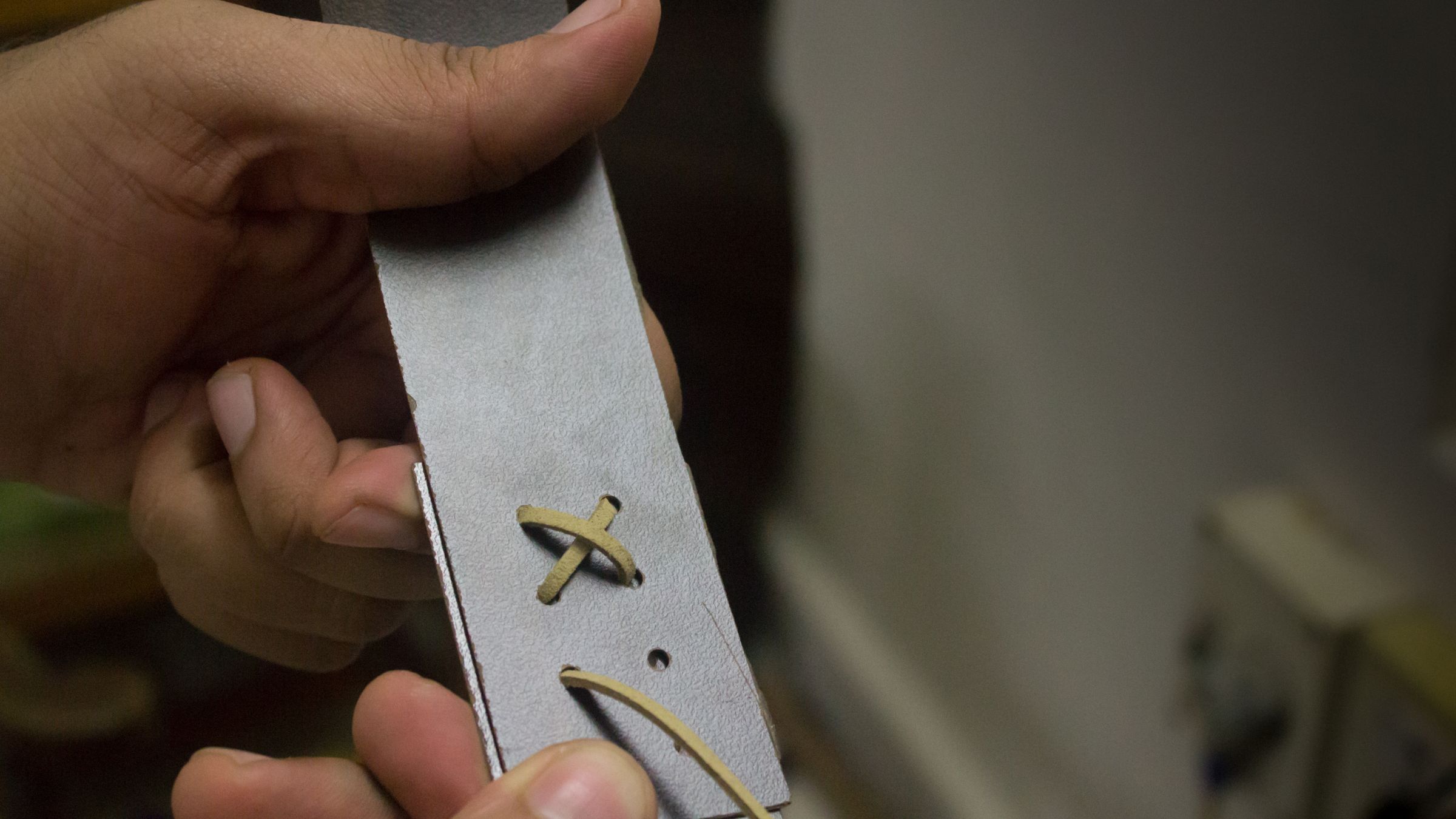

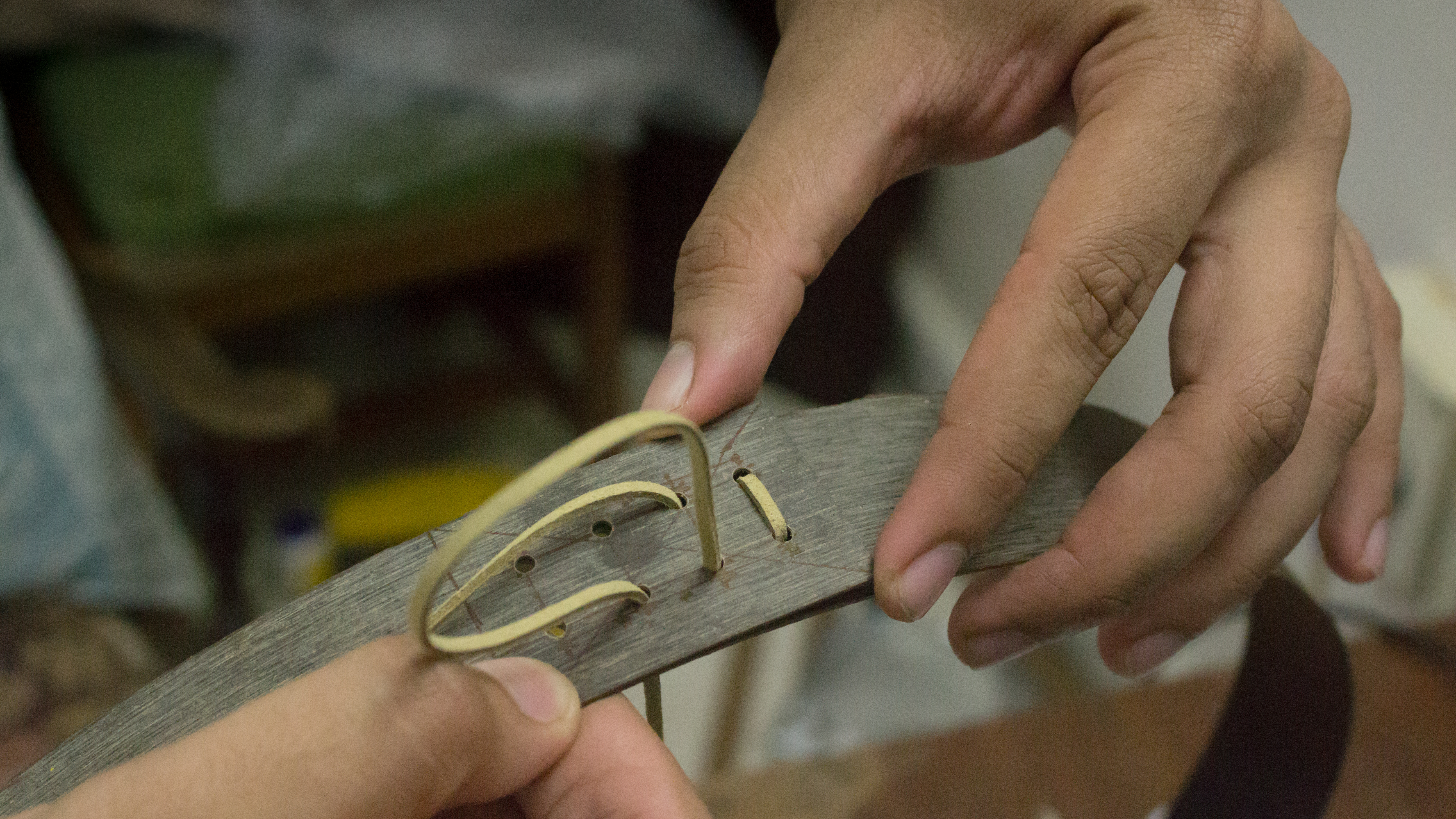

Start by marking the drill holes on the ends of each mica strip using the template attached below. Once the holes have been marked & drilled, bring both ends of the mica strip together such that the holes on each end are aligned. Do this for both of the mica strips which form the two support rings.
Using the leather string, weave a knot between the holes in order to securely join the two ends of the mica strips. Do this for both of the mica strips which form the two support rings. You will now have two Mica support rings: Outer & Inner Ring with a radius of 52 cm & 40 cm respectively.

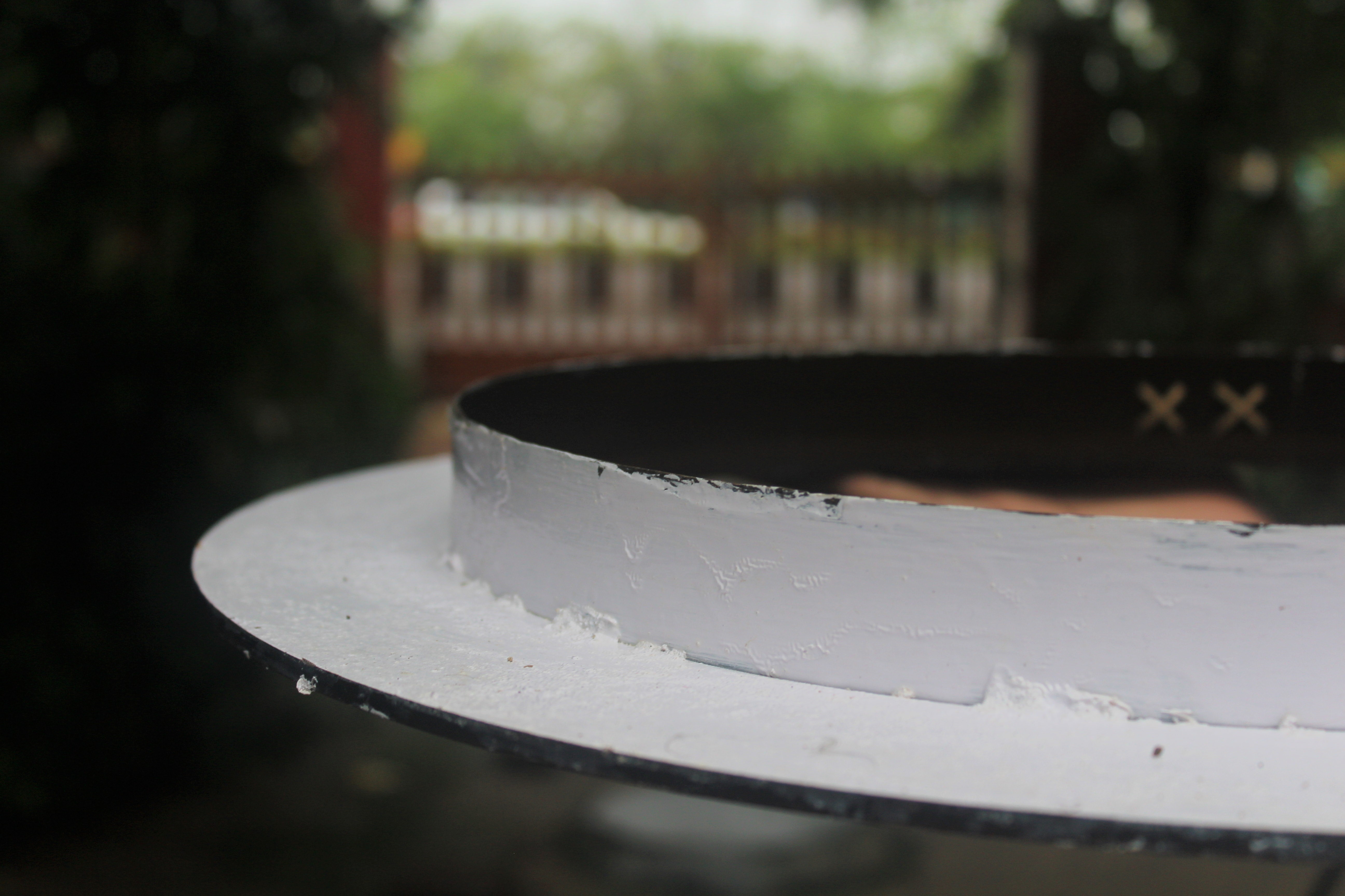

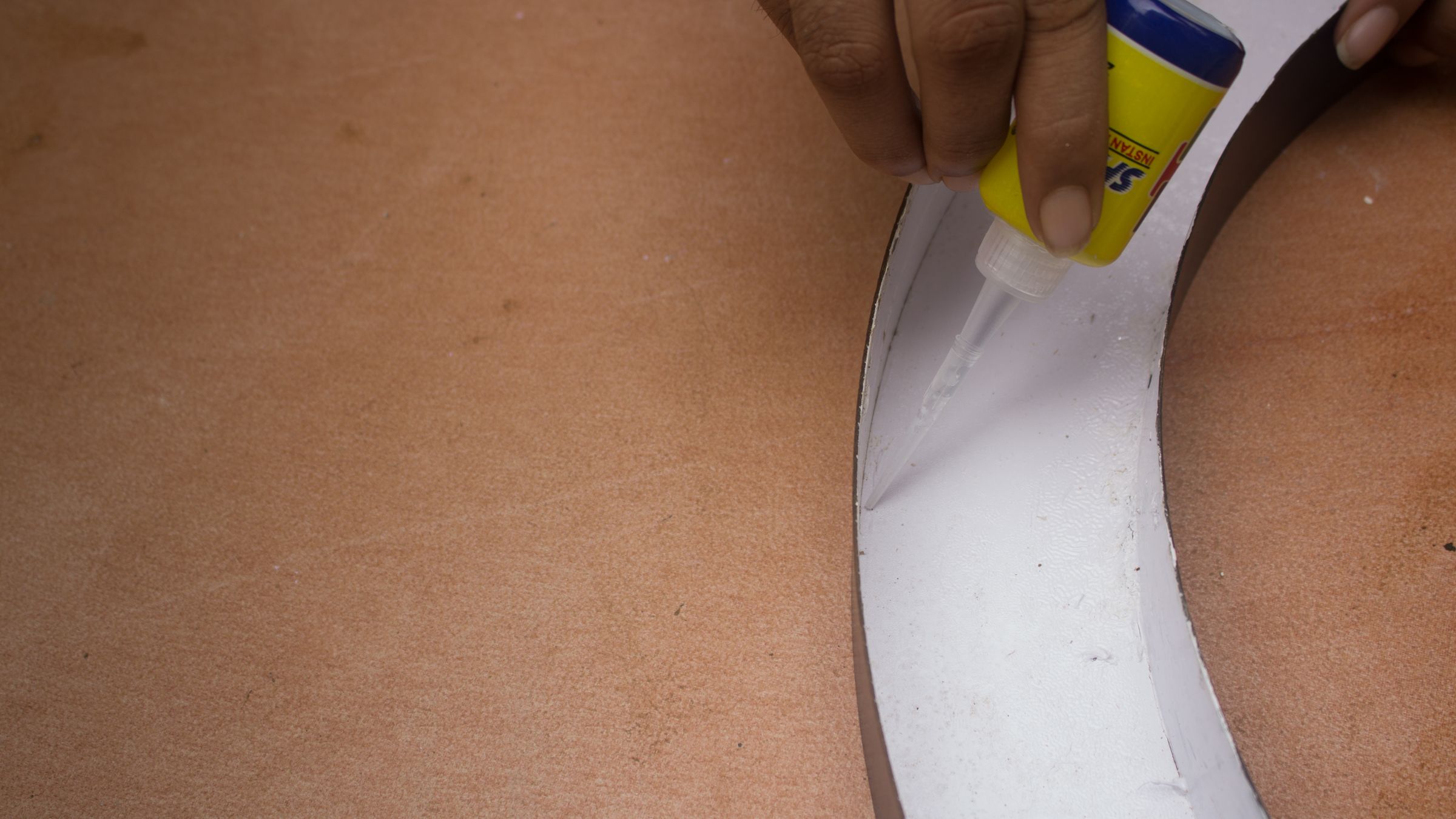

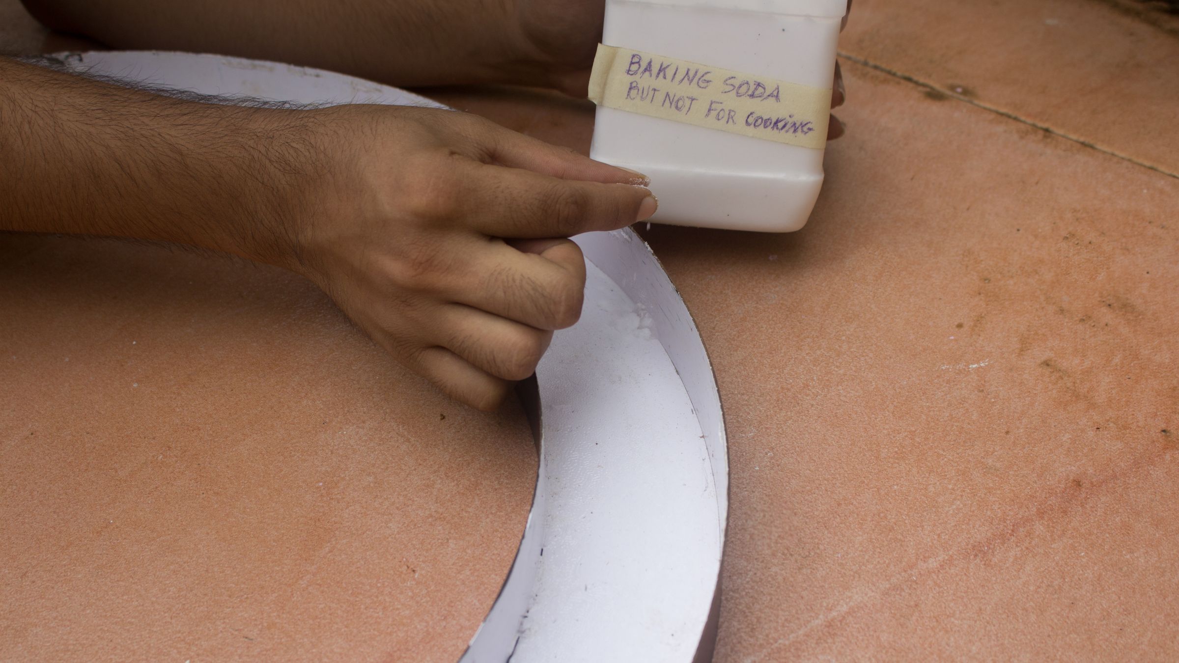

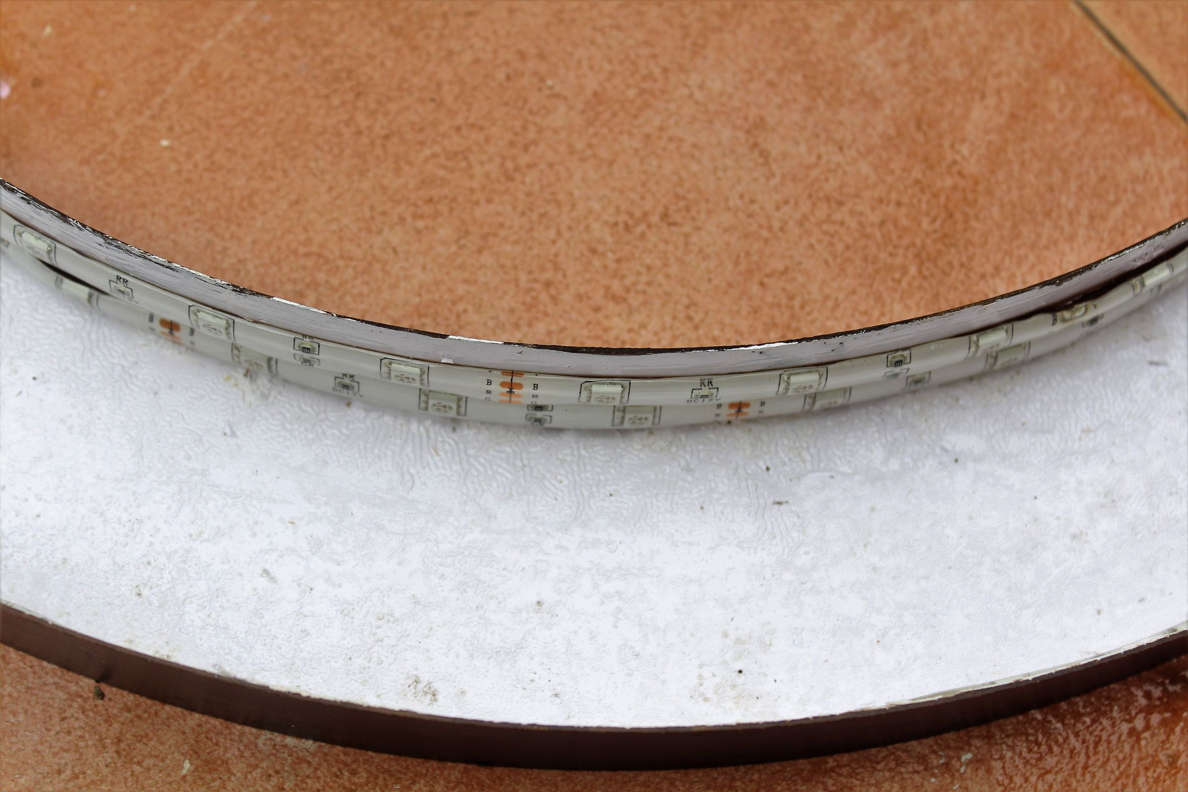

Using a mixture of Super Glue/ Instant Adhesive & Baking Soda, stick the support rings to the inner & outer edges of the MDF Base. Drill a hole for the power & control wires at the bottom of the MDF base.

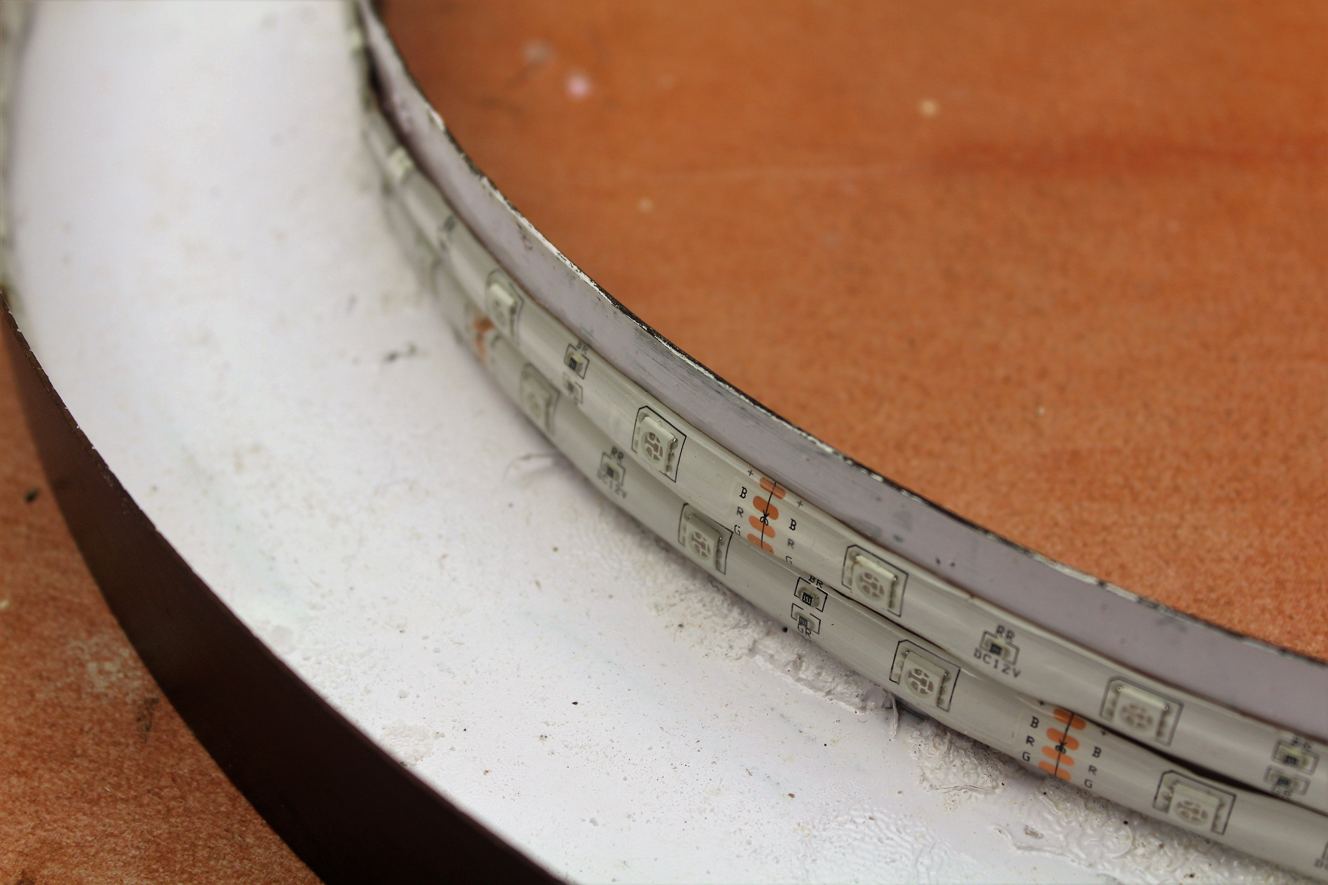

Remove the protective layer from the RGB LED Strip & begin sticking the strip to both support rings. Stick the LED Strip as close to the base as possible. This will ensure that the light is evenly diffused & that individual LED outlines are not visible. Ensure that the 4 wires (Power & Control) are connected to the LED Strip & are routed through the hole made in the MDF Base.

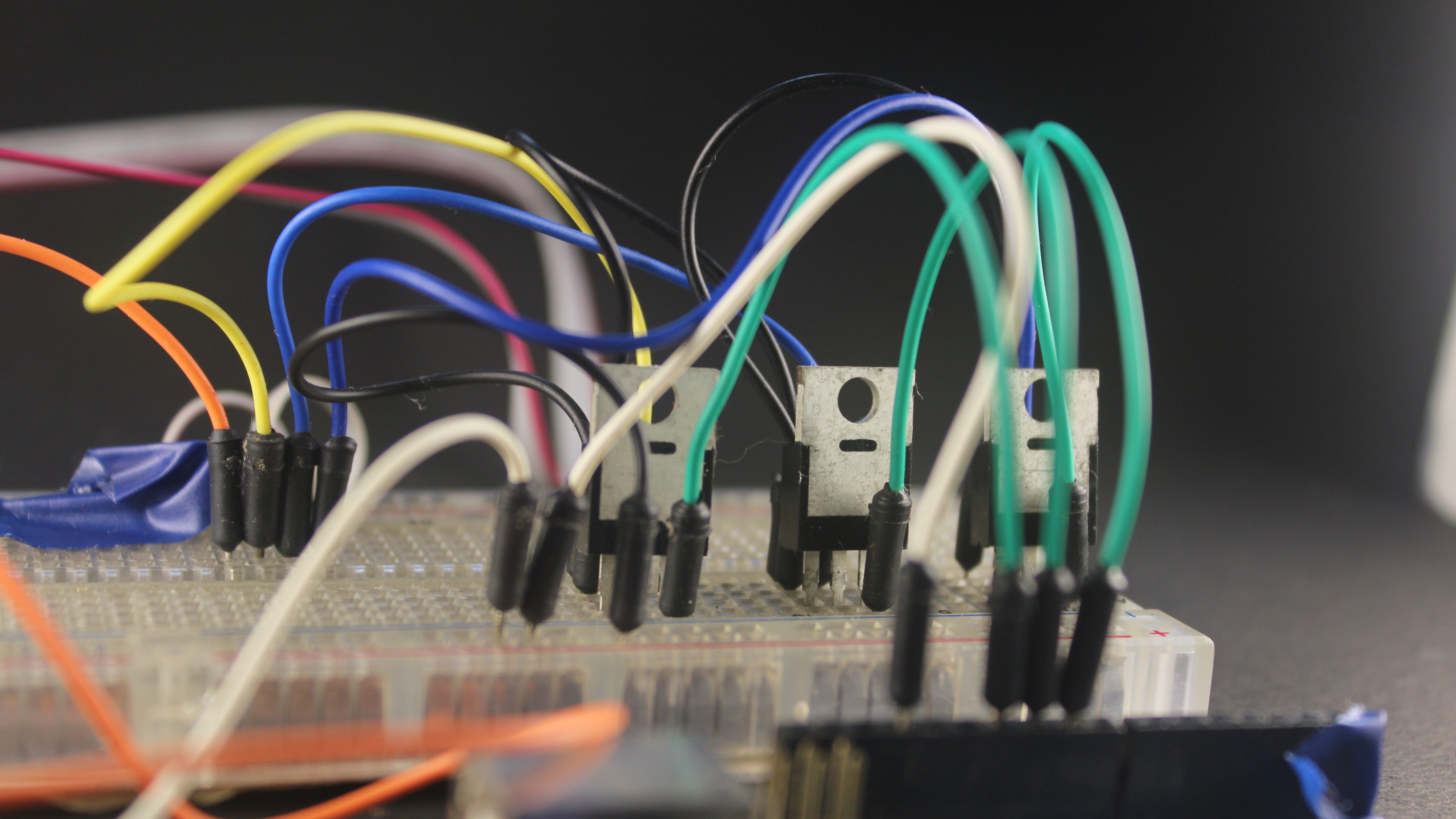

Step 4: Electronic Assembly
The Raspberry Pi uses Wi-Fi to get the location specific time zone & also uses its internal Bluetooth Module to analyze RSSI values of a Smartphone in order to calculate proximity of the smartphone
The Arduino is used to control & test the analog values which control the intensity of the RGB LED Strip. By changing the analog value using PWM we can control the color produced by the LED Strip.
The Arduino can only supply a maximum of 5V, 20mA through its I/O pins. Whereas the RGB LED Strip generally requires a power source of minimum 12V, 1A.
The solution to this is using a MOSFET as a switch. The Gate pin of the MOSFET can be used to control the ON/ OFF state of the MOSFET. The Source pin is connected to LED Strip while the Drain pin is connected to Ground. Each Gate pin of a MOSFET is controlled by a separate PWM pin on the Arduino. The LED Strip has 4 pins: +12V, R, G & B. The +12V is connected to the +12V of the 12V power adapter. The R, G & B pins are connected to Source of each MOSFET respectively.
The Arduino makes it easy to calibrate the colors of the RGB LED Strip. Calibration of the RGB values varies with the manufacturer & model of the RGB LED Strip. If calibration is achieved, the cost can be reduced by using an appropriate Digital to Analog Converter(DAC).
The Raspberry Pi & Arduino communicate using the I2C protocol.
The Eagle CAD files & Schematics are attached below.
