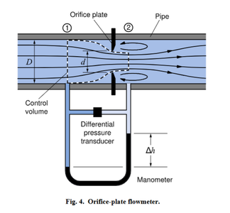

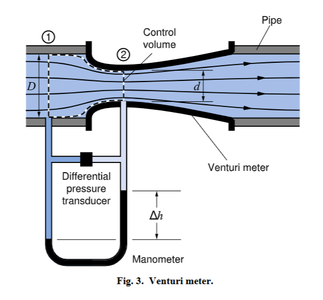

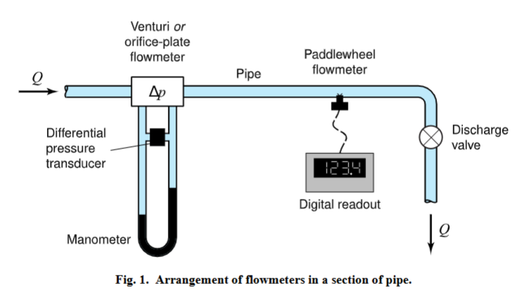

It is important to have a good calibration of a flowmeter because then measurements can be accurate and confounding variables could be eliminated. This experiment calibrates Venturi flowmeters and orifice-plate flowmeters. Analyzing the pressure differentials of each flowmeter allows some experimentally obtained coefficients to be compared with ISO-published values. This way, it is possible to know whether the flowmeter is reliable or not. A paddlewheel flowmeter is also calibrated to provide an electrical output signal for monitoring purposes. This figure depicts the setup of the system. The flow rate is measured using the weight-time method, which measures how long it takes for the water to reach a certain weight. This is a mass flow rate, which can be converted into a volumetric flow rate by dividing by the density of water.
This setup for both the venturi and orifice-plate flowmeters requires a differential pressure transducer. Many of the measurements require reading a manometer, which you are looking at the height difference between the left and right sides of it. There is a main pipe which you have to open and close, where it will range from completely open to partially open. The paddlewheel flowmeter is further along the pipe for extra calibration and observation purposes. LabVIEW will be the software used to collect and store the lab data.

First, make sure the discharge valve is fully closed. This is for the weight-time measurement so that water doesn't leak out of the system. Then, check the mercury levels in the mercury manometer for the venturi/orifice-plate flowmeters. They should be equal but if they are not, slowly open and close the manometer supply valves to get any excess air out of the system.

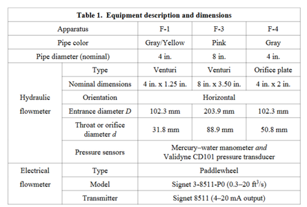

Step 7: Accepted Flowmeter Stats

Step 12: Discharge Coefficient, C_d
Lab Report Q9. The discharge coefficient is mostly constant, staying at around 0.7-0.8. They are close to the ideal value of unity. The ideal value of C_d is 1. By not being 1, there is some error to be accounted for. One potential source is from the manometer reading, especially given that it doesn't stabilize at a single point. Another source of error could be from the flow itself. While waiting until the pipe wasn't vibrating is a good way to know if the flow is laminar or not, it is not a perfect system, especially when the flow rate was reduced.
