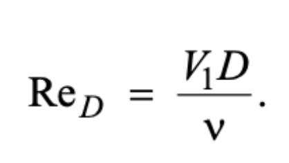

Step 4: Plot of Discharge Coefficient As a Function of the Reynolds Number
The discharge coefficient should be calculate in LabVIEW using the equation in the image above. The LabVIEW should calculate it on its own, but in any case, V is velocity of flow, D is pipe diameter, and v is the viscosity of the water.
