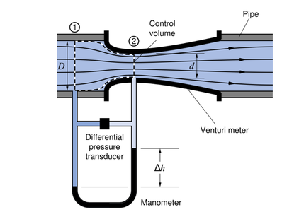

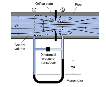

The images above illustrate the two devices used in this calibration practice. The hydraulic flowmeter (Venturi or orifice-plate meter) uses a pressure transducer and differential manometer to obtain pressure difference. The two types of hydraulic flow meters measure pressure at different locations, and each respective location of pressure measurement is shown in the labeled diagrams above. The paddlewheel flowmeter is connected to a transmitter sending a current through a resistor, producing a voltage output. Along with these devices, we will use a weighing tank and the weight-time method as the standard for calibration. LabView software will be used for data acquisition, determining flow coefficients, producing output spreadsheets, and collecting data files.
