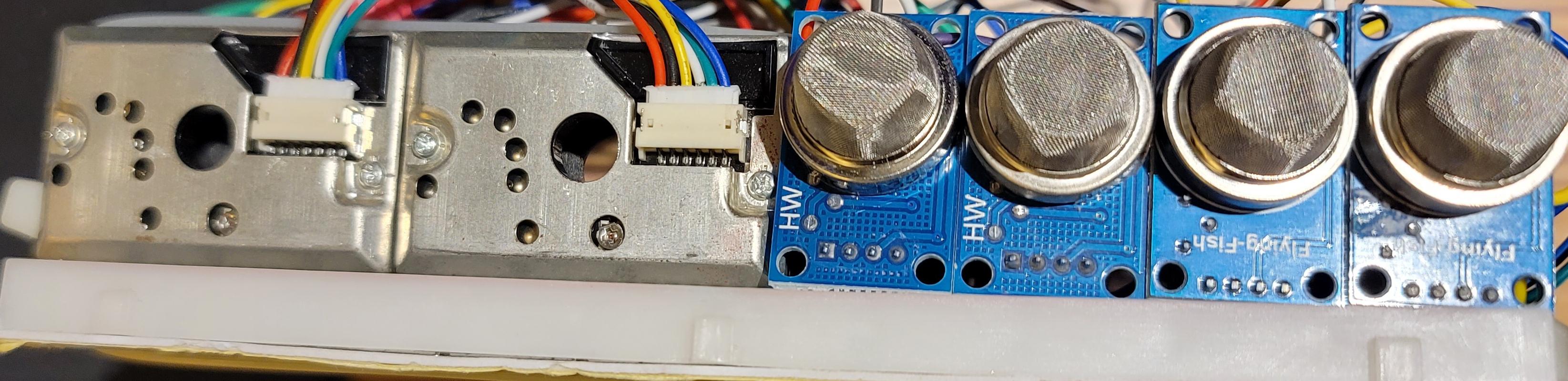

In this project, I will be making a simple air quality measurement device with readily available sensors. For data acquisition and processing LabVIEW by NI is used. The Arduino receives data from the sensors and these values are sent to the computer using a USB port. I have used two of each sensor that can help reduce errors. I have provided the LabVIEW interface and Arduino code so that you don't have to start from scratch!
Note that these sensors are not very accurate, this project can be further improved with better and more accurate sensors!

Step 3: Build the Circuit
Build the circuit on a breadboard as shown in the picture. The connections are made using jumper wires, it is also possible to create the circuit on a Vero board to make the whole setup more compact and ensure proper connection.
