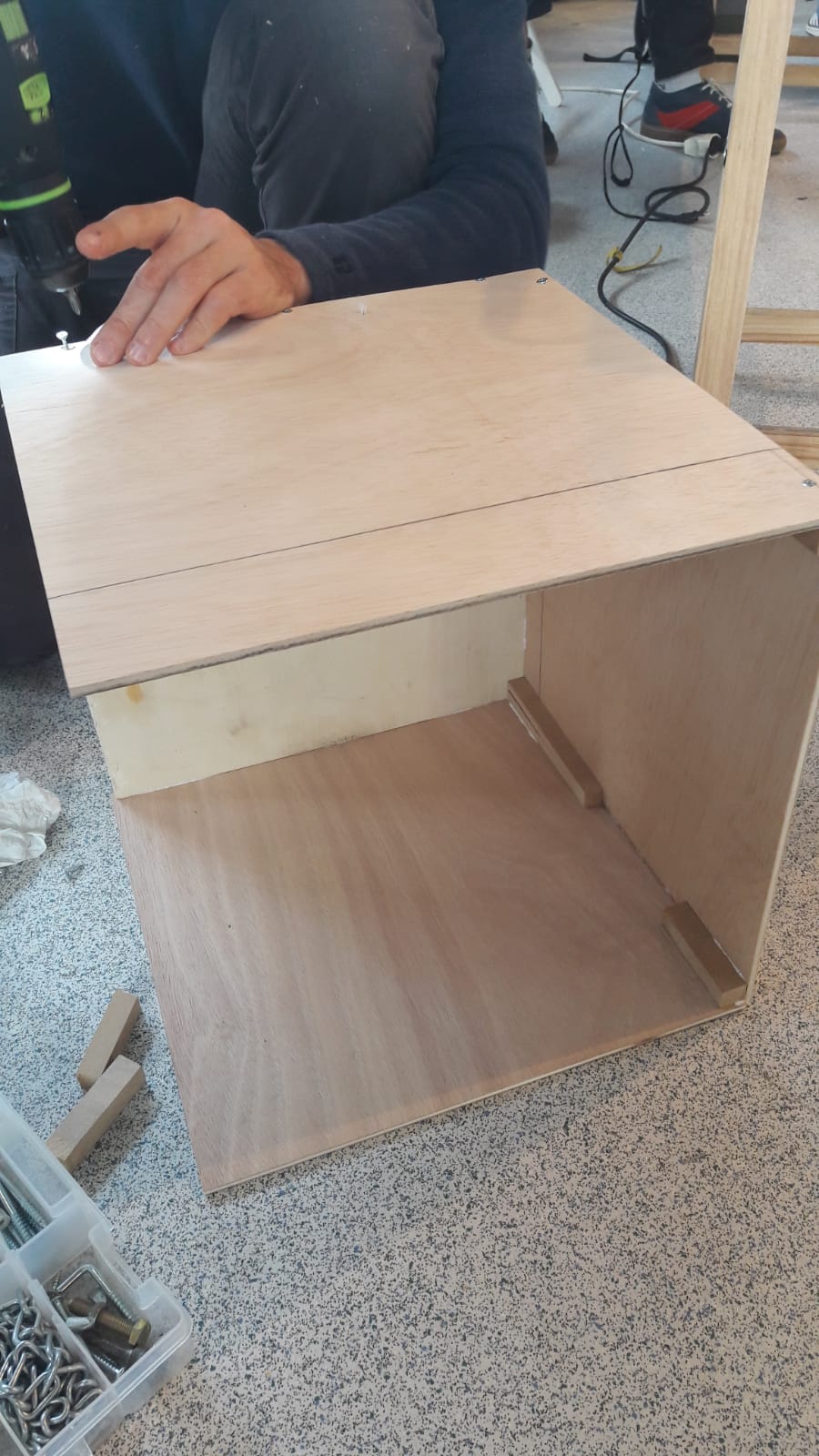

Step 1: Box Construction
-Wood planks 35x35 cm
-Wooden batten 2x2x8cm
Glue and screw each elements

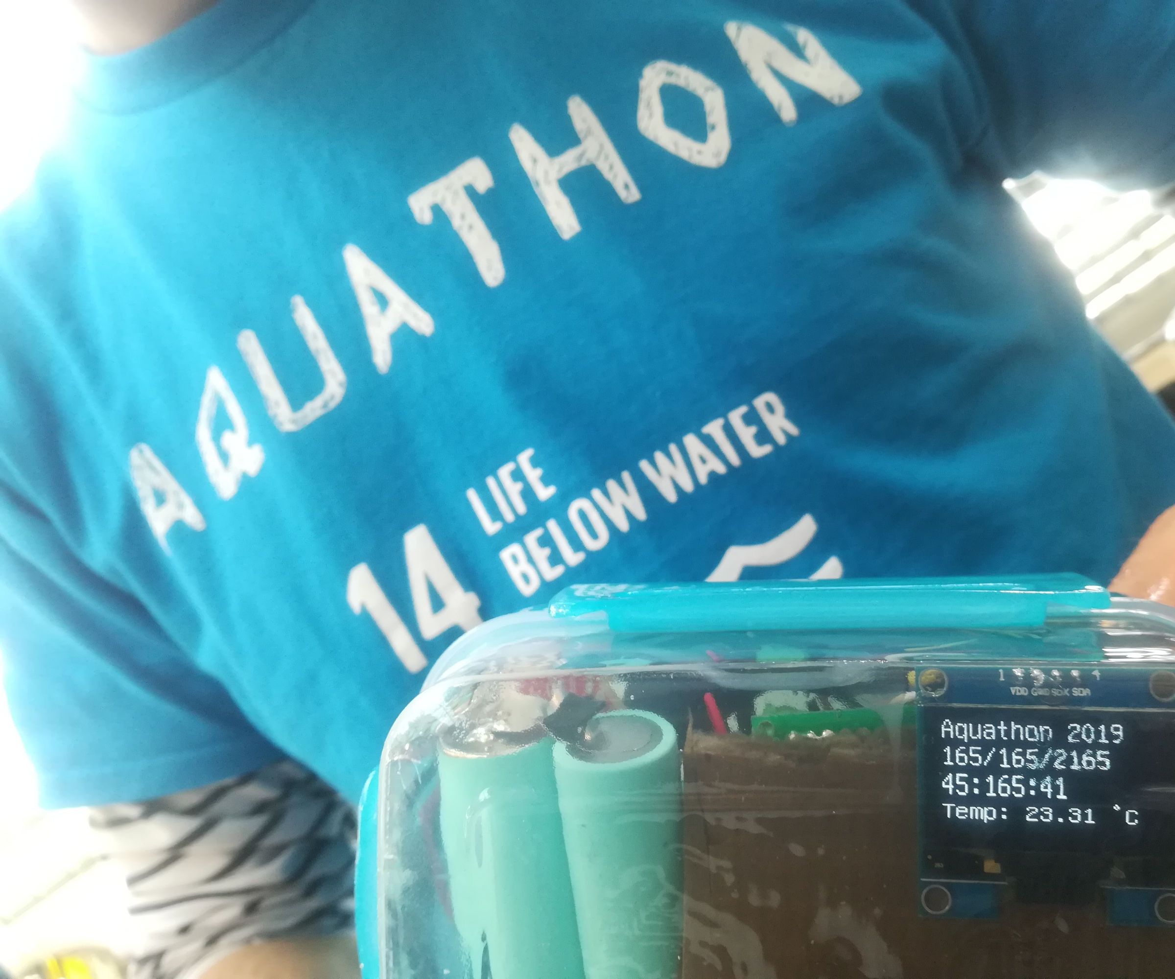

Step 3: Conception and Creation of the Measurement and Control Device
  • ESP32-Firebeetle
  • LED hot white
  • Photosensor TSL2561
  • Ecranoled 0,96"
  • Temperature probe DS18b20
  • SD card adaptator
  • Clock RTC DS3231
  • Servo motor sg90
  • boutons
  • electric water pump
  • 9V battery
  • power bank usb

This was a tricky part. At first we wanted to use a solenoid or a peristatic pump to control the amount of reagent added for each measurement. For time and money sparing we decided to use a medical droplet device instead.
The problem is that the amount of drops that will fall in the tank is dependant of the volume remaining of the tank of the dispenser.
When the arm (servo motor + stick + pipe) goes down it will make drops of reagent fall into the tank. The amount of drops is controlled by the scroll wheel on the medical device.
