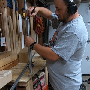

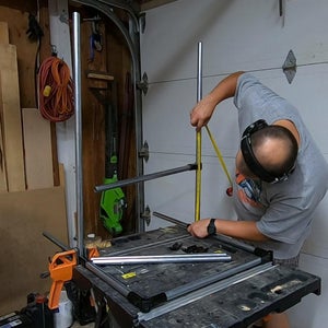

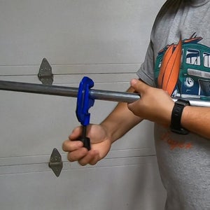

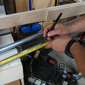

First I marked out the dimensions using a tape measure and sharpie marker. I used a pipe cutter to cut the conduit, but you can also use a hacksaw if you don't have a pipe cutter.
A time saving tip is to use the first piece you cut to mark off the subsequent pieces. This way you don't have to take out the tape measure every time.

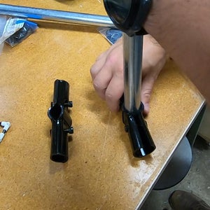

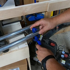

The Maker Pipe connectors are very simple. Two (or more) pieces go together using nuts and bolts (as seen in the first picture). The only thing to keep in mind is that the smaller diameter part of the nut needs to be slid into a connector for it to work properly.
To assemble the ladder frame I first started with the bottom T connection. The 34" piece is pointed upwards and two 14" pieces are attached on the side.
I made two of these assemblies.
I then connected them together using two 20" pieces. You can either use a 90 degree connector (as shown) or the simpler T - connector (from the first photo). This will form the base of the ladder.

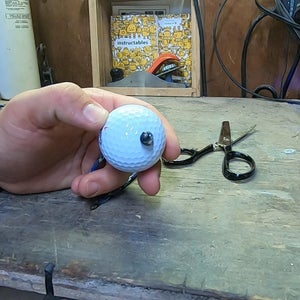

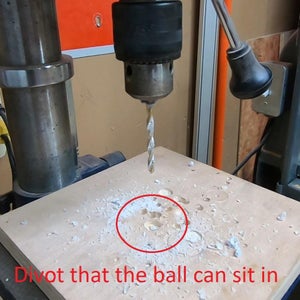

I had a piece of plywood with some holes already drilled in it. This made holding the golf ball even easier as I was able to rest the ball in one of the divot. I also used a clamp to hold the ball. Spheres are notorious for moving when you are trying to drill them so I didn't want my hands anywhere near the drill bit.
Using a 3/16" I drilled through the center of the golf ball. I ended up making 3 bolas, so I repeated this step for a total of 6 golf balls.

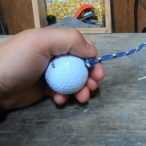

The bolas is pretty simple. It is two golf balls and some paracord (if you cut a piece 18" you will have more than enough). It is held together with 4 knots.

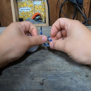

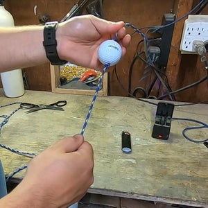

First need to thread some paracord through the hole in the golf ball. This can be a bit tricky, but I found that if I twisted the paracord as I pushed it that I would eventually get it through.
I then tied a stopper knot (knot #1) at one end. I used a figure 8 knot, but any stopper knot will work. I slid the ball up against the knot and then tied another knot (knot #2) as tight as I could against the ball. The captures the ball at one end of the bolas.

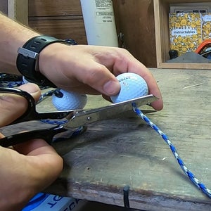

Next I tied the 3rd knot 12" away from knot #2.
I then slid the second golf ball onto the paracord and tied the final knot, thus capturing the second golf ball.
Finally I cut off any excess and melted the end of the paracord with a lighter. I always use my fingers to smooth out the melted paracord, but make sure to wet them first!
